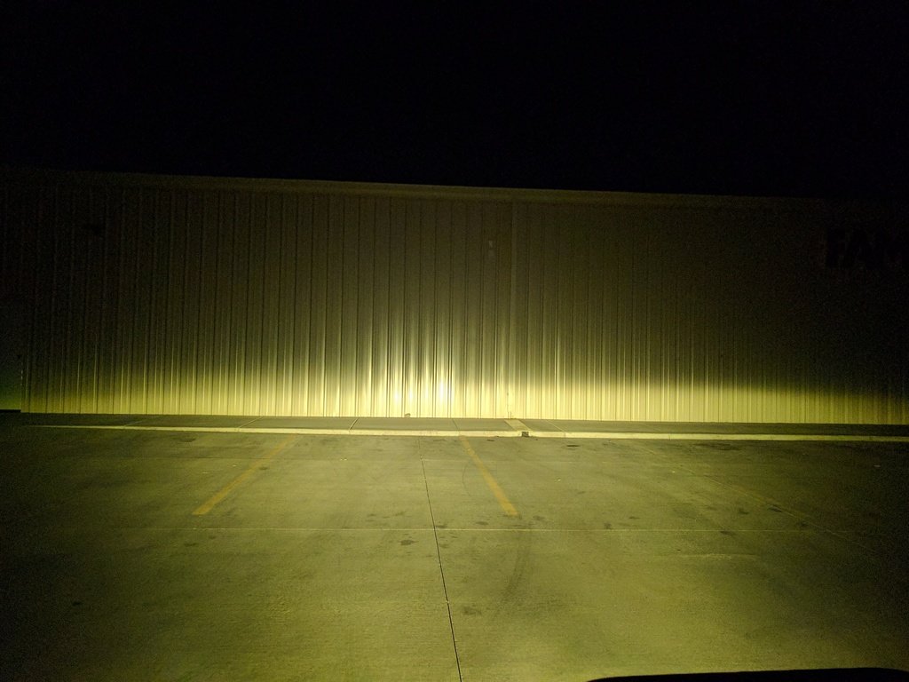

    Well if you can make them work I would go with Koito projector fog lights from a Lexus. Cheap H3 bulbs with good output and cutoff. I have a custom bumper so I don't need them to fit the stock location but if you could make them work... $25 at your local picknpull. I haven't adjusted the cutoff yet but as you can see at about 30+ft the beam is great and the coverage is pretty wide.
