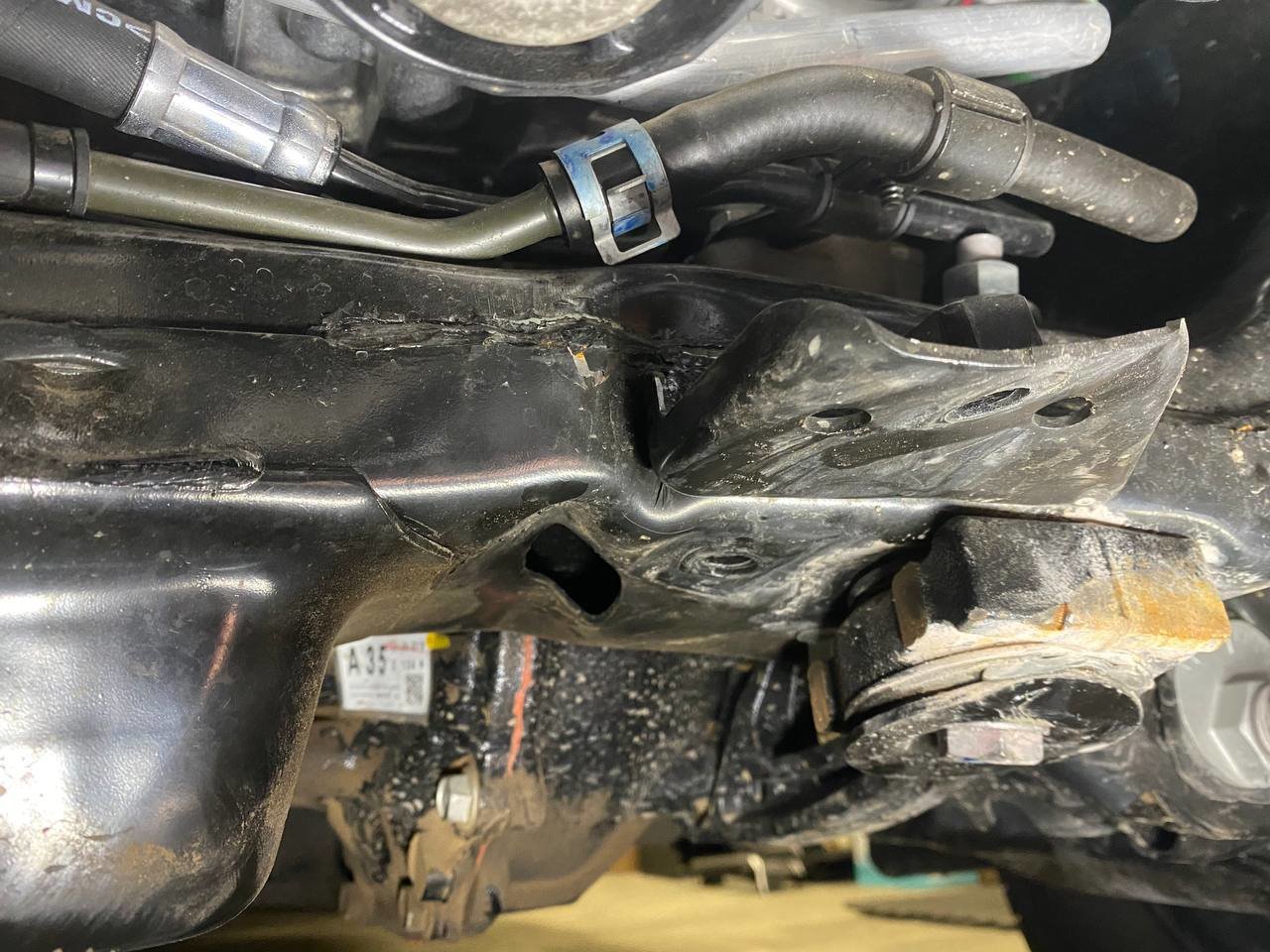

    Hello All, new here. I purchased a new 2021 3rd gen tacoma limited nightshade truck this past summer, only 1,6xx miles at the time of accident. Ran over a big ladder on the freeway, could not swerve would have caused more damage.
    Long story short, the truck took most of the impact on the skid plate, issue is that right under is the mount for the diff, punctured the steel skid plate and shifted the crossmember by a few inches (see picture).
    now the question: Is the crossmember replaceable? it does how one of the lower control arm connection points. Whole frame replacement? ideas? advice?

    Welcome to the forum. Toyota uses high strength steel for their frames and opinions vary about repairs on them. I’m not an expert by any means but generally speaking a frame with that much damage would be replaced rather than repaired. I’m sure some repair guys on here will have a better answer for you soon.

    Looks like that diff mount is bent, too.
    16xx miles and a salvage title?

    Hard call to make from just pictures .
    Worst case front frame splice .
    see if the frame can be pulled go from there.

    Whole new frame is the safest and best way for this. Here in WI, any salvaged/totaled vehicle needs to have safety inspection, before back on to road. Plus can possibly have title cleared, with full frame replacement.

    With an almost new truck a frame swap wouldn't be too bad of a job, no rusty fasteners and worn out parts to fight with. As an added bonus you could do a really good job rustproofing the new frame without the rest of the truck in the way. (I like Cosmoline)
    Might be a long wait to get the new frame however.

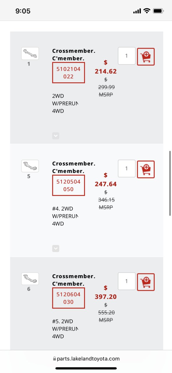

    Those parts are available separately for crash repairs. Someone here posted the parts diagram a while back. I’ll see if I can dig it up.

    Hey welcome to the forum. SORRY for your trouble.. Let me understand this, your saying your ins co has totaled this truck for that damage ? NO WAY !!! I have been a tech for 40 years and do a lot of coll shop repairs on frames, susp etc etc.. I cant not understand why this new truck could not be fixed, UNLESS something else is wrong, did the air bags deploy ? NO body damage ?? IF NO, I would be all over the ins company telling them you want a new front frame cross-member [CRADLE] section if it is bolted together, if not you want a new frame no ifs ands or butts. Take your truck to a certified collision and shop have them do complete check on the damage, this way you have something to back you up. The frame replacement is not as bad as people think. Being a NEW truck it would be easy to do... THIS my friend is bulls..... !!! good luck, let us know how this ends up.

    Thats what I was questioning, is it safe to do a frame splice? especially since that crossmember is where the lower control arm connects to. seems like everyone tries to pull the frame. I am contemplating on a new frame, but there are non available. Dealer eta 6 months or so.

    People close to you can give you a better idea but the physical splice might be as far back as the front cab mount. Well past the suspension attachments in a straight section of the frame.
    The thing with new Trucks the lead time for parts !
    I don`t know enough without doing some research are the 2018/19 frames the same you might be able to snag one of them.
    A new frame is the best option pulling the frame if it can be done . last would be a frame splice off a used vehicle.
