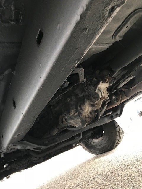

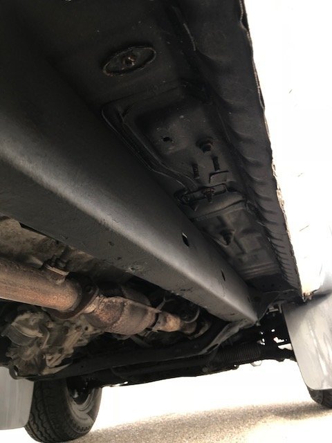

    So, found a low mileage 2002 tacoma, dealer says frame was replaced but has no proof, its not on the carfax either. dealer said they announced that the frame was replaced at the auction. checking the vin on the recall list it say it has no recalls, if the frame recall was completed would it show as a completed recall on the toyota recall site? or no recall at all.
    The frame has an under coat, came from new jersey where they salt roads, spots look like the rust may be just covered with under coat i will post pictures to see what you guys think.

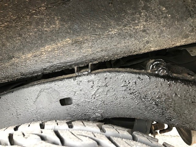

    What I have learned in the other thread is that it is not a recall. That does not look like a new frame to me but a painted/coated one and it looks like they painted over the rust.

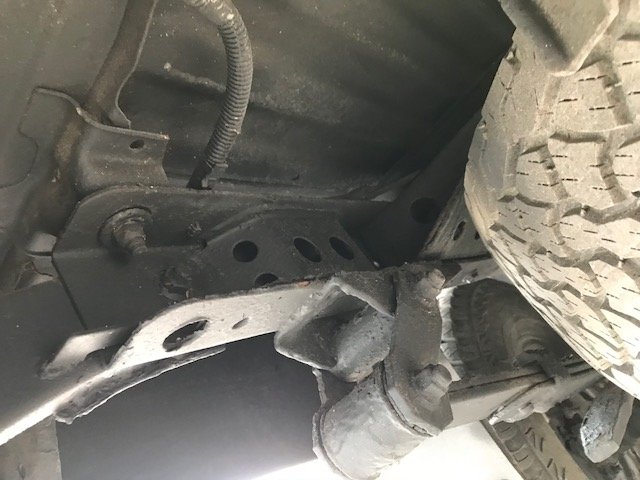

    Looks like a good cover up to me. The pic of the shackles definitely look like there is something under that coating. Because it appears to be "bubbling" under the coat of paint. My Carfax report on my truck showed that in 2010 it was coated by a Toyota Dealer, so it not showing anything about it on the Carfax is definitely suspect. My advice is to Run...

    Nah, just walk away. It def looks like the sprayed a thick coat on there to protect it but best stick a camera inside the frame to see how it really looks.

    There is no road grime on that frame. If it were from 2014, it would surely show some ware. You can also see that they sprayed over whatever grime and rust was on the frame.
    The frame may be "sound", but they have to be examined from the inside out. They typically rust from the inside of the boxed in sections, but other area's are susceptible too. I never saw the rust on my '01 frame until the dealer pointed it out during an inspection. The frame was paper thin in the rear by the leaf spring hangers. Fortunately, I was under the extended warranty and the frame was replaced.

    Hard to tell from this few pictures, but the texture underneath does indeed look weird
    Try to look for things such as rusty bolts, skidplates, cab sheet metal.
    These frames rust from the inside out, so it may look ok from the outside (especially when painted over like this) when they are in fact paper thin
    If you can, shine a flashlight through the square holes on the frame rails and have a look.
    Also, try to poke a finger or something in there. If there is rust flakes and chunks, not a good sign
    Then the fact there is no proof and records of the frame having been replaced is suspicious as well
