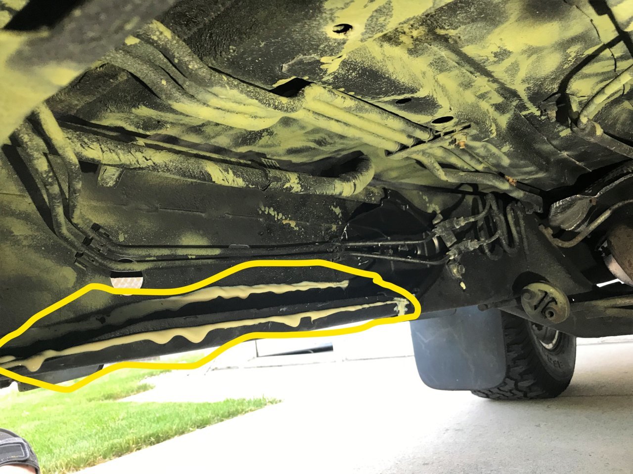

    I live in the midwest so I spent several hundred dollars coating by truck's underbody when I bought it new and washed my truck's frames at least twice a month during the winter months. I was hoping Toyota would do a better job at coating my frames front to rear but boy I need to lower my expectation. This must be a 10 minutes job putting bandage on a problem.

    I'd guess the bolts are plugging access holes they drilled to get up into the boxed area. That seepage you are seeing is in the sandwiched area of the frame. I suppose it'll drip for a few weeks, but it should be covered now!

    Yikes! My fluid film treatment looks a thousand times better! And it only took me about 15 minutes

    That 10 min job should last 12 years.
    All good my friend.

    Those are not seepages from within the frame. They appeared to have been applied by a caulk gun just to cover the surface. LOL. I could've done a much better job than that. LOL

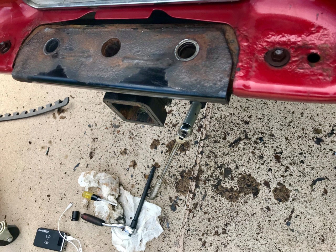

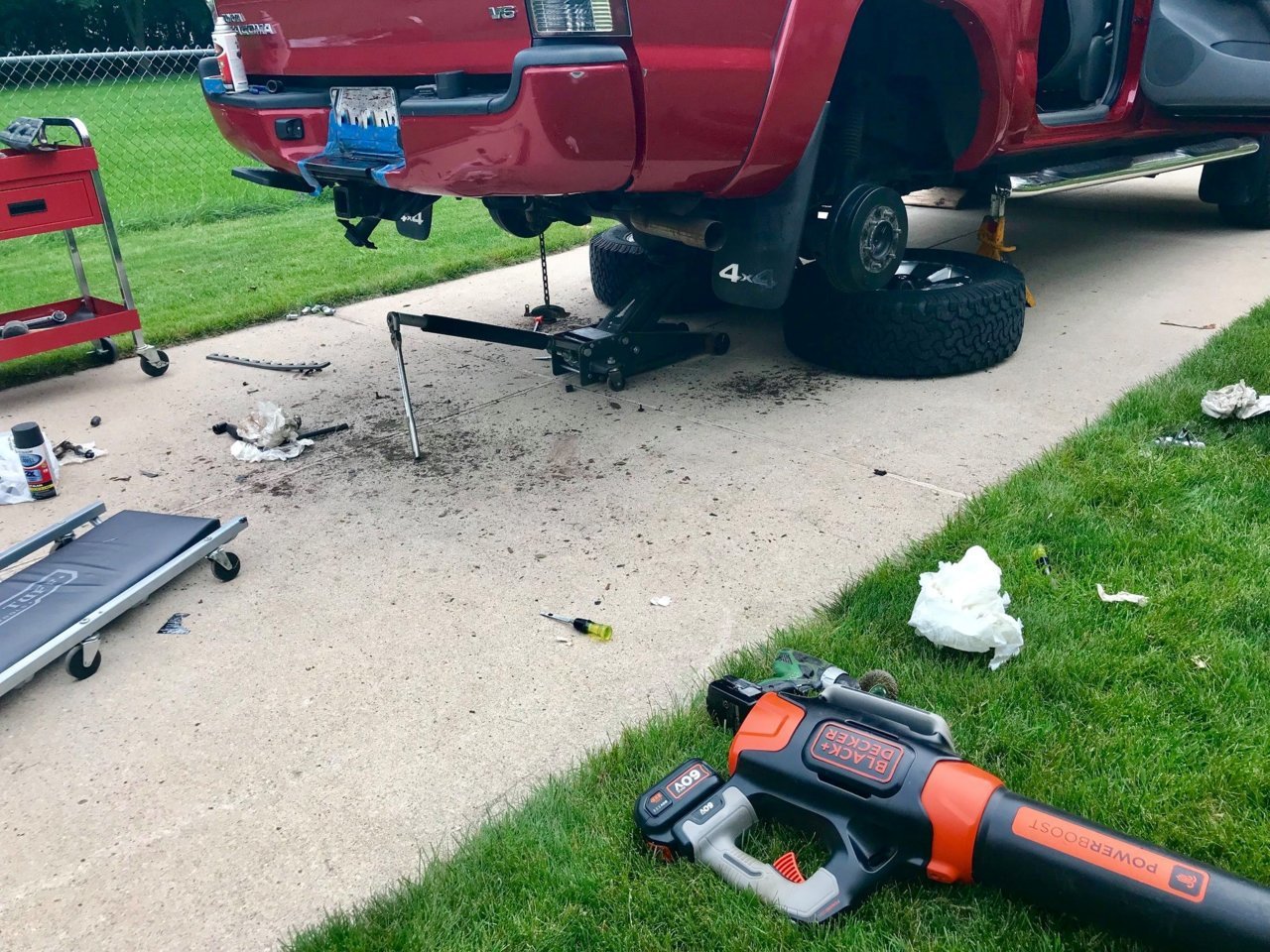

    I had to do whatever it takes as a responsible owner. :) Taco.jpg

    Is it OK to put a floor jack under the pumpkin like that? I honestly don't know, just curious.

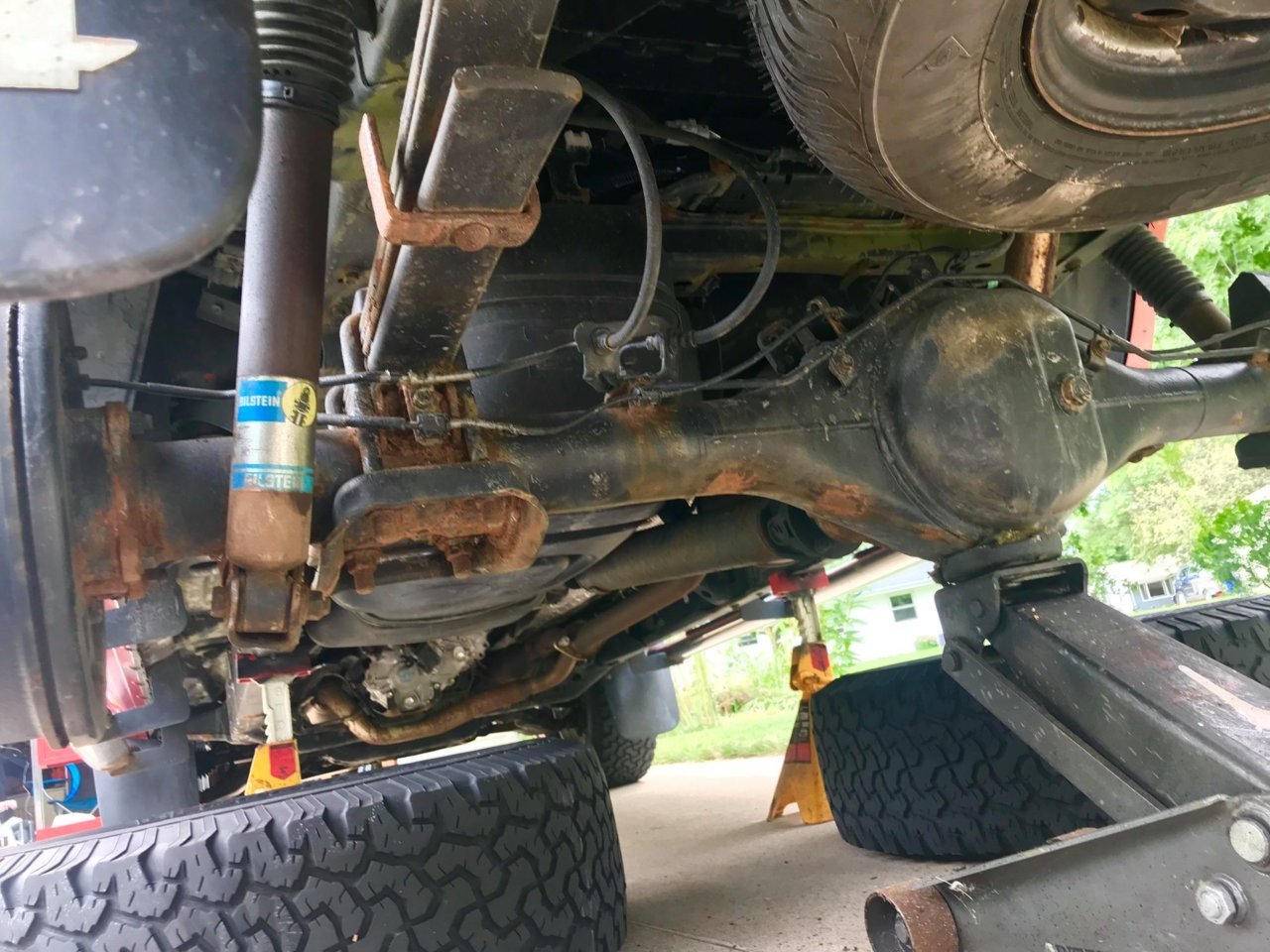

    I just got four 6-ton jack stands to jack the truck up and do a full, intensive frame restoration effort myself. Not getting anywhere near that factory provided CRC. Needle scaler, wire wheel, metal prep, POR-15, POR-15 top coat,... good to go. It'll probably be on the stands for 2-3 days. Anyone know a solid method (or have a good product) for introducing rust inhibitor to the inside of tubular framing?
