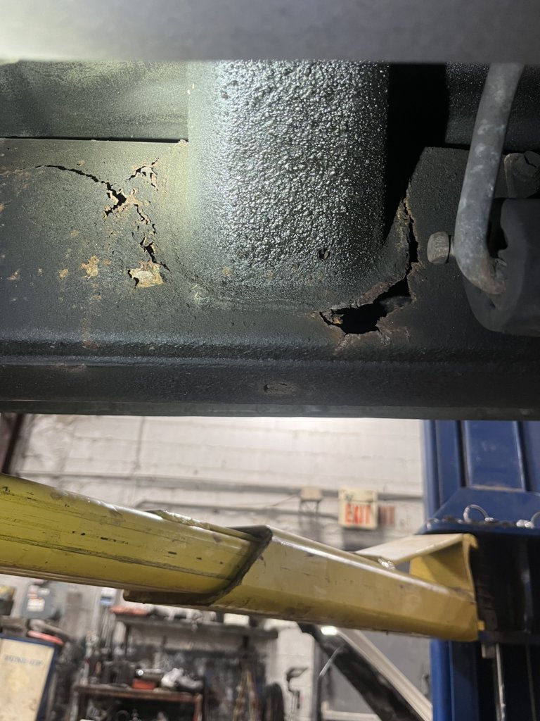

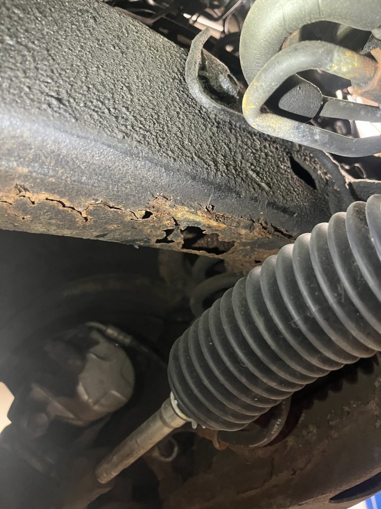

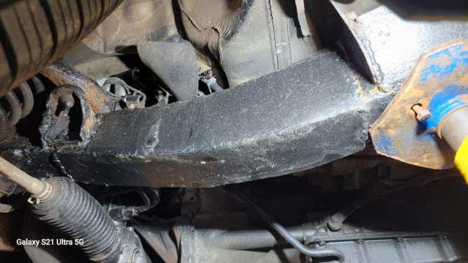

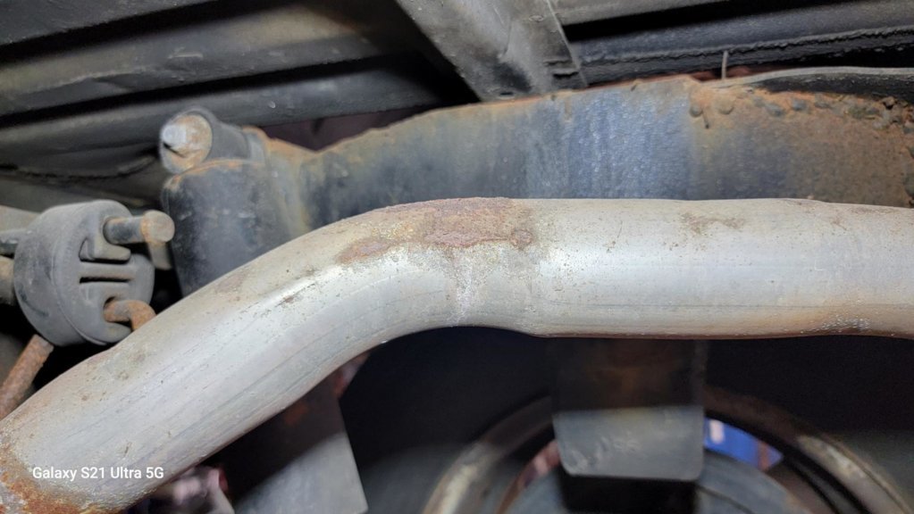

    Hey I don’t have any pics of the whole frame but here are two pics I took last time my mechanic had it up on the lift of two problem areas that I should probably take to get reinforced. I think the rest of the frame looks in decent shape but I’d like to see what people’s opinion is. I probably won’t be able to get those for a little while since I’m not gonna ask my mechanic to put it on the lift just to take photos. Or maybe I’ll see if I can get some photos from underneath.

    Nick, that damage looks more extensive than I thought it was going to be, especially by the exhaust/cat hanger.
    You said your frame mechanic guy has a good plan to reinforce that and make it structurally sound?

    hey, yeah that area in particular did give me reason for concern. the rest of the frame is in better shape than that, but those two spots caused me some concern. i just dropped it off with my mechanic and he seems to think he can fix it no problem. hoping it doesn’t cost a pretty penny

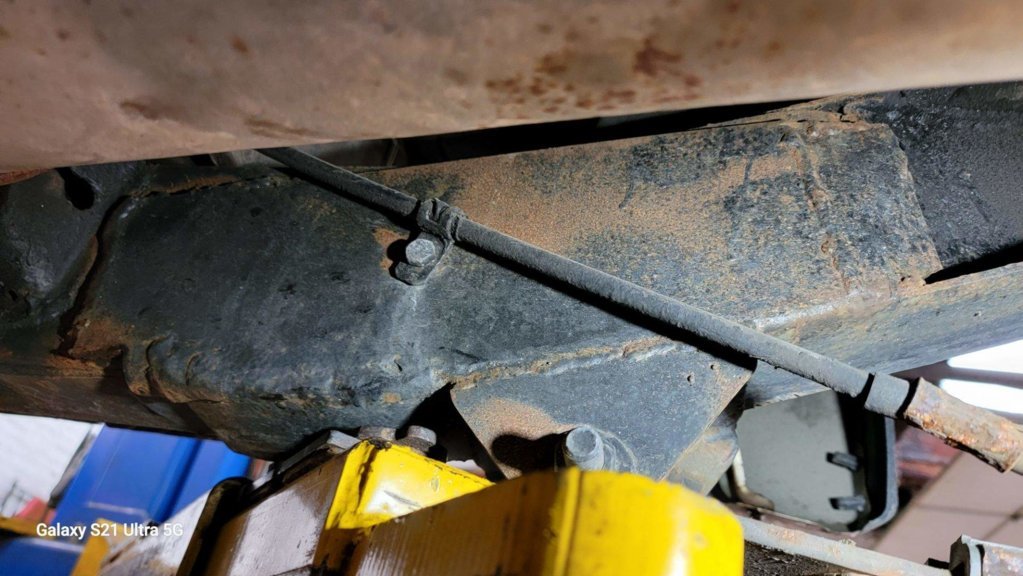

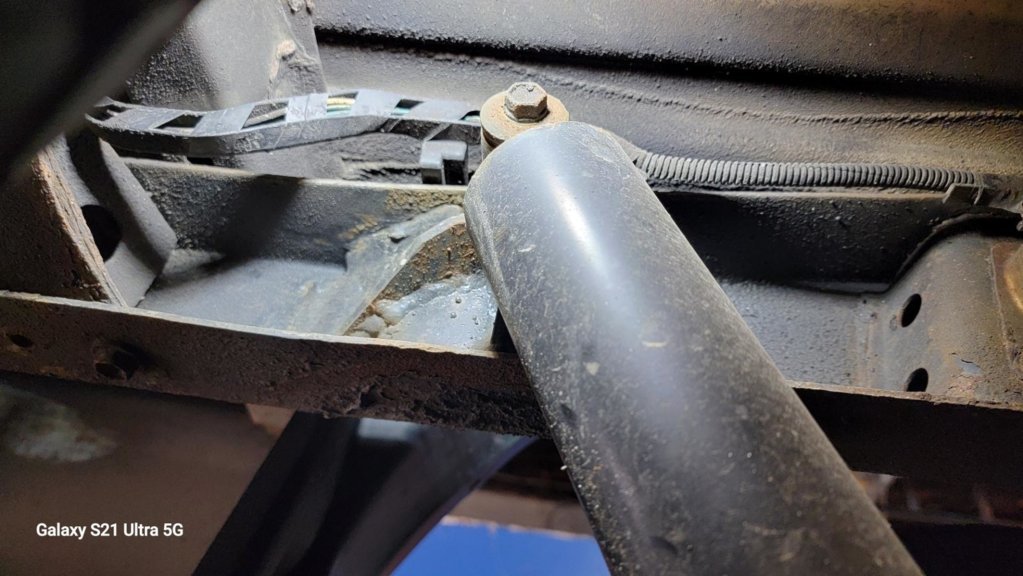

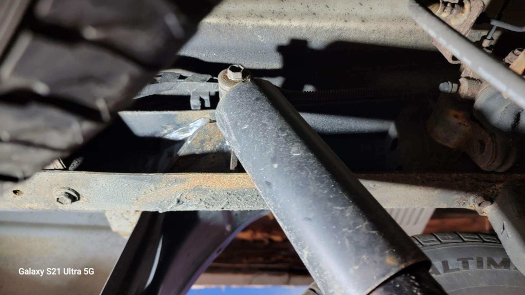

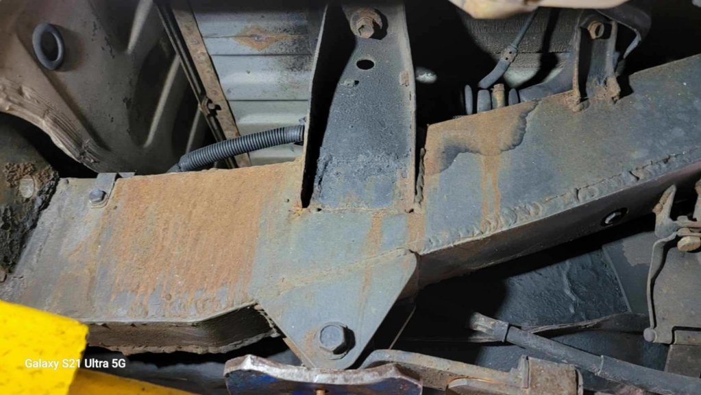

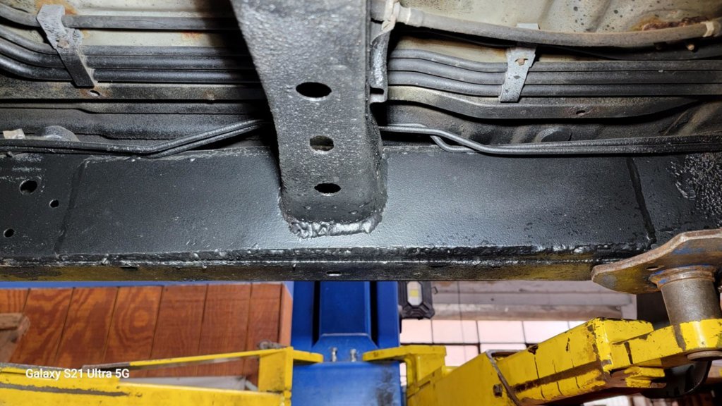

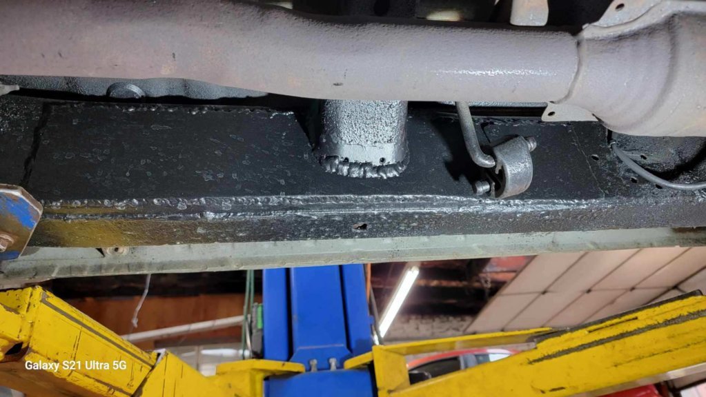

    Hey, I was finally able to get it up on a lift after my welder mechanic worked on it. Here's a good set of pics showing the condition of the frame. Let me know what you think!

    Repairs look good. Pull the bed off, sand blast or wire brush it, then POR-15 the frame, then finally Fluid Film the inside and outside the frame seasonly. But be prepared to see big rust damage when you pull off the bed. Traditionally these frames rust above the rear tire often from the inside of the frame.

    The recent repairs your guy did look good. And if you can’t tell, there are other areas patched by previous owners. The only thing this frame needs is a thick coating of oil (fluid film etc) and routine checks to make sure things aren’t getting worse. There’s no value in painting it. There’s rust everywhere inside and outside that frame.
    You can easily do the undercoating yourself. I’ve done it a few times rolling around on the ground underneath the truck. Not ideal but cheaper than hiring someone. Probably more difficult on a five lug, ramps would be helpful.
    Buy a gallon of fluid film and one of these sprayers, hook up to an air compressor and it shouldn’t take more than 30 minutes up an hour to soak everything. Get the inside of the frame where you can.
