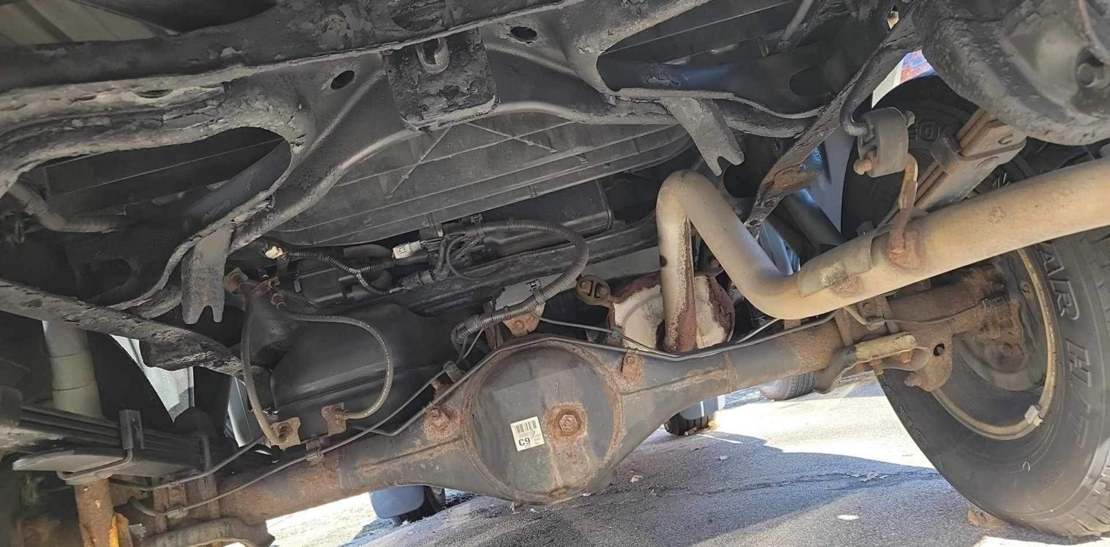

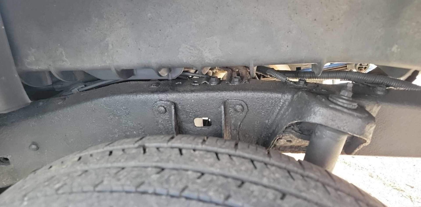

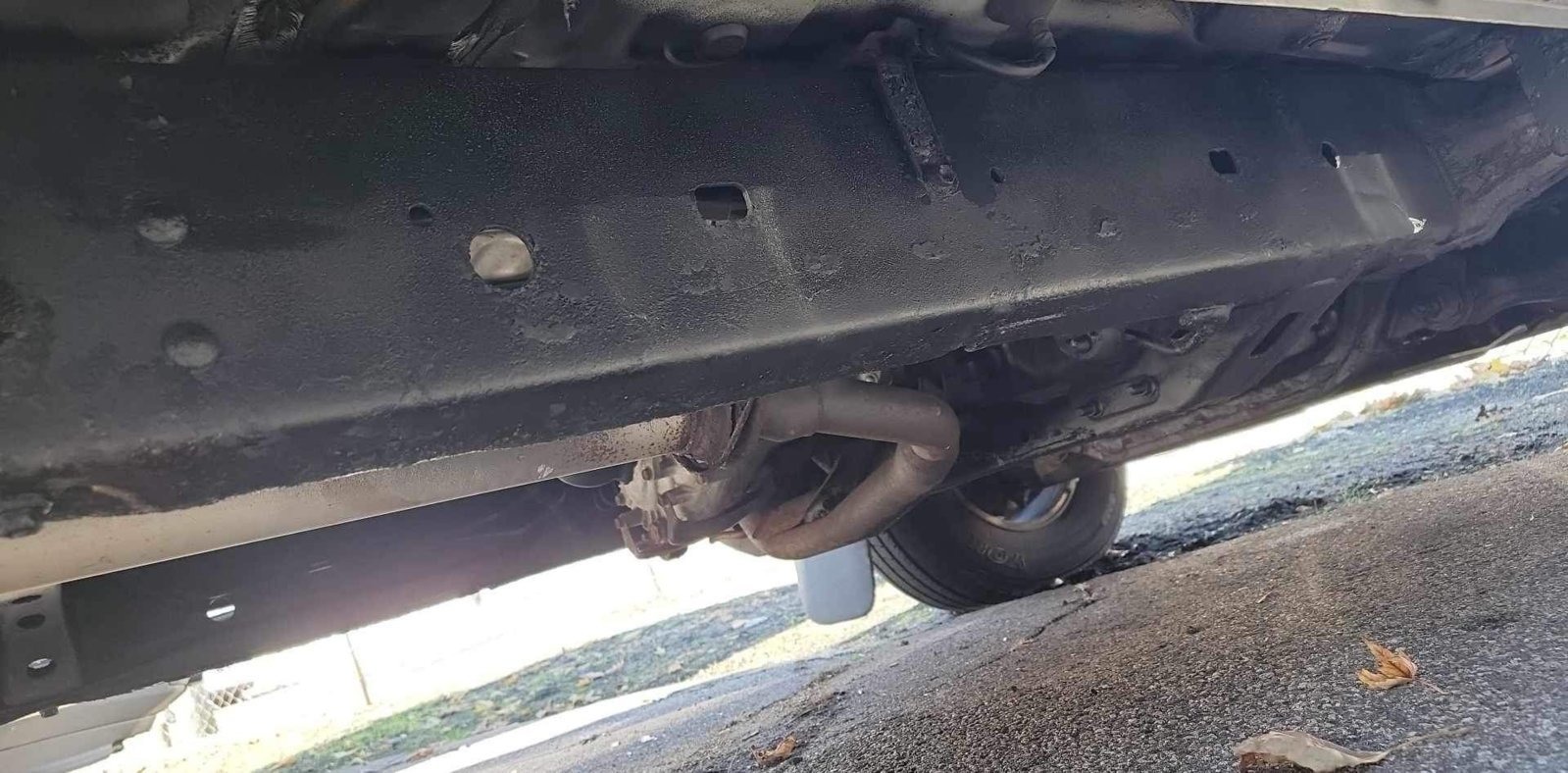

    Recently I’ve been looking at used Tacomas on marketplace. I have some pictures of a frame on one of the Tacomas, can anyone tell me if it looks to be in ok condition?

    Looks like someone tried painting over rust.

    So the rust doesn't look that bad, it's still early. but the fact that someone painted over it to try and hide it, instead of you know, removing it, or fluid filming the vehicle would make me
    1. Not trust the person.
    2. Doubt that all the appropriate maintenance was done to the vehicle at the right intervals.
    3. Suspect there would be other underlying issues.
    4. Not want to do business with someone trying to make me a fool.
    5. Do you really want to do the work to actually stop the rust from spreading under your paint on a vehicle you JUST bought?
    Check what it's worth on KBB. If he isn't selling it for at least 5k under that price, no go. It's not going to be a good truck for the money, unless it's significantly cheaper than other trucks you find that are being sold at their actual value.

    That's a no from me dawg. Look at the big chunks flaking off at the rear upper shock mount. Also looking at that cab mount I guarantee you there's a hole in that. Same spot my 2009 developed a hole.

    Scaly rust is bad, and this one is just covered up

    Pass on that. It’s been painted to look okay.

    They didn’t care for it until it was time to sell

    No way, that pic from the rear shows the left side is a mess with paint over it.

    Steer clear of that tar pit less ye be a dinosaur
