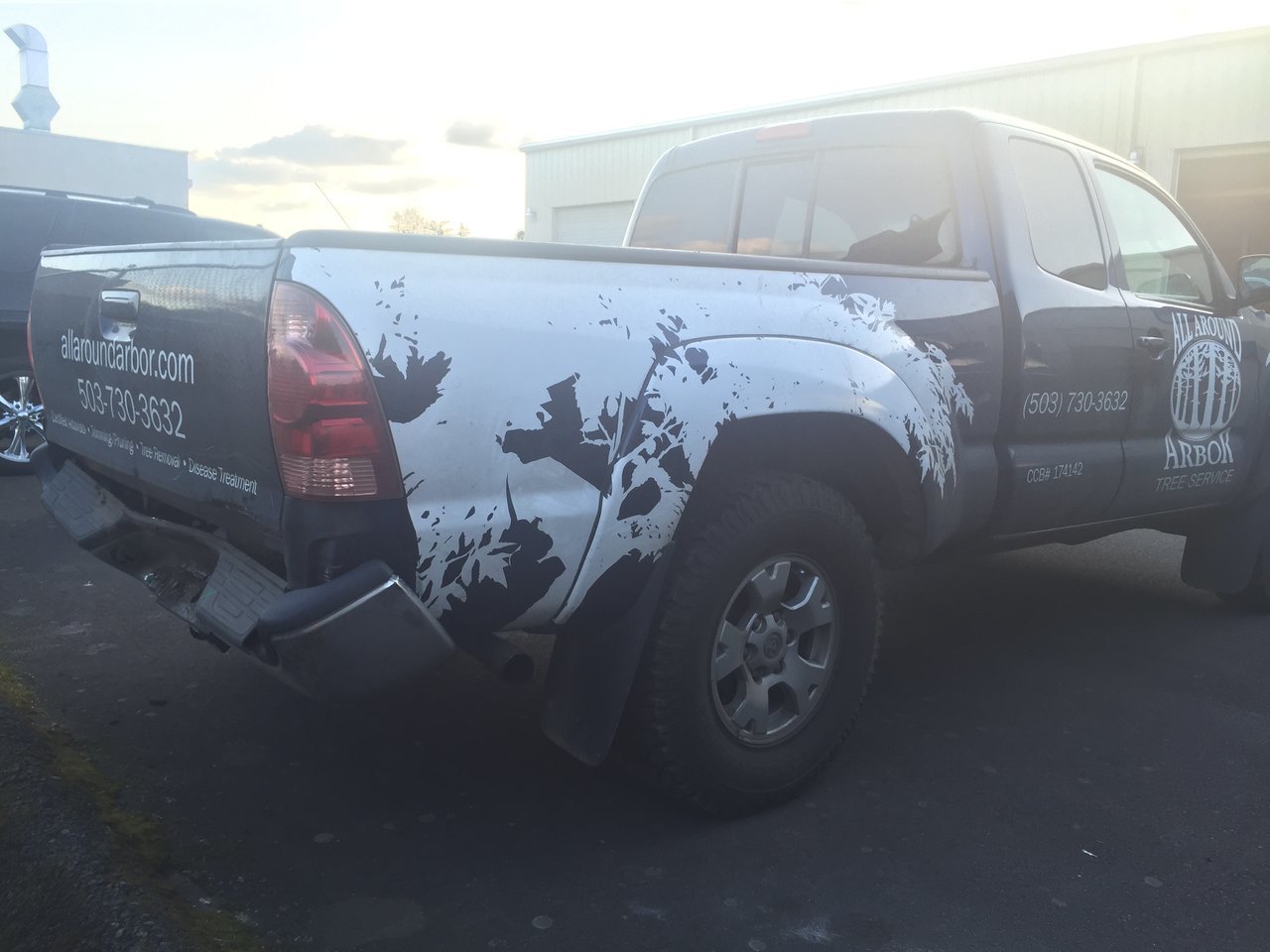

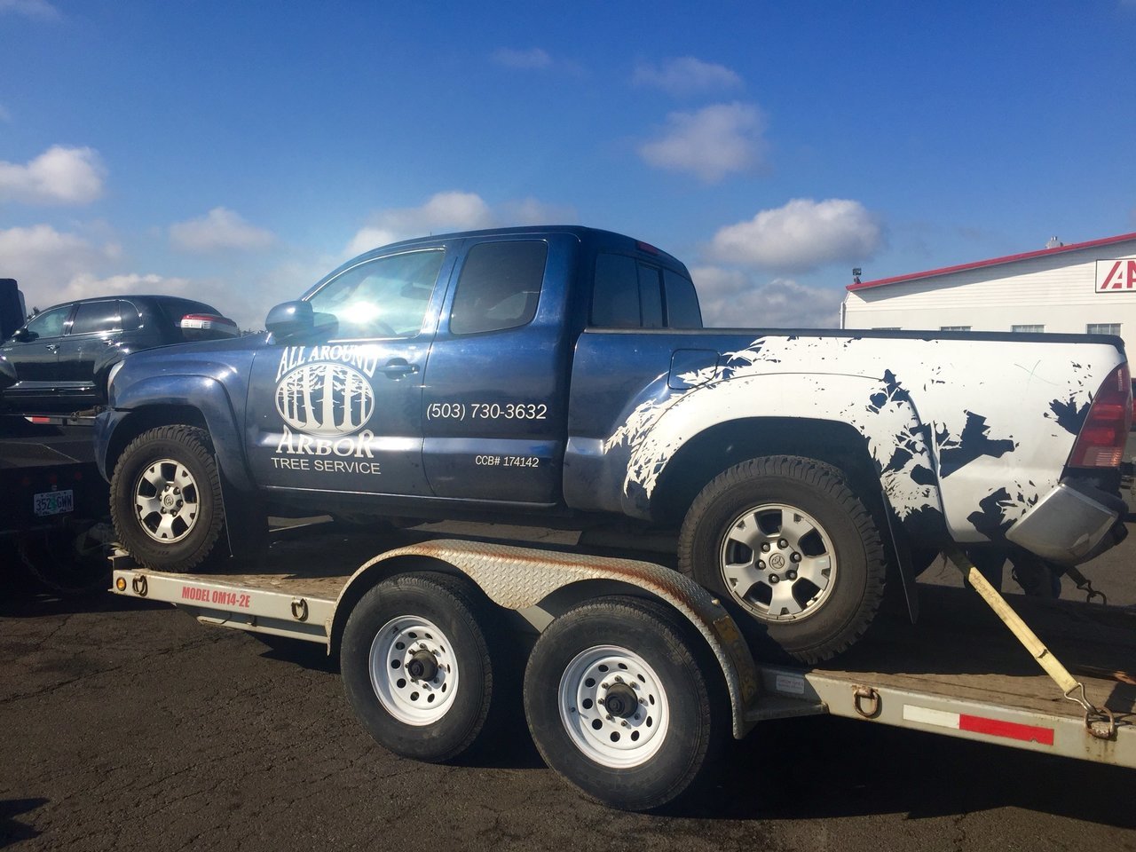

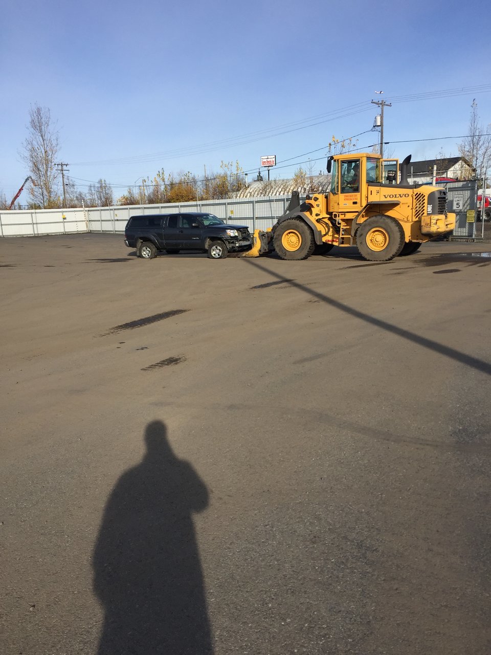

    The arrival..March 2015
    A 2005 TRD off-road 6-speed

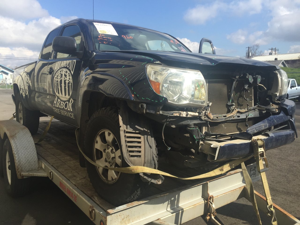

    Took a chance and bought it off an online auction without looking at it in person first....no big deal, “it will buff out” :rofl:After further inspection it was decided that the truck took a decent impact in the front while towing a pretty heavy trailer. But those were only guesses. Either way there was lots of work ahead of us, that was certain. On the up side when we were looking at pictures while bidding we thought the sides of the bed had chipping paint and they had described the transmission as “missing reverse” but upon arrival we realized there was lots of vinyl stickers (way better than paint failing) and the shift knob was so wore down you couldn’t see the shift pattern so whoever jumped in the rig to write details didn’t know where reverse was. So those two key factors saved me lots of time and $$$ right from the beginning. :thumbsup:

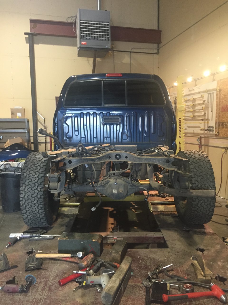

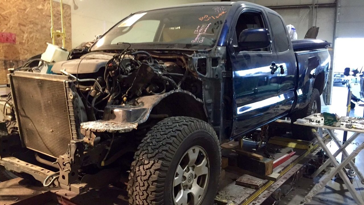

    So we got her on the frame rack and started stripping her down.
    After further inspection I found that this was its second resurrection! Found that the core support was halfway sheet metal screwed on and there was just tons of bad hidden repairs all over. So the job continued to grow. Oh and did I mention that the inside cab was like sawdust pile? Being a retired arborist truck it took me a half of a day vacuuming it out Haha.

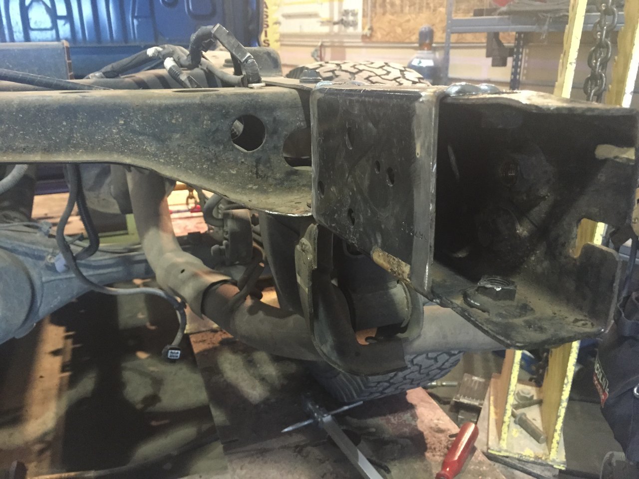

    After we pulled the front rails around a little we had to take the bed off and pull on the rear rails. It had split the right rail so we decided to add some extra strength to both sides.
    Before
    After

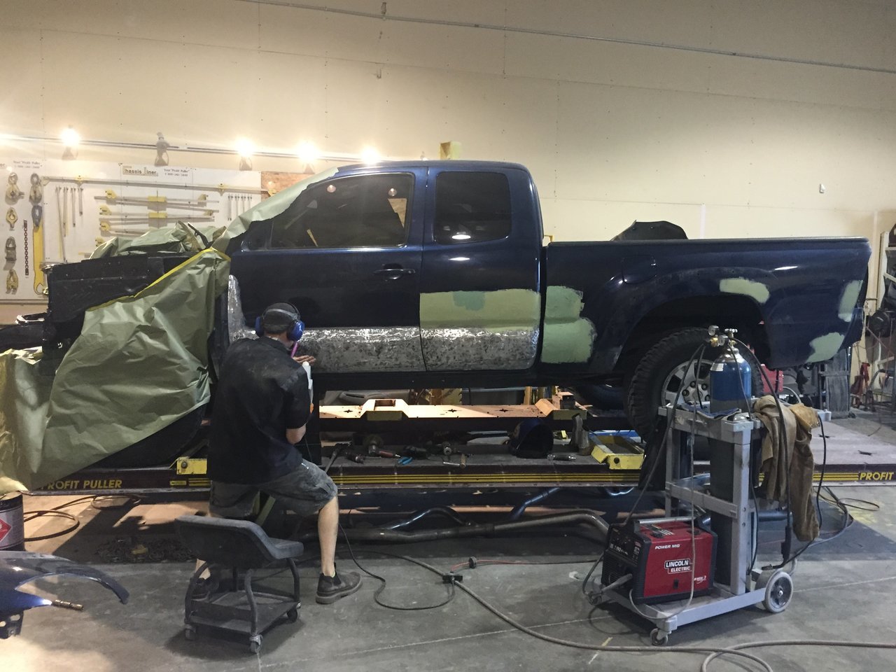

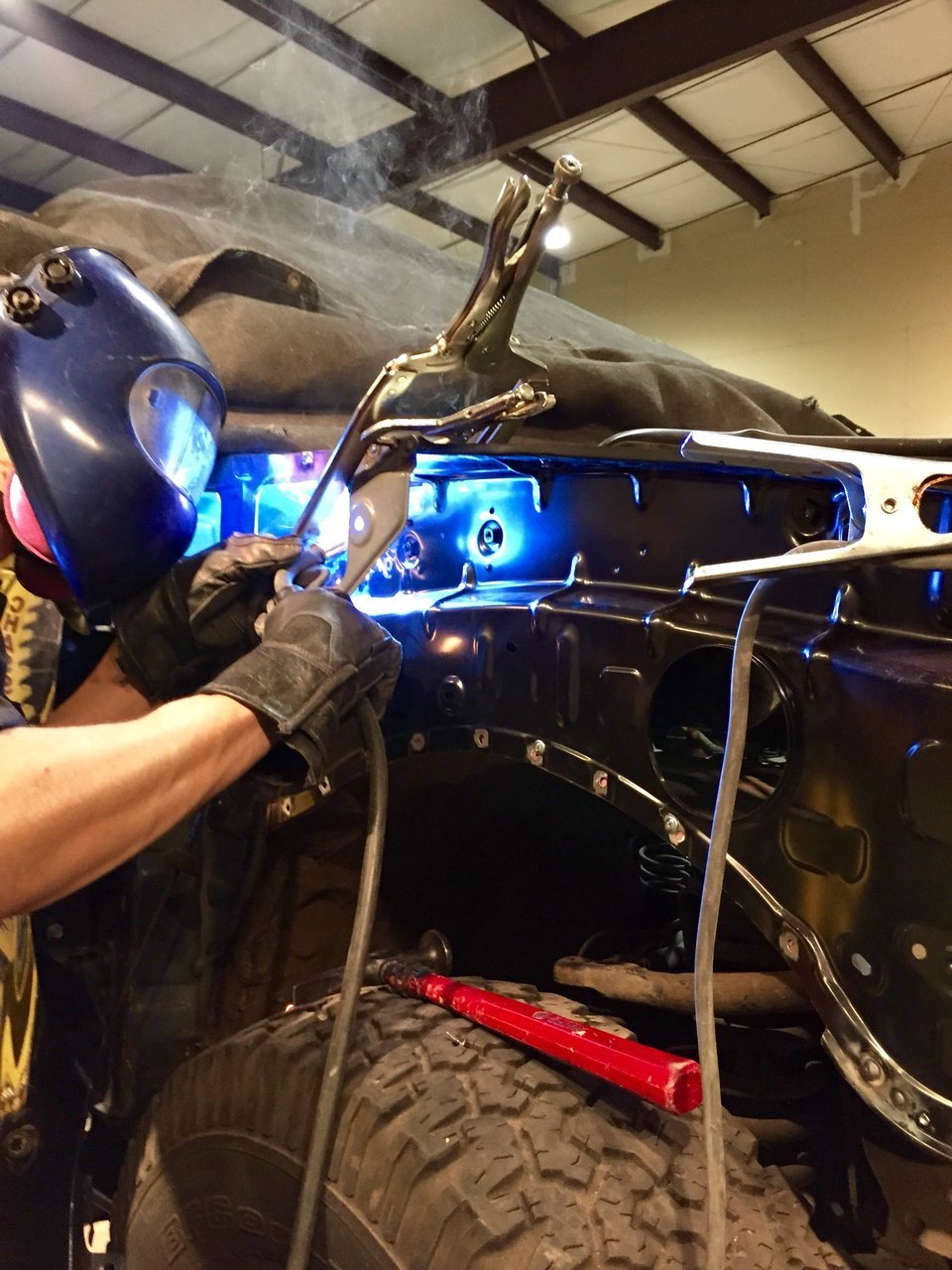

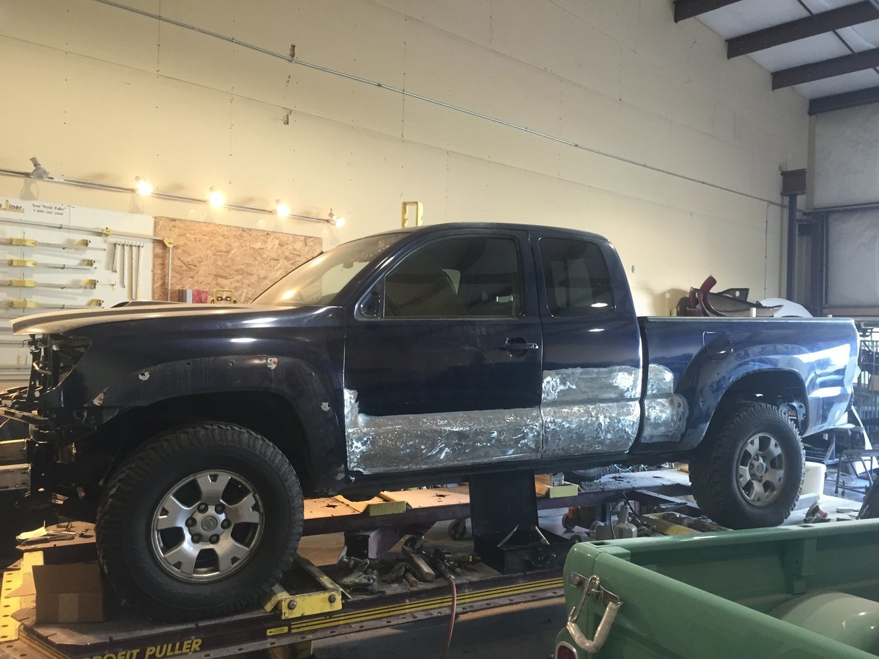

    My brother in law, who I owe BIG time for helping me through this mayhem, decided to strip all the bondo from the original repairs on the left side of the truck back down to weld up every hole and rework the metal for a better quality job. Thanks Max!!
    That was after we welded in new aprons..
    At one time this was a WELL used work truck so there was damage all over. Then the choice came over me, to either fix the obvious damages or to go an extra mile.....or five, to just go the whole way and fix every dent I could find and paint the fucker complete! With this being my first Tacoma and first build without supervision of my Dad I quickly decided to just go all out! I mean, why not!? :headbang:

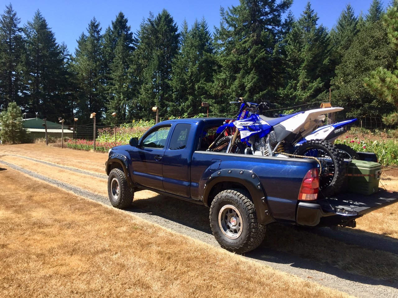

    Is the last picture how she's currently sitting?
  5. Dec 19, 2017 at 11:23 AM
    ATOMZ
    ATOMZ [OP] Well-Known Member
    May 31, 2015
    #156484
    151
    Adam
    Cascadia
    2005 Tacoma TRD off-road
    A 2005 rebuilder with a 2015 facelift.
    Nope. That was from 2015. She’s currently sitting about like this..E4171499-000C-4FA1-BD07-21B729BD578E.jpg
    Well that was from August haha summer time.
