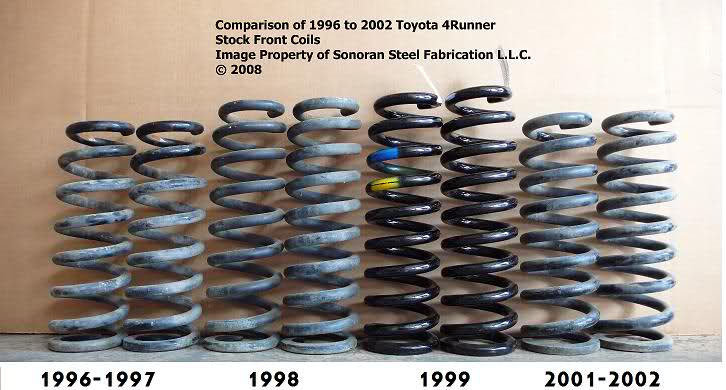

    first off, I've been trying with no luck to find this info. Is there a difference in front springs for the 95-04 tacomas? I know the 99 4Runner coils are tallest for the runners but can't find info for the tacos. I've got an 01 ext cab Trd with 3.4/auto. Some where along the lines some one replaced the front shocks and springs with crap from orielys and now it sags. I do have a set of 99 runner coils I can throw on if they offer lift.

    Toyota made at least 12 different coils for the 1st gen Taco, as many as 16. There once was a list of the part #'s on TTORA, now gone. Way way back it was semi popular for the standard cab 4cyl folks to install V6 extra cab springs to gain around an inch of lift. These days you can just buy what you need from folks like OME, Eibach etc.
    I'm guessing you have seen this pic of the 4Skinner coil line up.

    Ya I've seen that pic and have 2 sets of 99 coils in my garage but don't want to waste the time installing them if it won't make a difference in ride height
