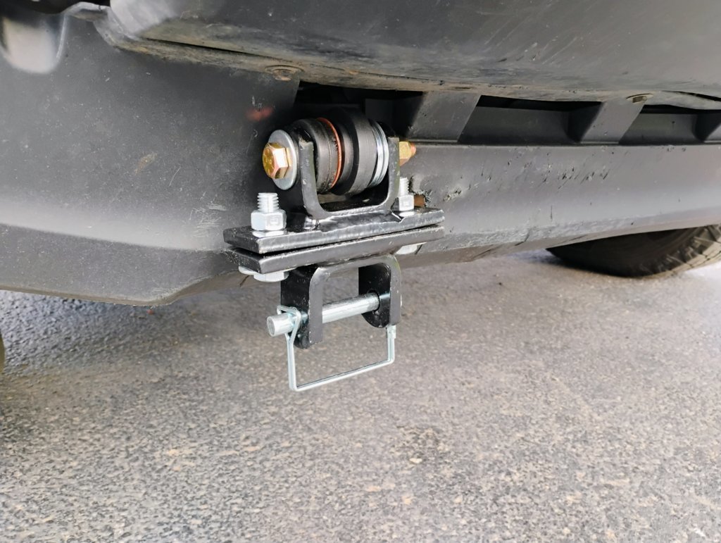

    After digging out 96 t100 out a ravine and seeing what a winch and heavy duty come along can do, I decided I needed a set up.

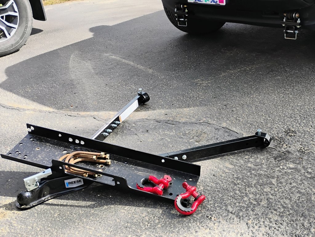

    For the front receiver tube I am trying to use after market tow points that are made for D rings but adding tow stuff to attach a receiver tube to and then use a winch in a cradle with stinger. The A frame of the tow gear will be temporary and removable.

    Passenger side

    Bilstein 6112 front / 5100 rear (extended) shocks, Headstrong AAL, Firestone airbags, 4.88 gears, OME Carrier bearing drop kit, Aluminum 1/4" skids (engine to transfer). Custom sliders (1.75" HREW tube w/ 3/16" base plates). Custom front bumper and high clearance rear bumper (1/4" steel plate, 1.75" tube.) Apex 5500 winch w/synthetic line (36lbs) and required accessories for an underpowered winch (snatch blocks and extra line.) Tekonsha P3 brake controller, remote start, any-time-backup camera w/ front facing camera, Leer 100R shell (w/e-track single slot tie-down mounts for removable Yakima EasyTop.) Cat shields by CaliRaised. Husky liners, window tint, heated seat (passenger only.) Relentless bed rail brackets with QuickFists (shovel/axe/fire extinguisher.) Hondo Garage Un-holey vent mount. Anytime rear with front facing camera. Billet front seat risers. Viair 88p. 265/75r16 Goodyear Ultra-terrain tires.
    My opinion is you're just adding a bunch of failure points as opposed to using a D-ring.

    I want to put a receiver tube on the A frame and put my winch cradle in it. We chained the winch to the same area to get the t100 out. I want something better, hopefully.
    First is this set up as a winch recovery point for a winch cradle to plug in to. Not built yet. Not wanting to tow this vehicle...but you never know.

    Ah, you want to use the truck as a toad (tow behind another vehicle) not just have a recovery point? It needs to be much more robust.

    Looking for ideas to add a temporary, removal recovery point to the front on my Tacoma, as I don't want to add permanent weight, yet.

    I want to be able to move my winch from back to front using the cradle.
