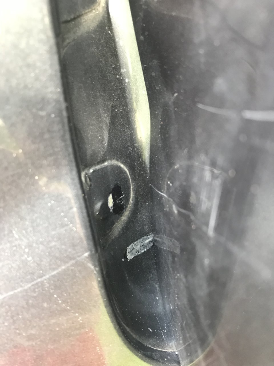

    I'm getting ready to do this as well, but have also lost the plastic nub that the door latches on. Does anyone have the part number for this nub? Circled in red for reference:
  8. Oct 24, 2018 at 10:58 AM
    #28
    busy13b
    busy13b Well-Known Member
    Dec 31, 2015
    #173608
    74
    Omaha, NE
    2005 Speedway Blue TDR Sport Access Cab
    It looks like the "nub" or "knob" is actually part of the "Pipe Shield" - part number: 77290-04040
    Anyone know if there is a separate part number for the nub?
