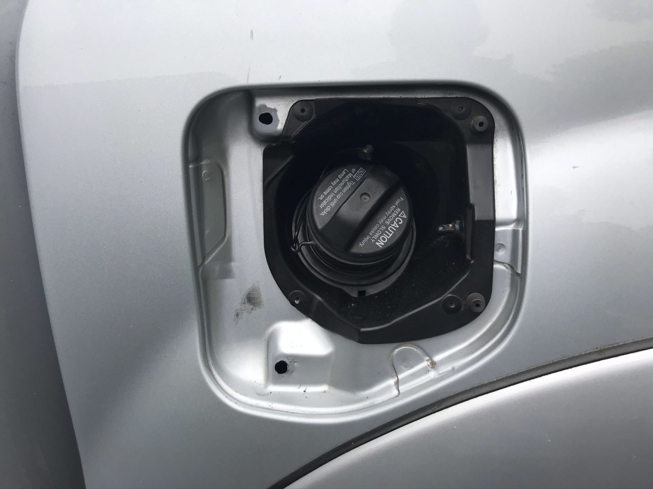

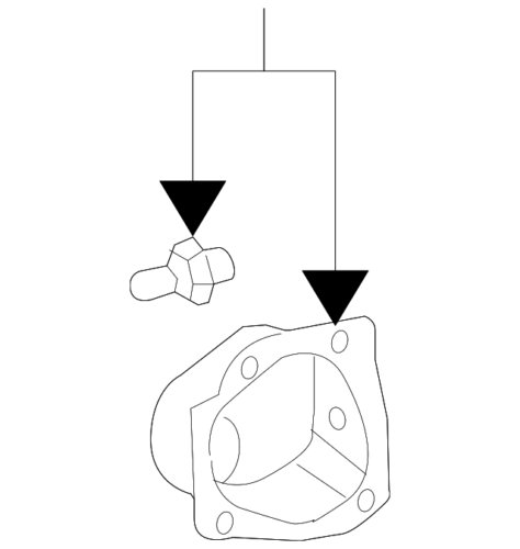

    Does anyone know the part number for the clamp on the door itself that latches around the 'nub'? It's on the left side of this image. My door is somewhere on the side of the interstate and pretty sure the new door won't include this.
    EDIT - Not the nub that is circled here in red, but the latch that engages the nub
    Is it
    77367-35010 ?

    BTW - That paint looks great!

    Yes, I had to buy the entire pipe shield to get the little nub since mine was missing too. I tried to just take the new nub and put it on the old pipe shield but the thing wont stay in the old shield. So I will have to replace the whole pipe shield with the new one I go. Anyone know how to remove the pipe shield?
    Also, make sure you get the right fuel door.
    77305-04904 is for the short bed.
    77305-04905 is for the long (regular) bed.

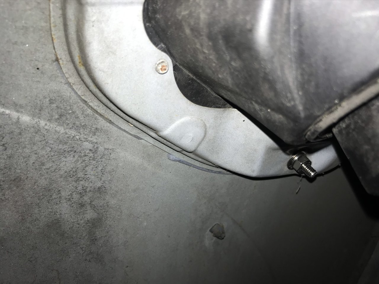

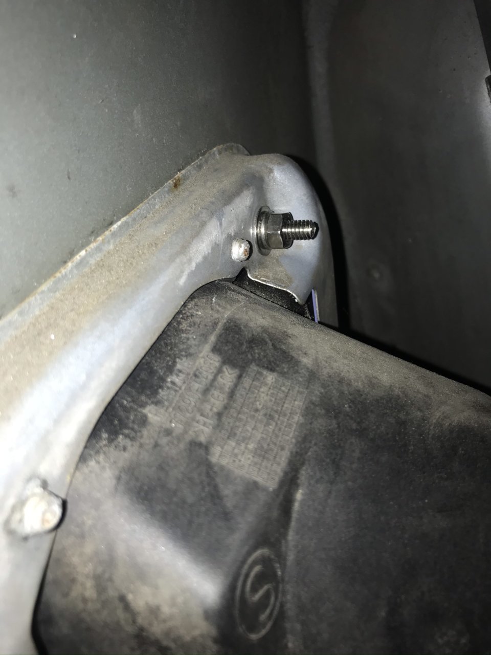

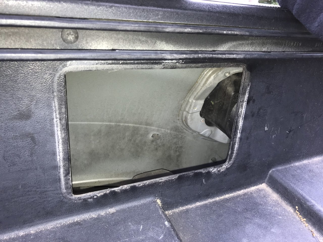

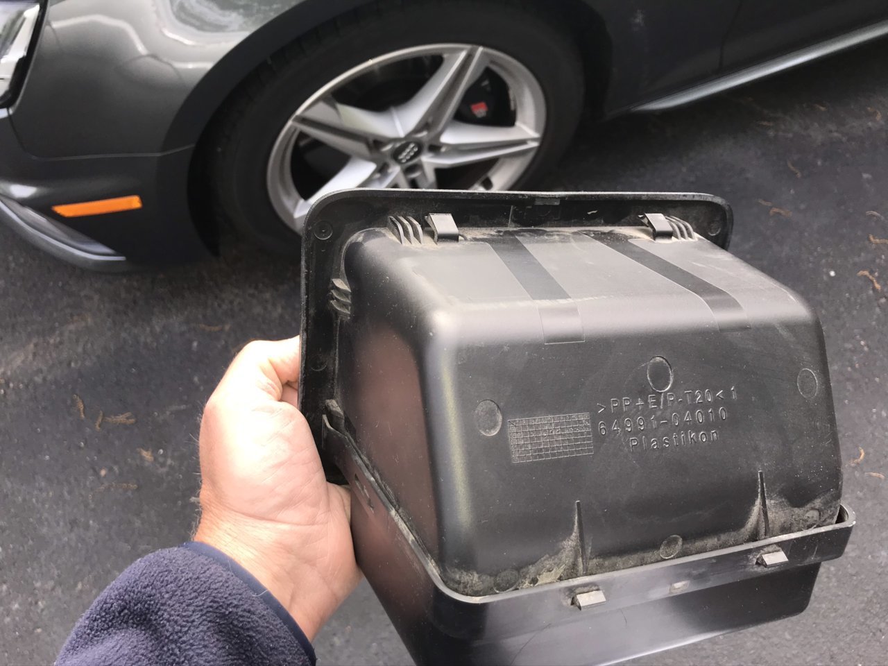

    Thanks to those who originated and contributed to this thread. Very useful. Just completed mine so I figured I would add a few pics and some info. I installed using 1/4-20 stainless screws with washers, lockwashers and hex nuts. Getting to the back side was fine to get a small ratchet back there and snug things up. When you order the door definitely order the latching clamp that is mounted to the door as well. From your local hardware store a new short 6mm screw to mount it to the door. For the paint I ordered the primer, base coat and clearcoat from automotivetouchup and it worked out well. Here's some pics including a pic of the bedliner cubby so you can see the clips.
