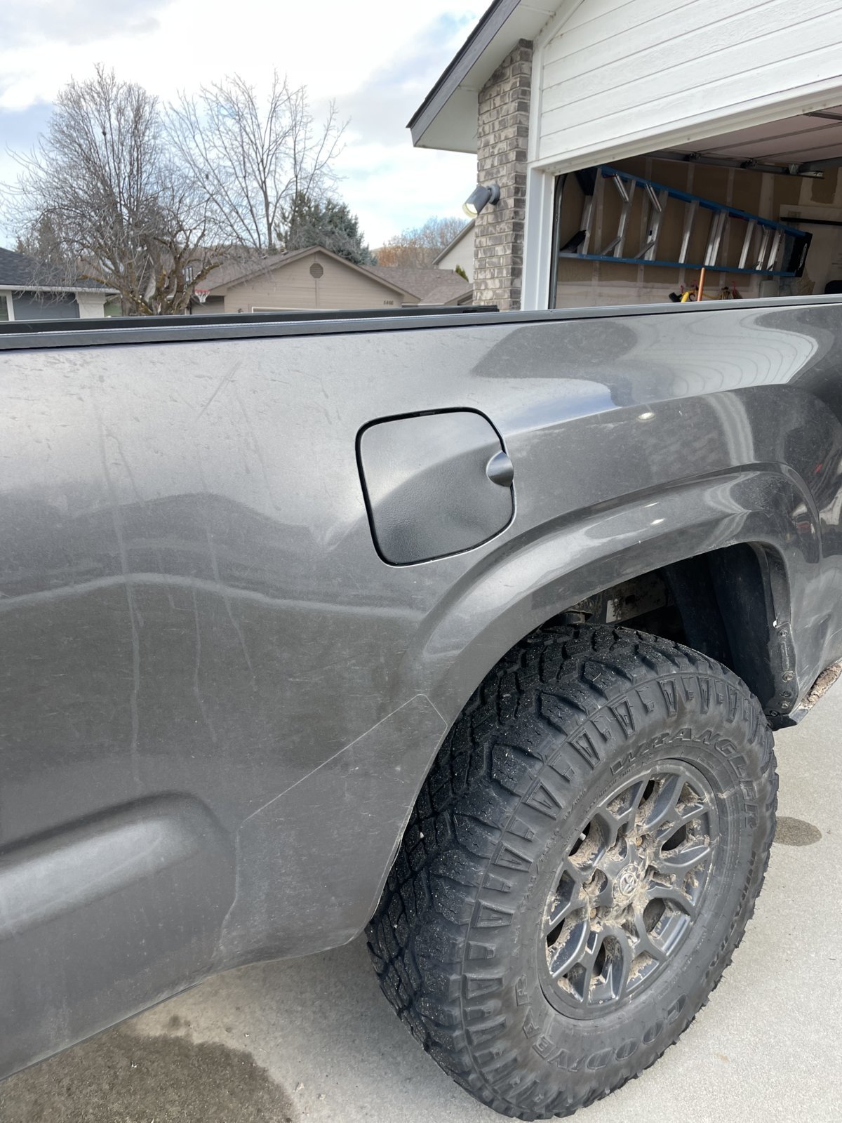

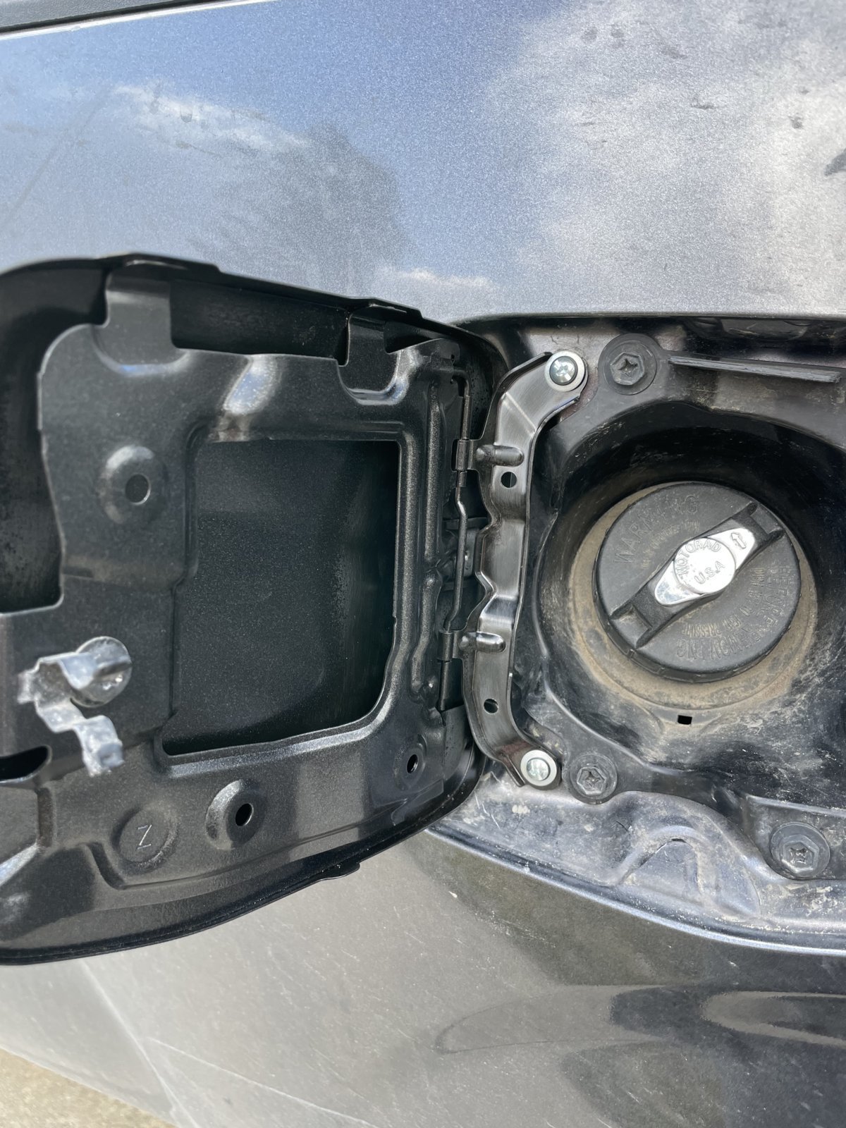

    I’ve got all the parts, everything painted ready to go…and man I’m having a hell of a time drilling out these rivets. Am I missing something? Do I need some special bit? Feels a bit like I’m mutilating the truck
  12. Mar 3, 2024 at 3:29 PM
    #92
    2009Access4x4
    2009Access4x4 Well-Known Member
    Oct 17, 2017
    #233261
    461
    Shane
    2009 Silver 4x4 access cab 6cyl
    All I can say is really go as slow as you can with it. Take your time and make sure you’re using the best size drill bit for the job, otherwise you’ll do what I did and overdrill them. Then you won’t be able to find a rivet that will fit it. Just take your time and do it slow and it will work fine.
    Malvolio likes this.
  13. Mar 3, 2024 at 4:20 PM
    #93
    cjc208
    cjc208 Well-Known Member
    Oct 28, 2019
    #309273
    103
    CJ
    Boise, ID
    2017 Tacoma SR Access Cab 2.7l 5speed 4WD
    265/75/16 goodyear duratrac, 16" sr5 anthracite wheels CBI Baja Front bumper / skid plate
    Finally got er - I had to get some different drill bits I was popping them off like match sticks lol. Thanks for all your help.
    color and finish are….close? Ish? Haha hope she evens out with some sunlight. This was way overdue though
