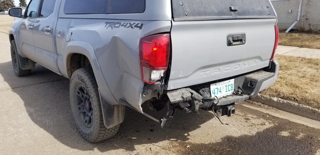

    Your principle point of contact looks to be the tailgate, pretty highly unlikely that there's much IF any frame damage, if anything request from insurance and the body shop(s) to quote some frame-time to measure and/or pull the frame to reassure that there isn't any frame damage.
    I went through the same thing this spring. Driver "fell asleep" at the wheel, my truck was parked in front of my house, parking brake on, at 10pm, woke me up in the basement. Pushed my truck 8-10 feet.
    Little Ford Escort, doing roughly 50-60km/h (20-30mph) hit my truck square center on the frame horn, as in: bumper met bumper, framer horn then blew through a/c condensor, radiator and had enough ford to break an engine mount or two and push it into the firewall of her car.
    Same idea, front of box, hammered rear of cab. Now with mine it did break the driver, rear leaf spring mount free from the cab (and I stood pretty firmly about the rear diff getting inspected too, no damage but checked for lash and play)
    All the repair work was about $15k Canadian, so $7k U.S doesn't sound far off. BUT from my time on forums with largely U.S. members I've also found that U.S insurance companies tend to write off a vehicle as soon as it has a scratch, so what do I know?

    Update: New quote is for $10k. They say there is frame damage but they think they can repair it. This makes me nervous so I’ve asked them to hold off until Monday so I can take a look and talk to them in person. They say they won’t know the extent of the frame damage until they start fixing it?
    Obviously as of now it’s not totaled but I’m not loving that they want to fix the frame. Anyone with good advice? The truck is in pieces so not sure how I go about getting a second opinion.

    On a previously owned SUV, someone hit a front quarter panel. I was recommend to several State Farm “certified" repair shops, but took it to a friend that owns a smaller shop that does a lot of restoration work. Interesting enough, State Farm would only pay to replace and repaint the quarter panel, but would not pay them to blend the paint with the front door. My friend was irritated at that, as he told me he was still going to blend the paint, as that’s the right thing to do, and noted that the certified shops would not do so.
    Anyway, with frame damage, I’d seek to get it totaled, for the reason being that they “think” that they can fix it.

    If it can be fixed for $10K they won't total it. On any other vehicle maybe, but Tacoma's hold their value so well they don't total them often. A 2016 made by anyone else would be worth less than 1/2 it's original cost. But I'd bet your truck would sell for closer to 80% of its original price.
    If the shop is a good one it can be fixed and you'll still get 300K out of it. I have a BIL who owns a body shop and every vehicle he has ever owned were wrecks that he bought cheap and fixed. He bought a 2006 F150 with 600 miles on it that had been totaled for next to nothing. Repaired it, got a salvage title for it and drove it for 12 years with no issues. But he is good.
    Visible damage can be deceptive. While that looks bad, and the Jeep may not have; if his air bags deployed the Jeep is more likely to be totaled than your truck. If you're not ever going to be satisfied, and I can understand that, sell it after it is repaired. I don't know what to expect as to diminished value, but if you get anything you could use that money along with the trucks value and just start over.

    I found this document from DuPont about collision repairs involving Toyota frames. From Page 39:
    I would confirm with the body shop that if there is frame work to be done, this is the methodology that they use. Assuming you live in a state where you can get depreciated value (not all states have this, or have an easy path to this), I might consider trading in the vehicle for another one after the repairs are back, but that's just my own personal feelings on the matter. It's fiscally foolish, but there's a piece of mind component about it.

    I had my frame pulled back into spec. I can't remember exactly, but it was in the same ballpark (I had a tech package with the BSM sensors that got destroyed, so I think was around $12k or so). But I can tell you that my truck has been climbing hills and rolling in the dirt many times since then and it didn't crack in the middle and leave me stranded 40 miles into the desert.
    I just try not to think about it. My truck looks nice; she runs nice; I press the 4WD button and she climbs over things.

    The frame straightening thing is over blown. Toyota's own tech document says cold straightening is allowed with in reason i.e don't try a pull out kinks etc
