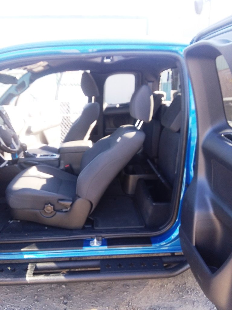

    make sure they check the seat rails - that is what absorbs the energy in a rear end collision. in this picture the driver's seat isn't reclined - it's bent. before the crash it was at the same angle as the passenger seat.
