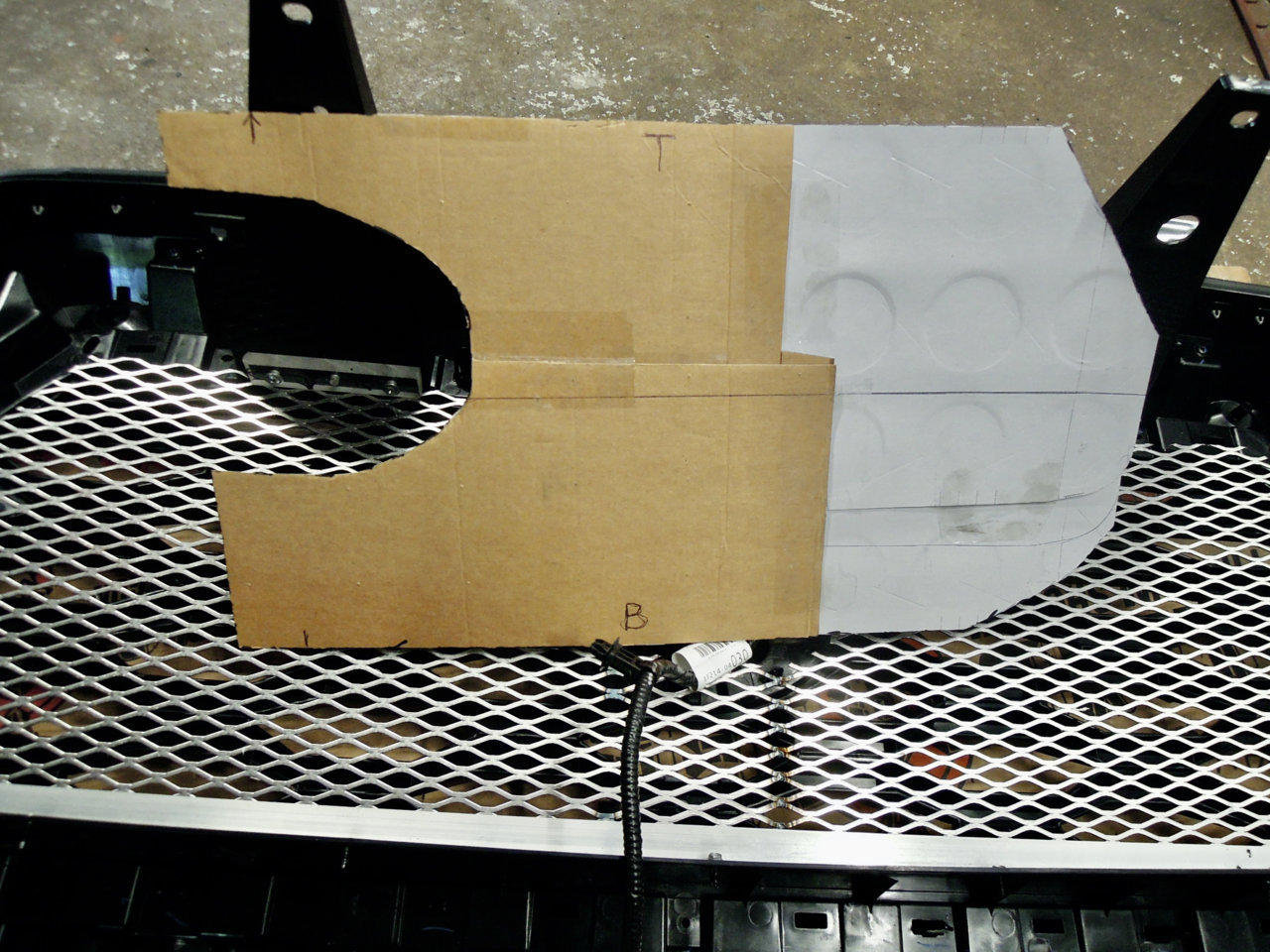

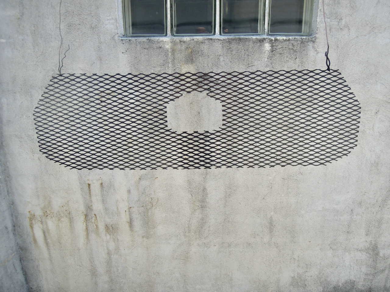

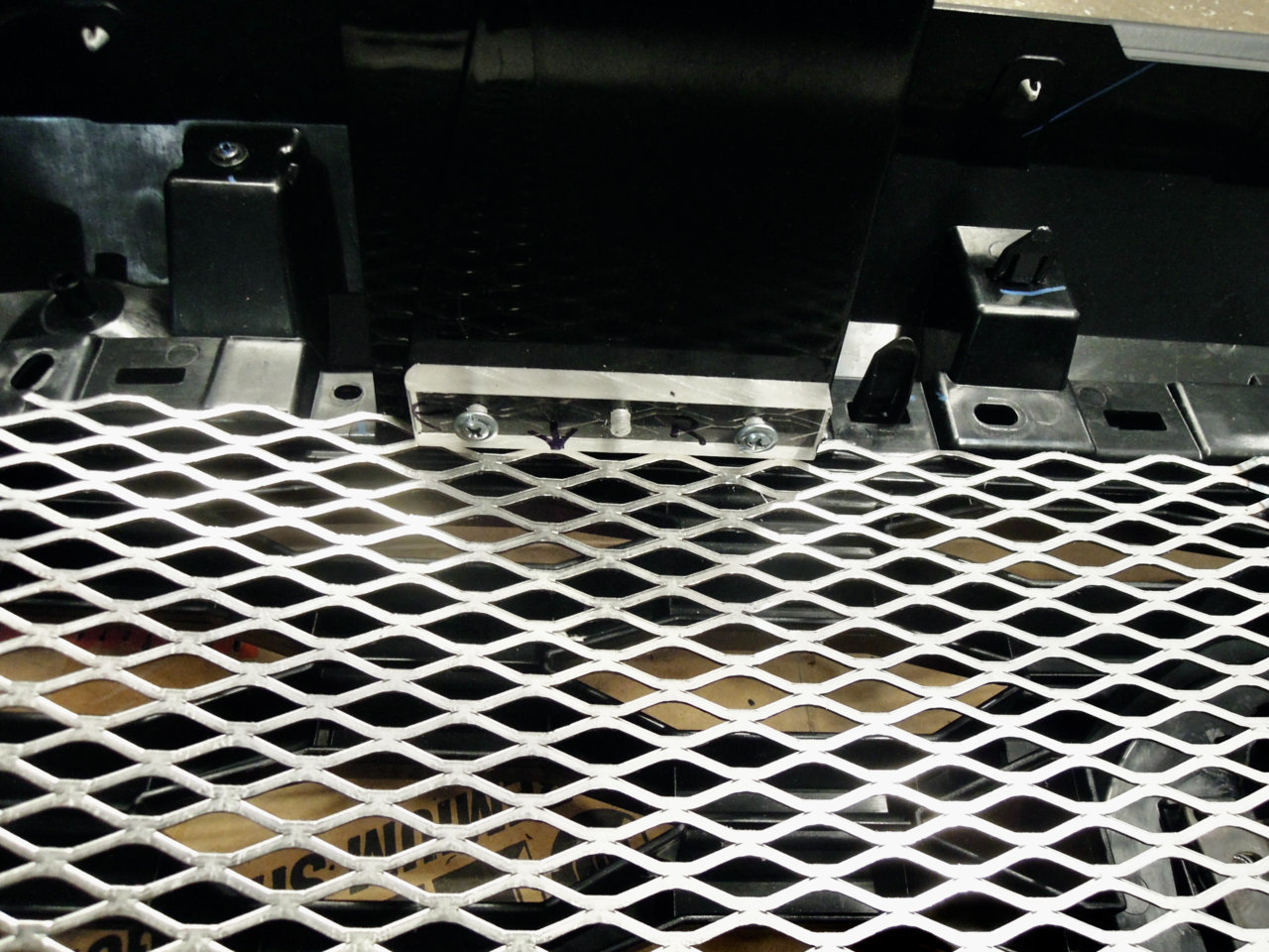

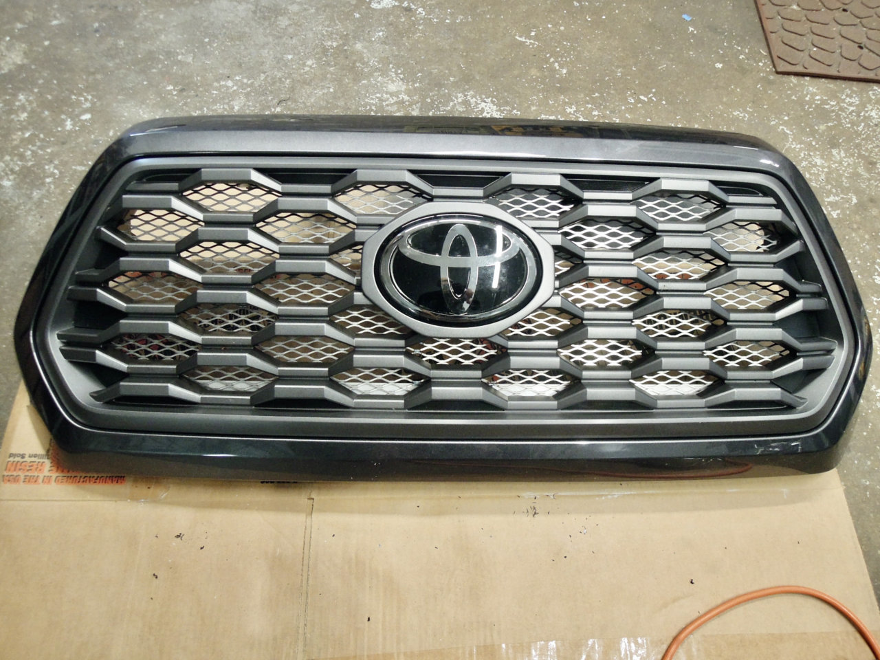

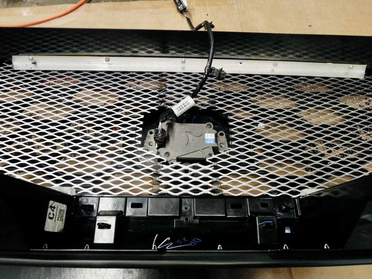

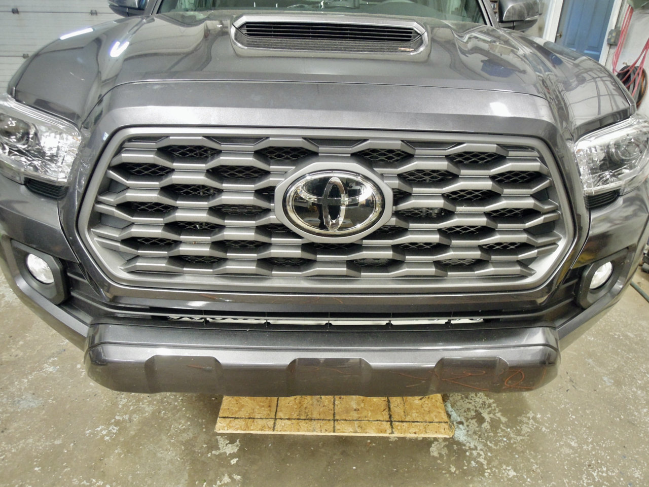

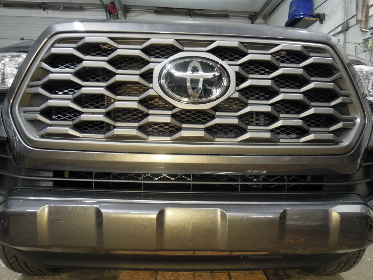

    I know there is a bit of this on the forum. Got some nice medium duty mesh from the Home Depot Store and went at it. Didn't want to use any tie wraps, and it fits nice and flush to the grill. Had to use two pieces - but it tack welded together very easy. Cut very nice with tin snips. Just did not like those larger than life openings in my grill. Had to open a case of beer to get the template material. Hmmm what to do with the cans ?? Regards Scott
    After a two hour drive to a job site in 90's weather - No rise in engine temp. -- No wind noise -- and the ADAS worked perfect after unplugging it and removing and re-installing the sensor. (I did not key up the vehicle during the whole process).

    Nicely done! You put in some good work. Probably a good preventative maintenance idea
    I probably would have painted it black beforehand just so it’s harder to see but to each their own

    I waited until the screen was done and fitted - then primed and painted it black. Maybe it is just hard to see in the photos. Was also able to fit a piece of heavy duty material down low for the lower part of the radiator. That was the easy one with the grill removed.

    I would check with Toyota service. I cannot remember but you may need to have your ADAS recalibrated since you unplugged the radar.

    That was my only concern. I really did not roadtest it for that yet. Didn't really read about any un-pluging issues. But you never know !! Thank-you for the heads up.
