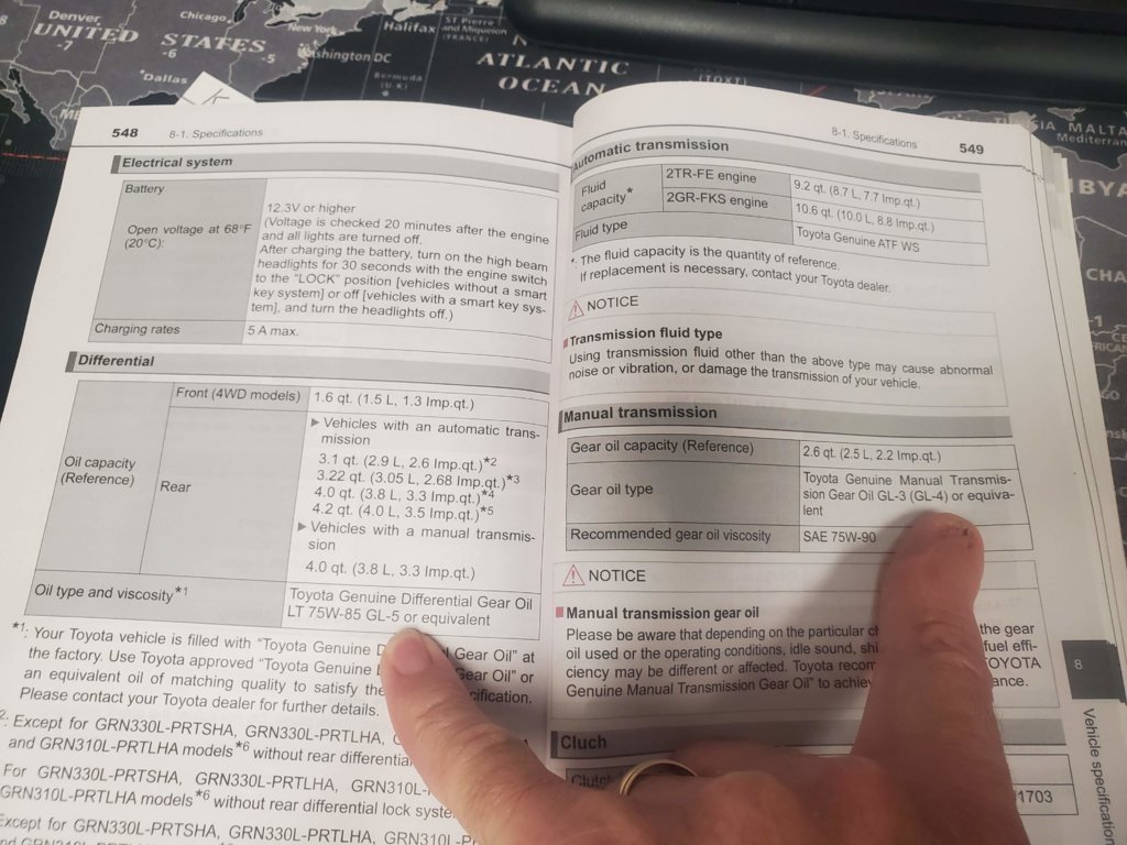

    It’s in the owners manual of what is recommended in the newer transmissions . If they put gl5 have them drain it and put the correct fluid in . I had to call around different dealers to get the right fluid . Dealers are lazy and don’t care . I have had a few heated conversations with advisors at different dealers . They are just not educated .

    I hear you, after I posted the above, I checked the owners manual.
    It clearly states GL-4 for the transmission, and they can't argue that GL-5 didn't exist, cause it is listed for the diffs.

    They're hoping you'll agree to save them some cost. Tell them no, they put the wrong shit in your transmission and it is now not functioning right. They should be fixing that, at no cost to you...

    I've engaged Toyota corporate at 800-331-4331, they are looking into the records and are contacting the dealership. I have the paper copy of my service records in hand now (they were at home) so I can refer to them while I talk to various people. I agree that it looks like they put the wrong flavor in - hoping to handle it smoothly rather than confrontationally.

    Yep, googling ""00036-00003 transmission oil" comes up "Toyota Lexus Synthetic Gear Oil SAE 75W-90 GL-5" - not for the right stuff for your MT

    I finally got a call back from the brand manager. Toyota has acknowledged that the fluid they put in my manual transmission was GL5 and that "additives in GL5 are corrosive to the synchronizers" they would like to do a transmission flush and put in GL4 because "there is no reason to believe that any long term damage has been done". Yes, I asked how those two statements could possibly both be true - my contact said, "yeah, I'm just reading it off the email..." He also said they can't find Toyota branded GL4, so they would have to use another brand - I suggested the Motorcraft mentioned in this thread, but they seem to have a Penzoil lined up. I have no clue what secret sauce they are putting into the manuals at the factory, and I didn't ask.
    If this does not clear up the problem, they will replace the trans. I asked what the time frame on that might be, and he said, "if it ever has a problem". I realize this is not binding, but I will try to get more concrete answers when I take it in for the flush.
