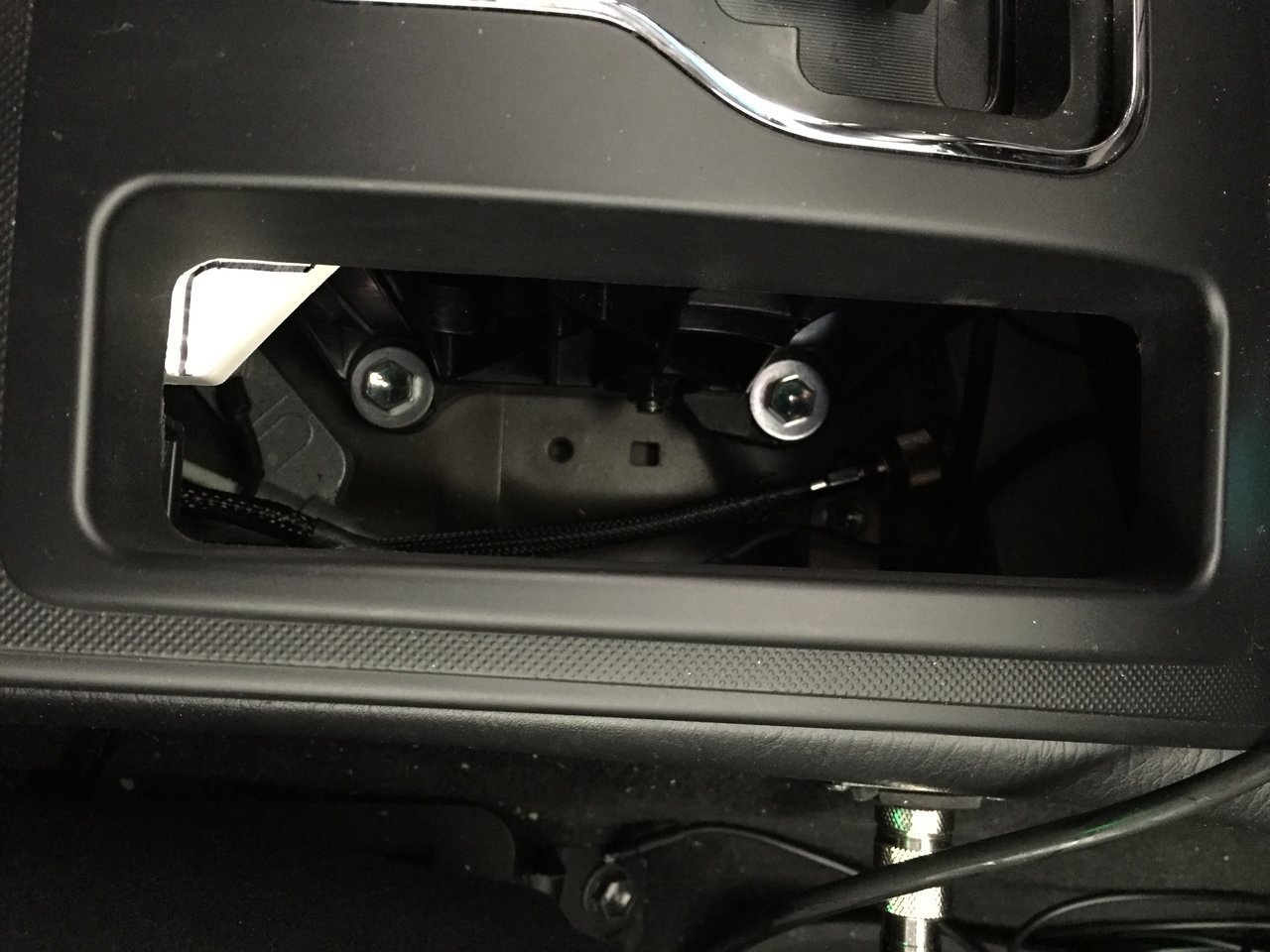

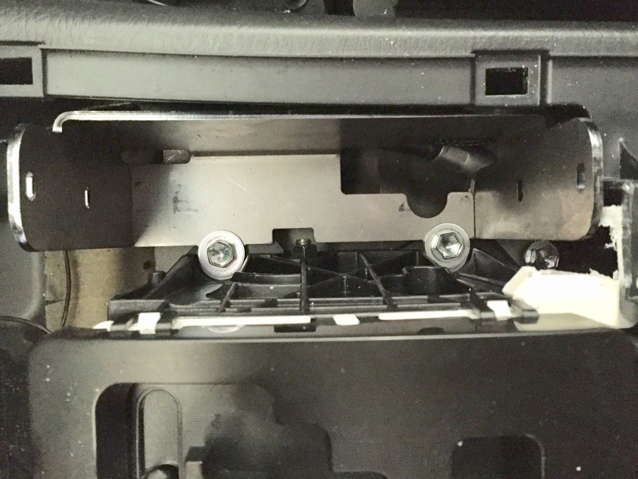

    This is how the bracket fits without the radio. Now that I look at it the screw might make contact just so, but we shall see. Everything else fit real nice the only difference with the 0.125 bracket is that the cooling fin needs more clearancing/tapering.
    And you can see above and below I basically cut the white plastic even with the black plastic extending over from the console piece.
    At first I didn’t cut it enough but it needs to be fully flush for sure.
    And for the shifter bezel storage cubby cutout, I ended up having to cut more off the end nearest the two cup holders, it was too low and makes contact with the radio bracket.
    Overall though everything fits nicely once room is made. Not a hard install at all.

    Yes I did see your pic showing the trimming for the radio mounting screw.

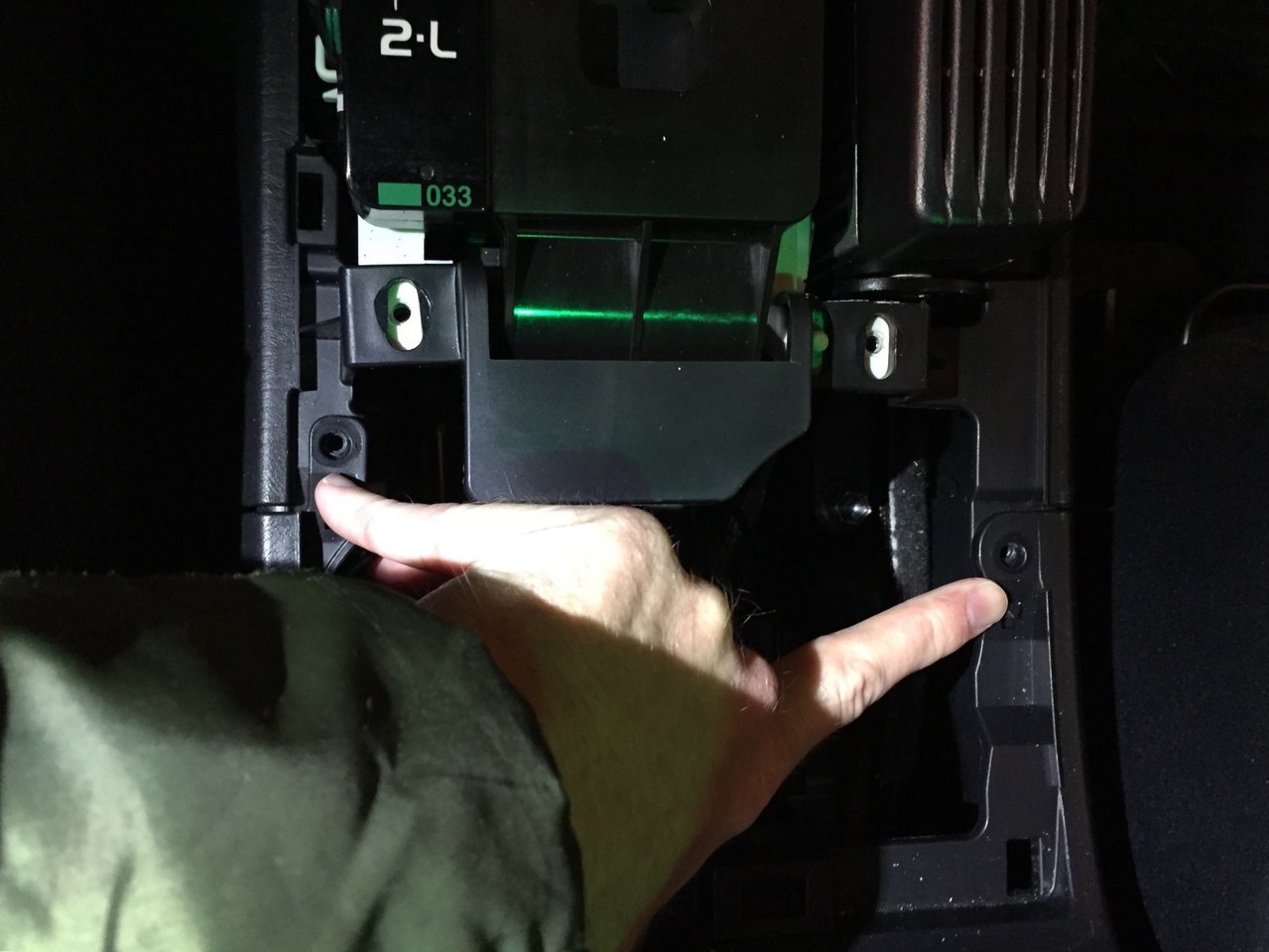

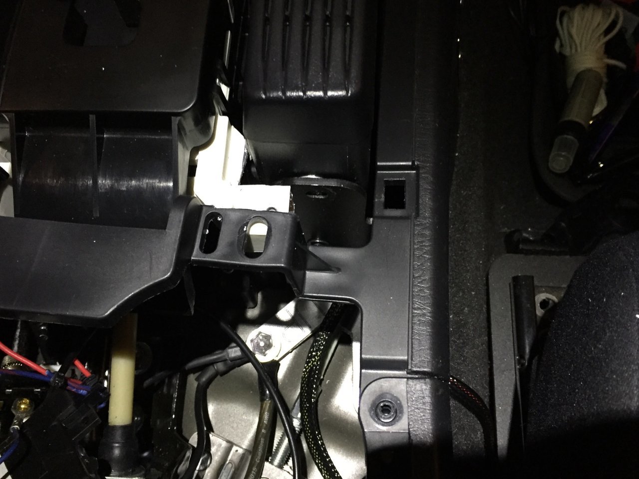

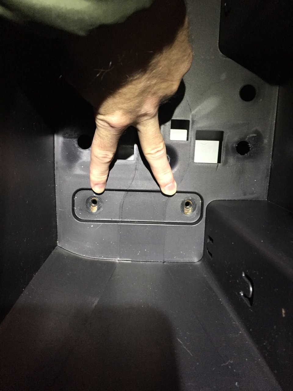

    I did not end up clearancing the mounting screw in question. I basically unbolted the center console and detached the 2 pieces from each other to move it out of the way, fasten the screw, then bolted everything back together.

    Console screwsx2
    Console screws x2
    Center console bolts out
    Plenty of space to put the screw in
    Pic below is prior to bolting things back. Screw will mate right up to the plastic with no extra clearance:

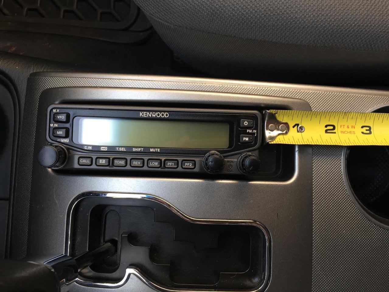

    I've decided to go a different route, just recieved the TM-V71A and test fitted in the location, its about 3/4" shorter...:anonymous:unnamed.jpg

    Honestly I would be alright with this just center it. It wouldn’t be too bad

    Right, I though about that, and also adding in spacers to the bracket for the radio to sit center.
