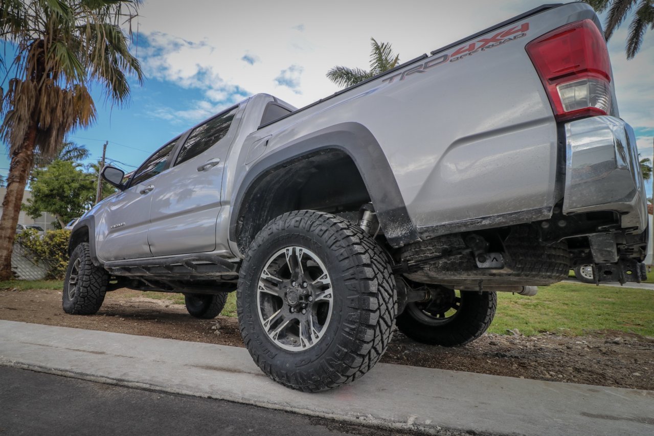

    got mine on
    Vanguard and ARCHIVE[OP] like this.

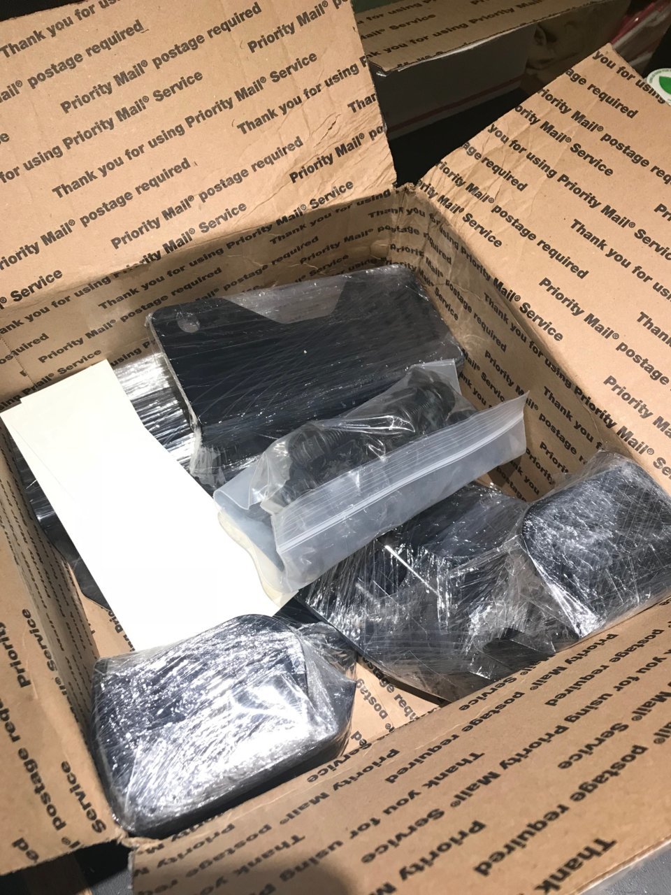

    Got my set yesterday...
    Trying to figure out when they are going to get put on the truck... as long as they are on the truck by April 30th.. that is all that matters to me.
    mcharfauros and ARCHIVE[OP] like this.
