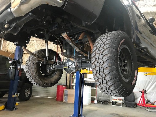

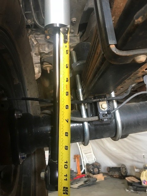

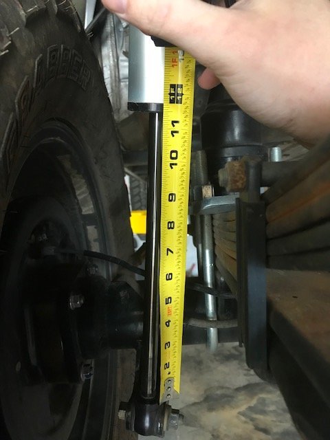

    I put the truck on a 2 post lift yesterday at a friends shop to check the full droop of the rear end, check to make sure I have enough slack in the lines, and to check the torque on any bolt I could get to.
    But here are the measurements before and after the Hammer Hangers.
    I measured on flat ground from the lip of the fender well to the ground both passenger and driver side.
    Before HH - 42.5"
    After HH - 43.25"
    Difference = +.75" in the rear approx.
    Travel measurements
    Before HH - Icon Shock Max Travel - 10"
    After HH - Icon Shock Max Travel - 11.5"
    Difference = +1.5" Travel
    I have enough slack in the Diff Breather Line, ABS Wiring, Air Lock Liner, and with adding some spacers on the bottom bracket for the brake line, there is enough slack in the brake lines that there would not be an issue. I had a set of +6 brake lines to go on... but looking at it, they are going to be too long honestly at no droop, so I am going to try and sell those and get a set of +4 as they should be pretty much perfect.
    seoulja99, ARCHIVE[OP] and 90yota like this.
