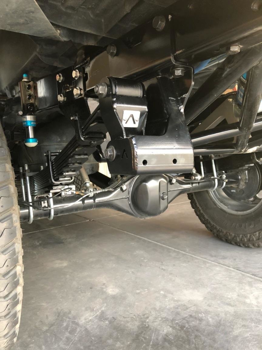

    So, it's been about a week since the install, and so far...cush!
    Granted, I haven't gone off road with this set-up, yet. But the ride in the city, highways, and mall parking lots are solid. These Archive Garage Hammer Hangers (AGHH) with the Archive Garage (AG) U-bolts and the Deaver U402 leaf spring packs are an excellent combo.
    I need to go flex them on a ramp to see what they're like compared to stock hangers with AllPro Standard leaf spring packs and the AG Shackle Flip with AllPro Standards. Once I do, I'll post photos of the different set-ups.
    I wish I took a photo of the droop when I had the truck up on the hydraulic lift after installing just one side. It looked very comparable, at a glance.
    I'm also a fan of the fact Eric took into consideration that the Hammer Hangers would probably hit and drag on the ground so the curved edge on the front side of the HH is a nice touch. The HH do hang lower than the AG Shackle Flip, so we'll see how they do when I take the truck off road with the new set-up.

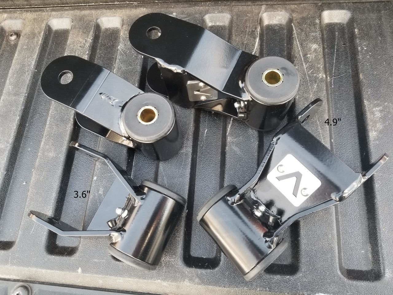

    Here are the shackles options:
    -3.6" shackles fabbed from 3/16" A572 50,000psi steel, 1/4" wall DOM tube, high quality poly bushings & grease fitting (No badge).
    -4.9" shackles fabbed from 3/16" A572 50,000psi steel, 1/4" wall DOM tube, high quality poly bushings & grease fitting (SS A-badge).
