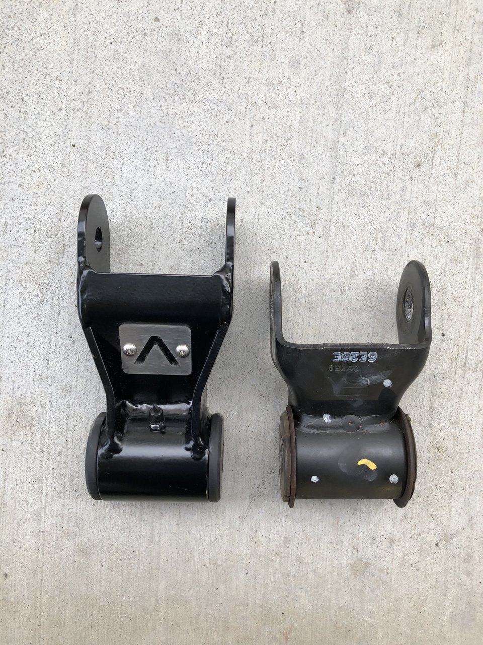

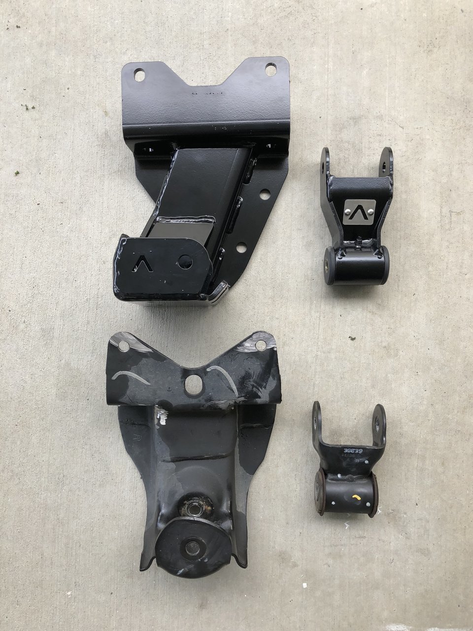

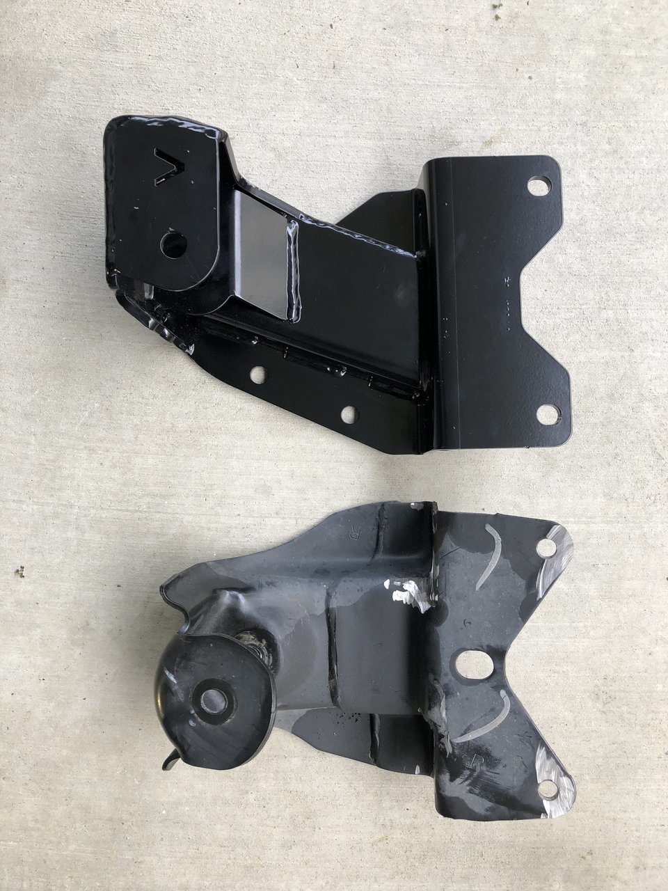

    HUGE thank you for posting the comparison of the hangers side by side. It was hard to tell from the pics, and I was thinking that these hung a lot lower than they actually do. Looks like they're barely longer than the stock ones.

    From what I remember, the AG HH's are about 1" lower that the OEM shackle hangers.

    Thanks, that's not bad at all. I'll take 1" lower over the cons of a shackle flip any day. I see one of these in my future.

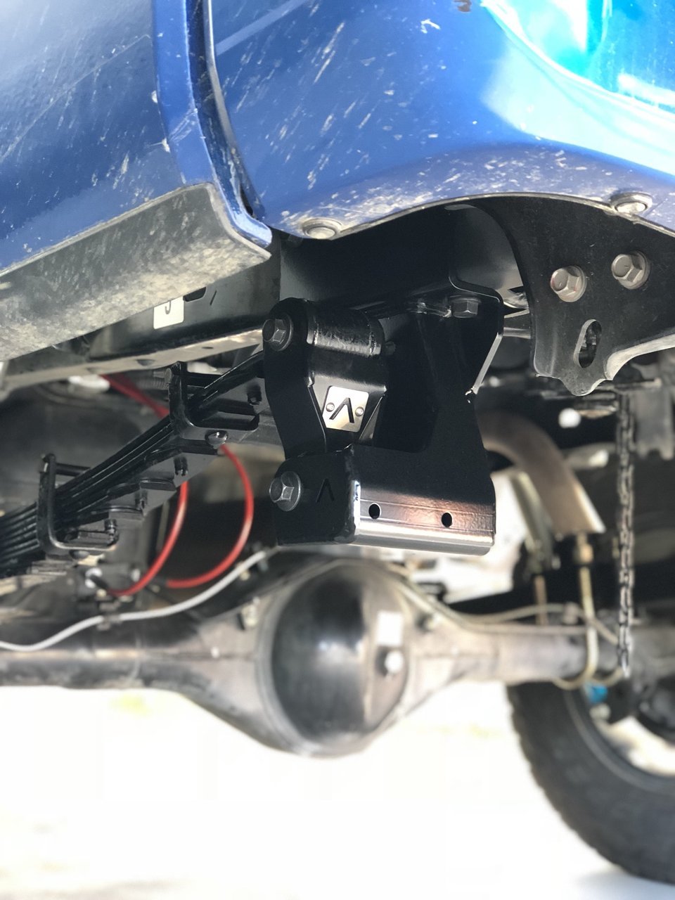

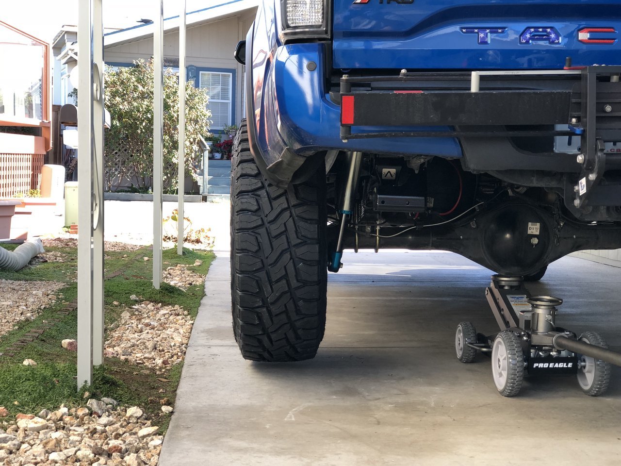

    No problem man.. here’s a few more shots
    H3llRid3r, johntoyota, runmc and 4 others like this.

    @Wavey88 I like the wheels on the jack man

    Going to ride a few trails on the Tahoe Natl Forest this weekend, aka I'll be going to have a photoshoot of my truck. Will get some pics of the goods.
    Thanks, expensive AF for a jack tho.. It's the pro eagle big wheel jack

    So I'm spring over and have a few questions.
    Maybe more for @ARCHIVE but any info is great.
    With the hammer hangers, they move the pivot point rearward, doesn't the shackle in tension want to still run straight up and down with the truck weight sitting on the ground?
    Doesn't moving the hanger pivot rearward move the axle rearward also having the tires closer to the rear of the wheel well opening?
    Lastly, just so I under stand, the 4.9" shackles with the hammer hangers would net a person 1/4" less in lift height compared to stock hanger and stock shackle?

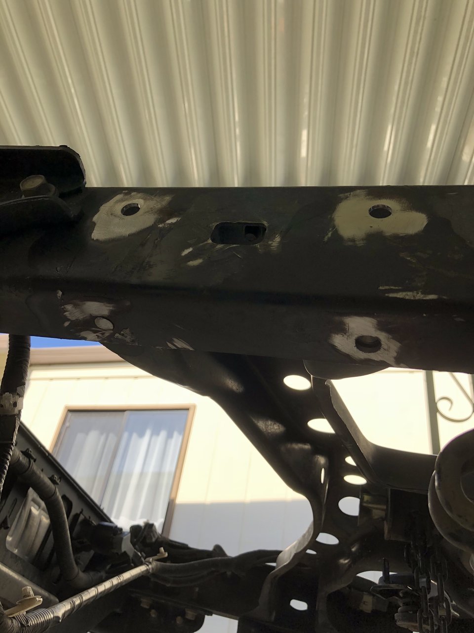

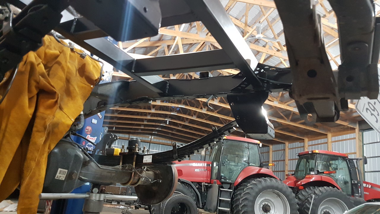

    Decided to add some frame beef before i added the hangers.

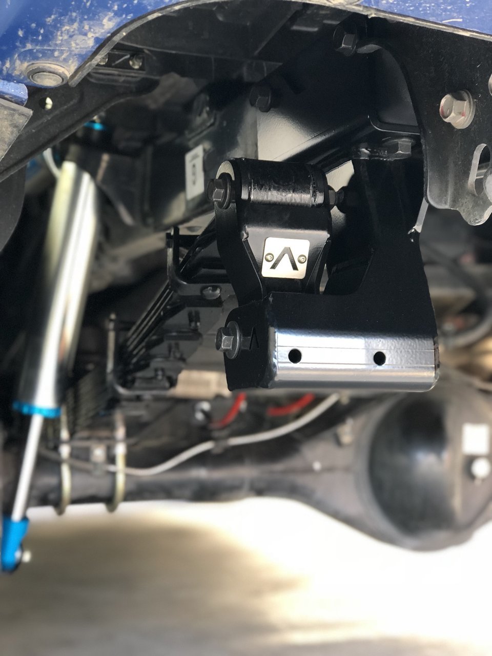

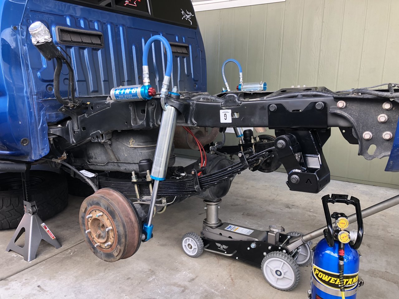

    You may want to double check the clearance of this bolt (circled in red). I know on a stock setup, the bolt has to be facing out since the threaded end makes contact with the stock hanger (found this out through personal experience). I don't know if the Archive setup allows for a little more clearance for the bolt to be oriented the way you have it or if you'll have to turn it around just to be safe.
    On my stock setup, the end of the bolt was making contact with the hanger and I developed a nasty squeak during articulation as the bolt began to self-clearance on the stamped-steel stock hanger.
    Not knocking the design (I want these), just giving you a heads up and passing along info that I learned the hard way.:thumbsup:

    You are correct. My instructions say to have that particular bolt threads point outboard, and wavey and I talked about it.
    Thanks for commenting on it

    I realize I quoted an old post and hope he corrected it by now, but I didn't see that it had been mentioned yet.
    I chase down squeaks religiously on my truck and that one was elusive until it was stupidly obvious. The stock hanger had a shiny polished arch gouged out of it where the bolt had been rubbing and all the coating was gone and metal deformed.

    I know what you're saying, but most aftermarket springs are longer than stock, in which case the shackle ends up being straight up with HH . Having the shackle pivot point located back a bit contributes a little to ride compliance as well with the longer springs. 4.9" would be about 1/4" lower, which is really negligible in my opinion
    You can ran Tundra 3.9" shackles in the HH.
    I'm not familiar with King offerings for stock location, but I know they offer extended length lower rod ends.

    Looks awesome Jeff. Coming along nicely, I see the shock relocation bits sitting there
