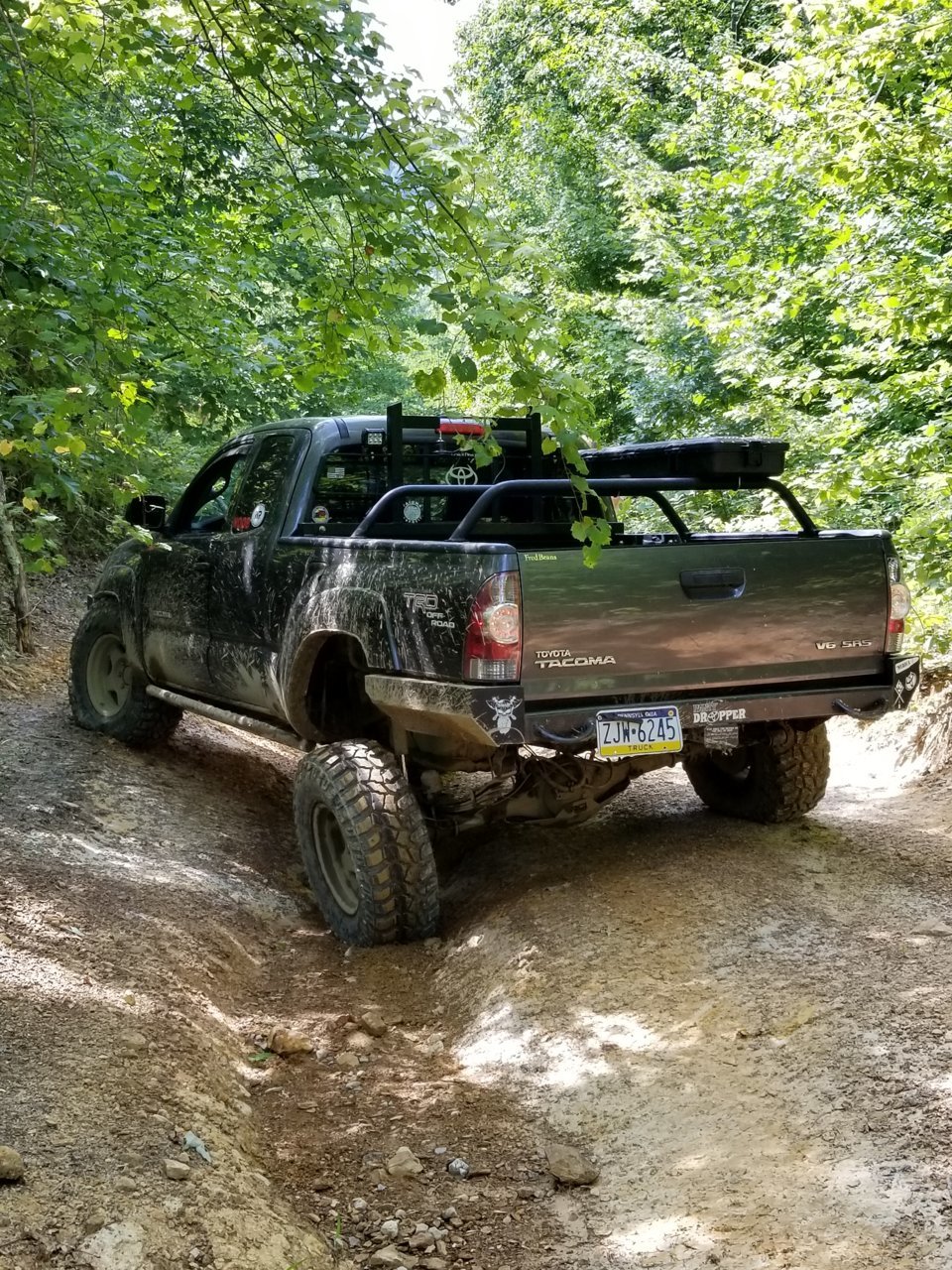

    To give you an idea on capacity (this is parked on a hill mind you)
    This is my truck with the following
    Truck cap 300lb
    Rtt 165
    Rear bumper with swingout and all the crap 250lb
    Bed drawers 100lb
    Crap in drawers. 150lb
    3 inches of lift on the front and you can see the springs still have arch ;)

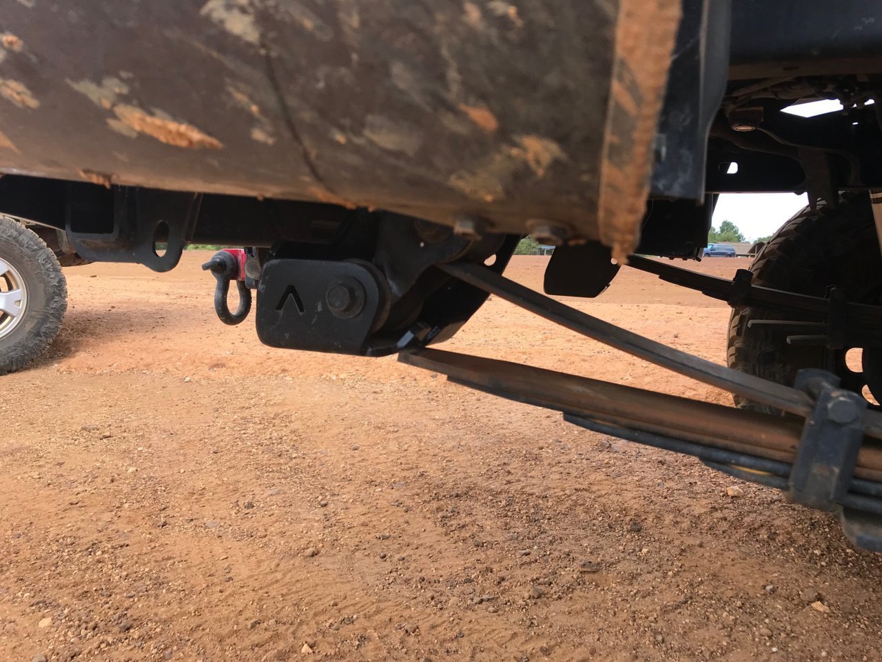

    About halfway done...
    I'm planning a similar build with Hammer Hangers. I think as long as the second leaf doesn't extend too far it can clear the shackle when rotated horizon. @Blackout14 can you possibly get a measurement of the second leaf spacing to the end?
    Attached is a photo of the problem I want to avoid
    Murphinator[QUOTED] likes this.

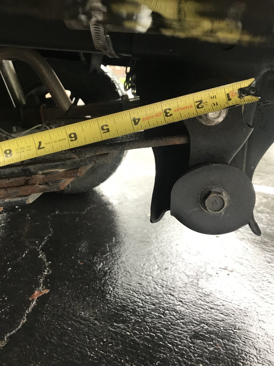

    Yea I can take a peek later today. As far as length and width they are the same as stock though and Work and a few guys are running different shackle flips and all that with no issues

    Hey buddy sorry got that measurement sorry the tape is upside down
    SaphiraTaco[QUOTED] likes this.
    Looks great! On the updated Hammer Hangers the offending tab has been removed/redesigned so this should work without any problems
