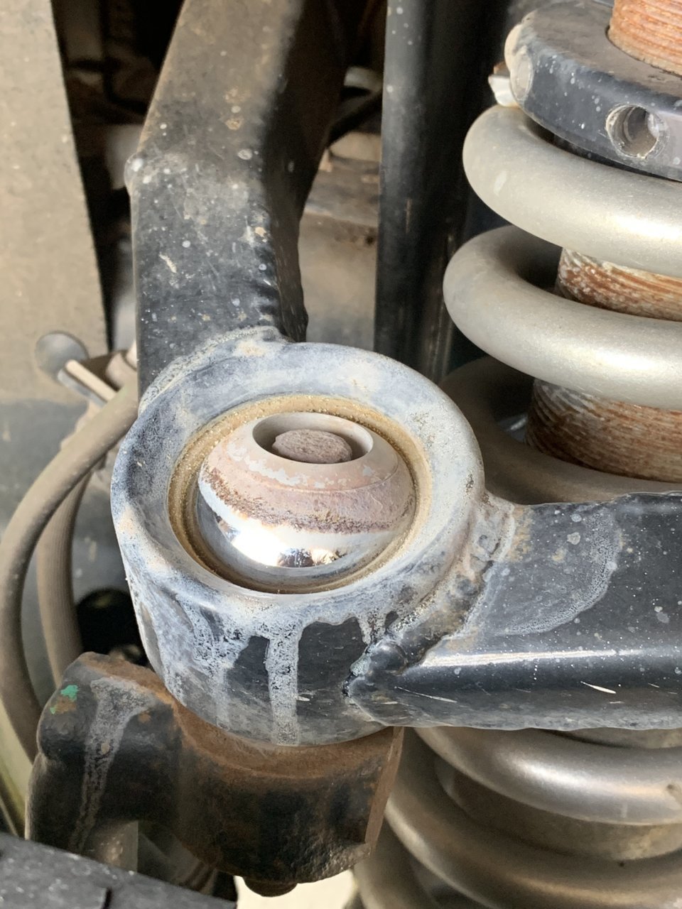

    Yeah I am gonna order some new uniballs and have them on standby if things get worse.
    These are ADS coils. The driver side doesn’t have anything on it, so I’m sort of confused about that. Must be from side of the road puddles or something, doesn’t make sense. Gonna spray em down and see if it cleans off, but it’s just cosmetic. I’m not adjusting these things.
    The amount of grime on the roads even robbed som of the powder off of my skids and they have minor discoloration on them. Welcome home, I guess.

    @Arcticelf runs ss uniballs in his and has pretty good luck as does @HomerTaco maybe something just got on that side. Spray them maybe with something like a dirt and grease remover first then pressure wash?

    I’ve actually got it on stands right now and drenched them in CRC dry PTFE. Pumped the zerks with grease, too. Got a few good pumps in there before it gave resistance :anonymous:

    That's impressive. I don't do much to my uni-balls other than wash them occasionally with a hose. Definitely not a pressure washer though, that drives grit into the PFTE lining at eats them.

    I power wash my truck but I don’t hammer the wheel wheels because of that reason. It’s also an electric model, so it’s not really delivering an incredible amount of power.
