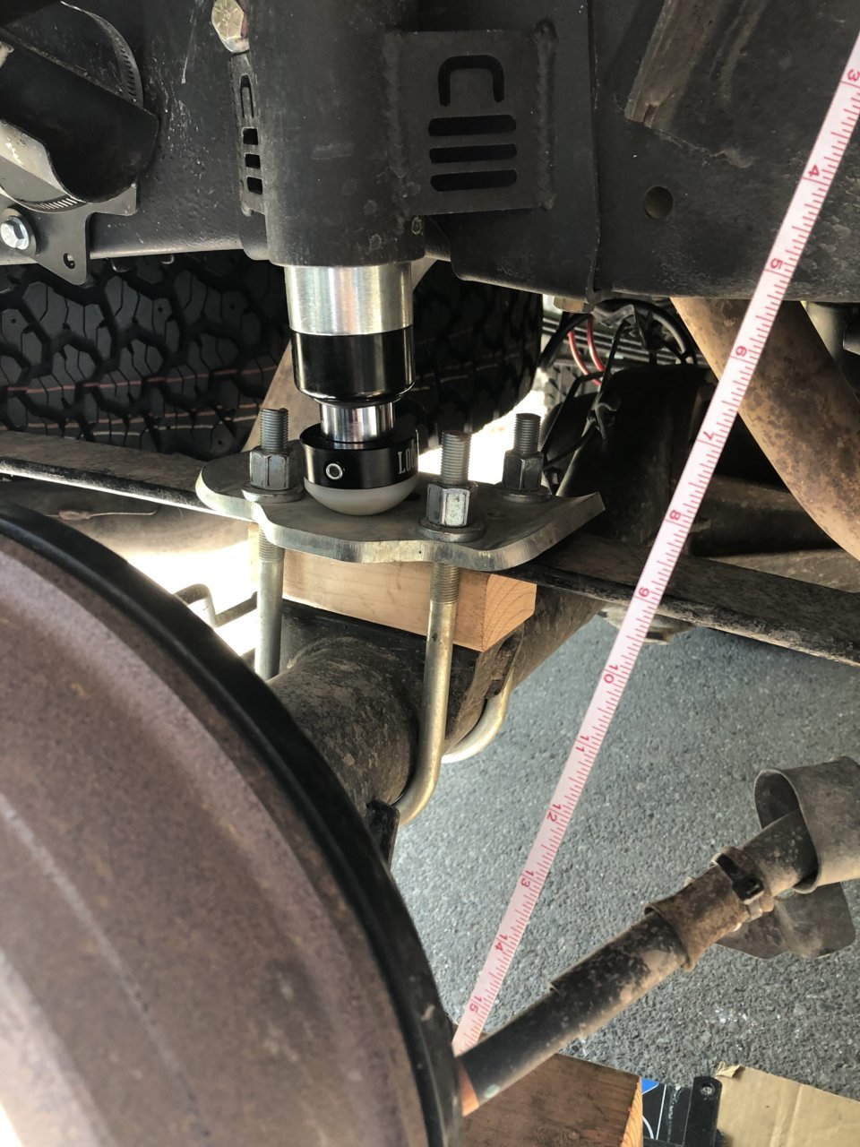

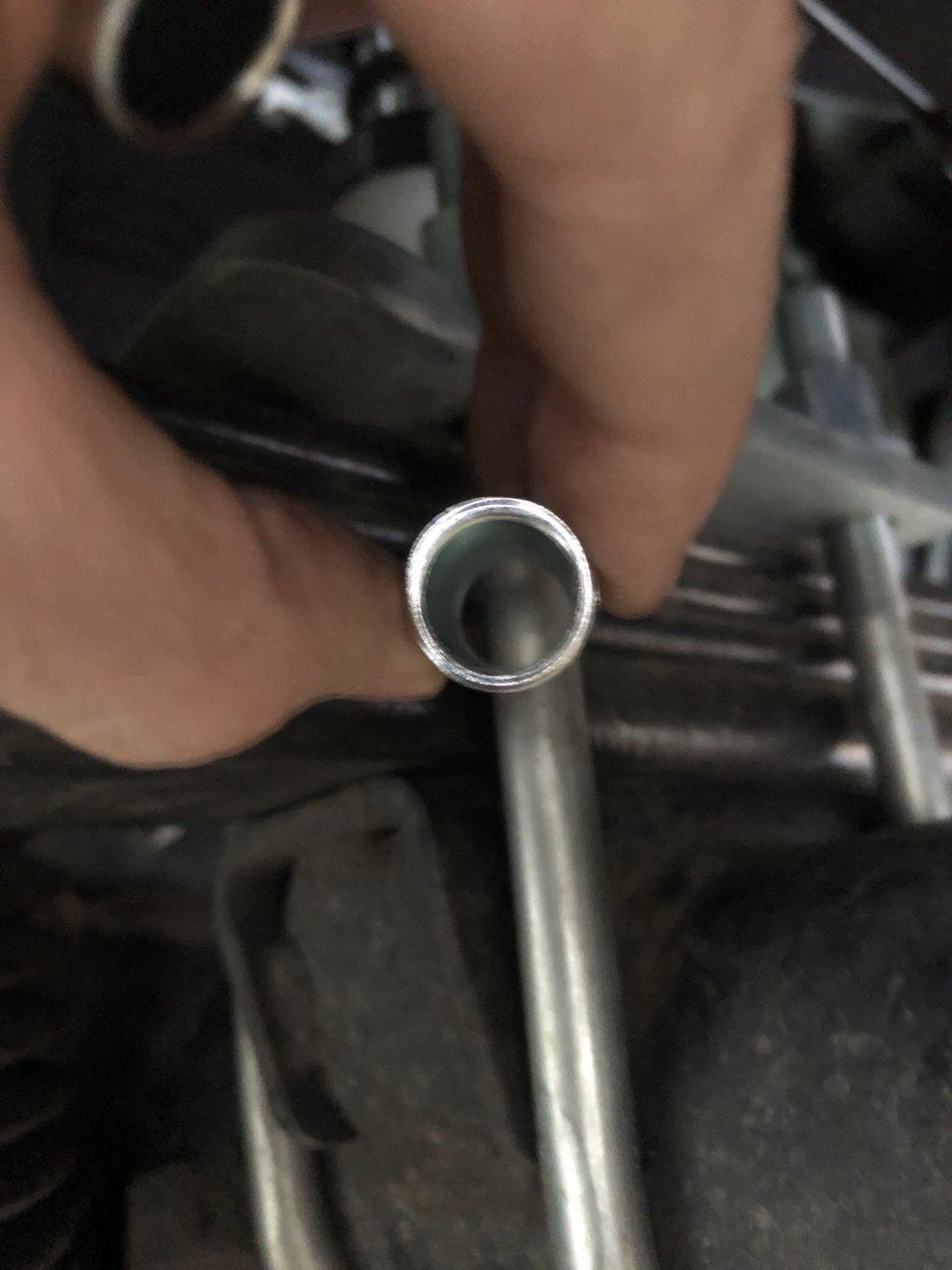

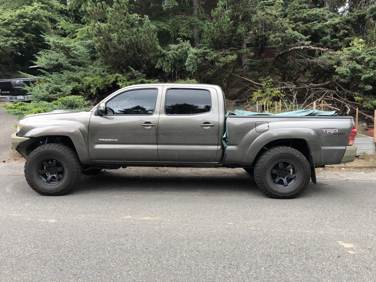

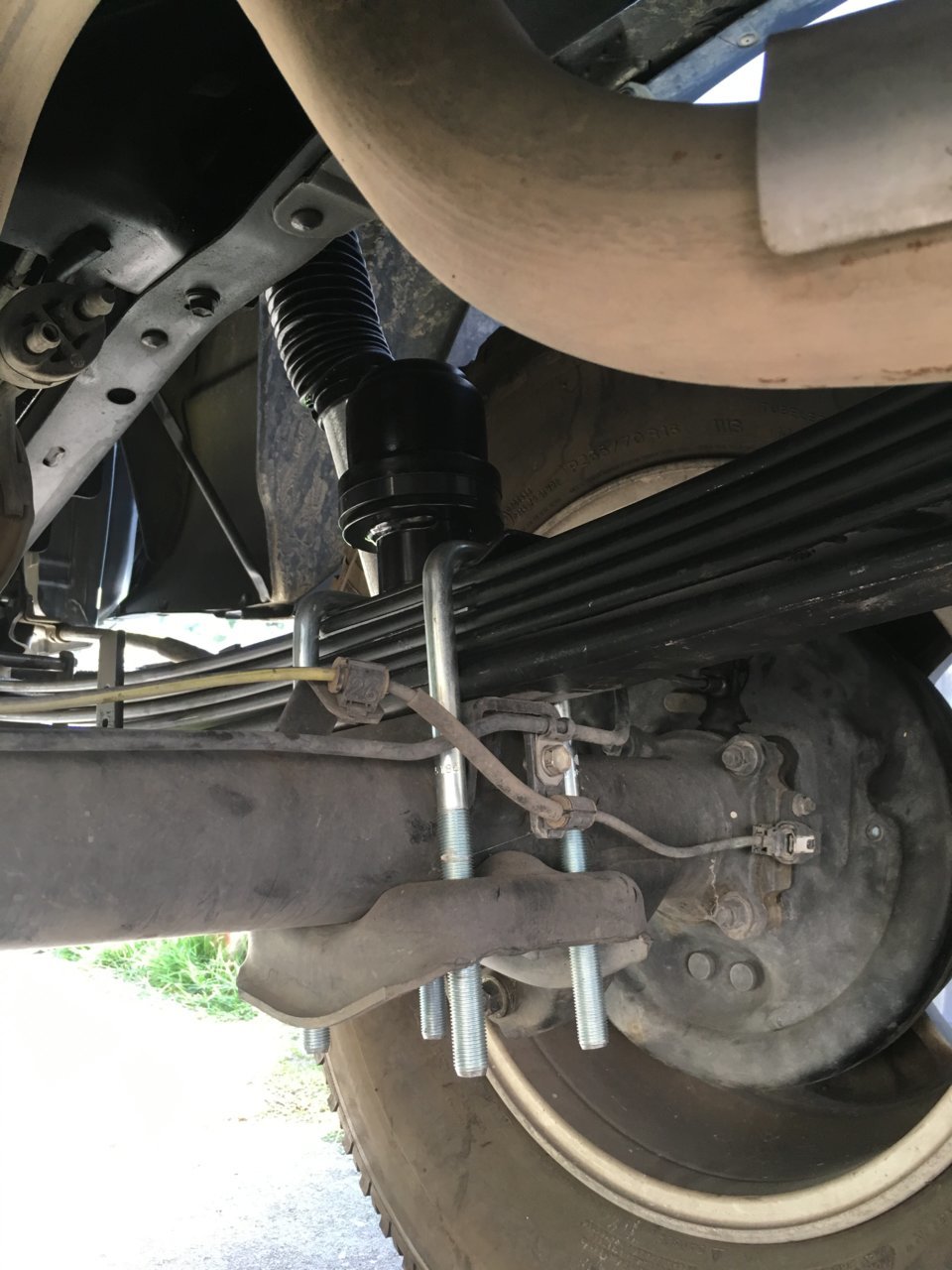

    Yes still working well in 3+1.
    Currently still lifted 1.6” over stock in rear.4E0F9784-C8BF-4AA4-8006-508DF22C0D19.jpg7BDF0C8A-5B97-456E-9618-7A4AEB9A9560.jpg
    I’m getting closer to adding one more leaf in because when we load up for camping trips the back sags more than I want. For side shots I only have one loaded with a full yard of dirt... Rides on my bumps when I do that but feels smooth because of the Locked Off road bumps.

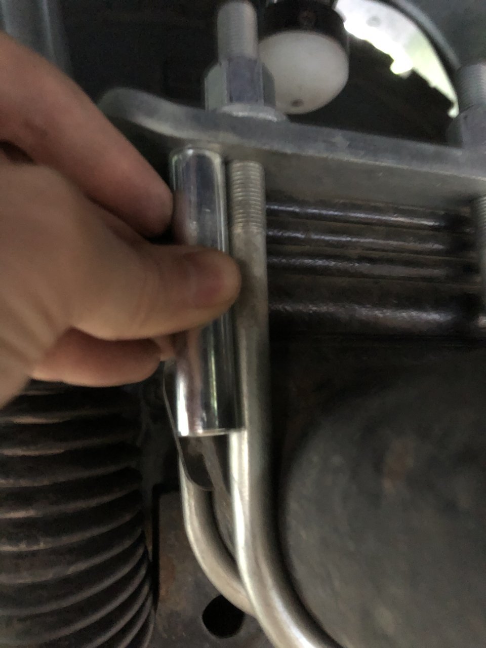

    When I add leaf #4 I’m going to add a spacer tube on my U bolts to prevent the over load leaf from rotating. Seems like an easy fix to me.

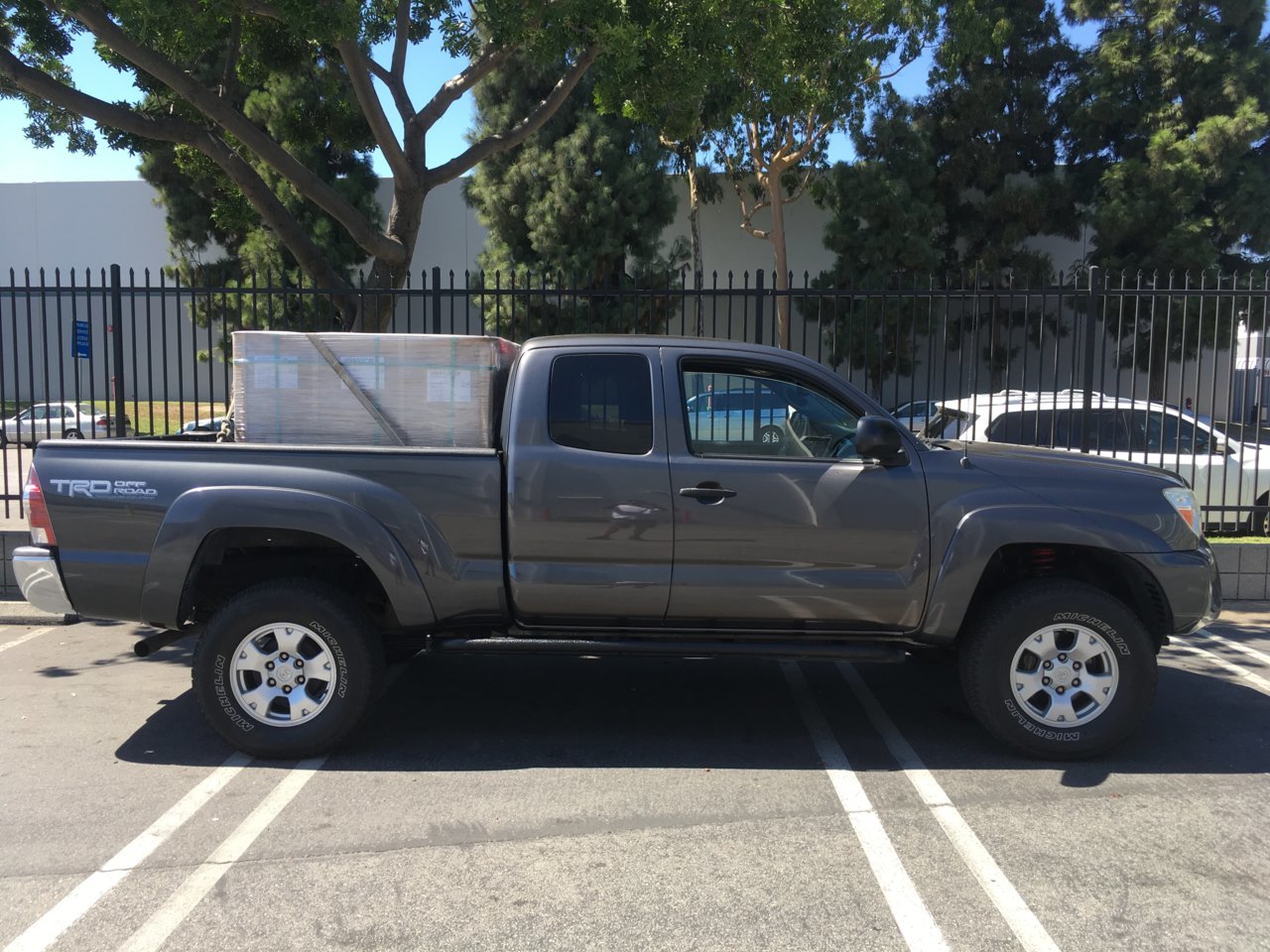

    Shout out to Blackout! Went with the MD 4+1 leafs (2-2.5” lift) and RCD/B110 5100s. TX Baja kit up front. Installed a week ago and loving it!
    Speed bumps at 20mph (empty bed) isn’t overly stiff, rears felt planted and controlled.
    500kg in the back dropped her a few inches but still had rake. Handles way better than before and best yet: no noises, no vibes, no angle issues! I highly recommend these.

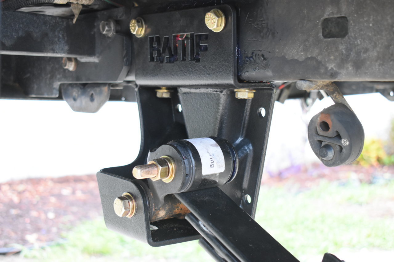

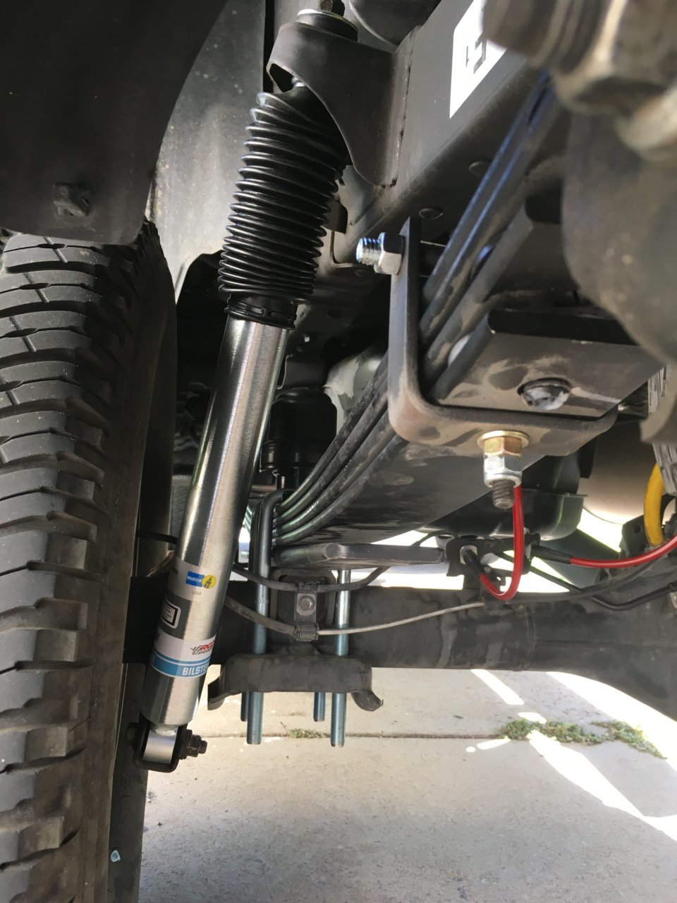

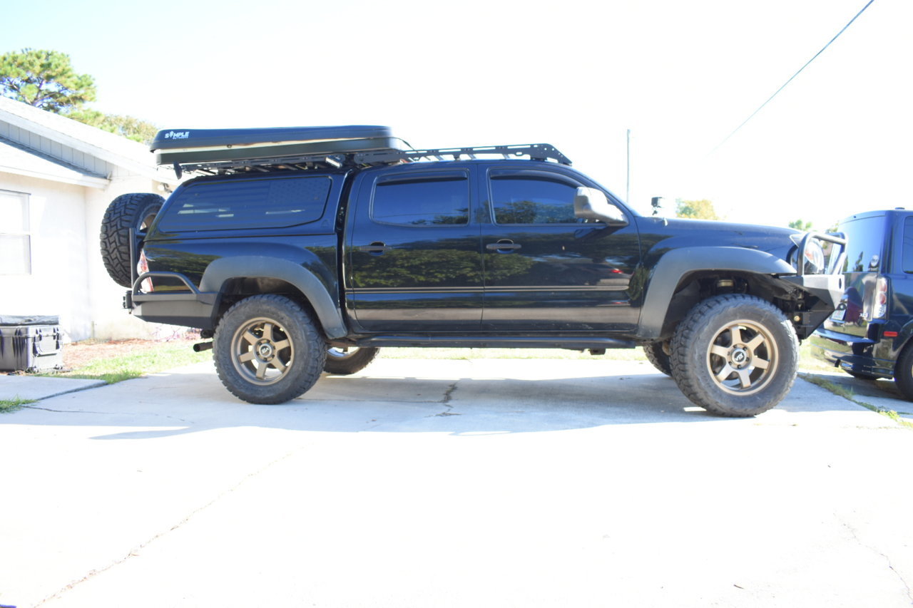

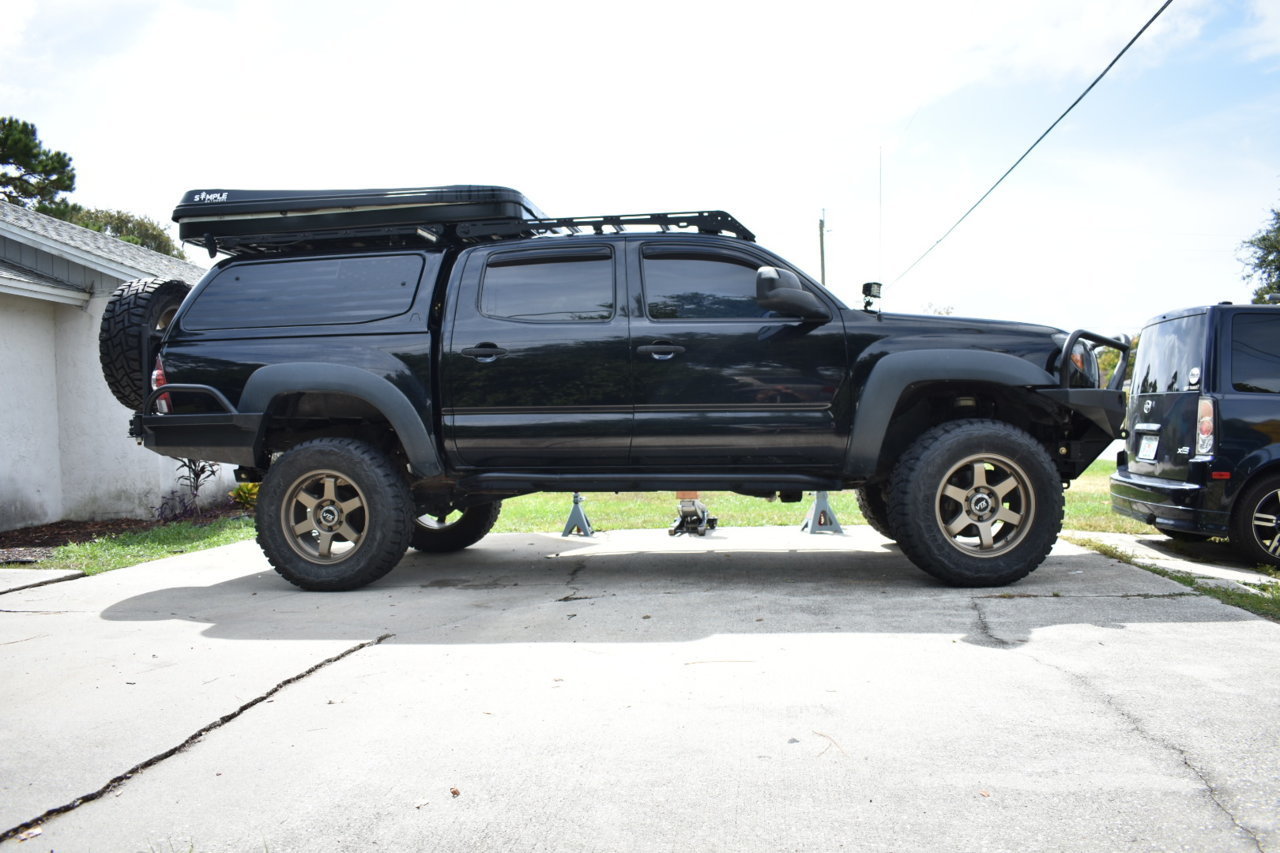

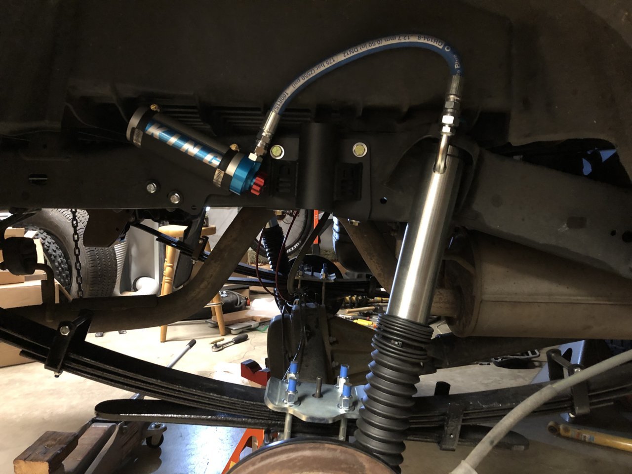

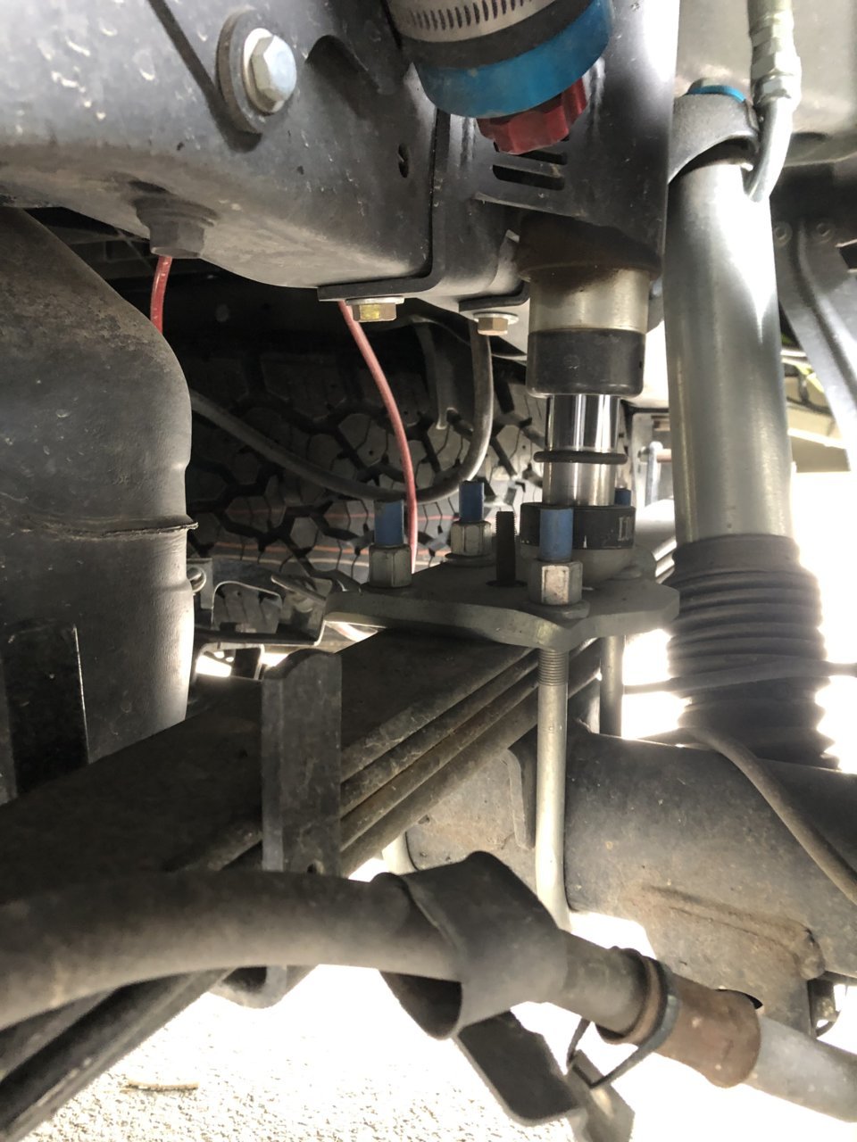

    SUSPENSION: 3” Factory/Toytec Lift Blackout14 Custom Leaf Pack 5+1 HD Bilstein 5100 B100 Shocks Wheelers Off-Road U bolt Flip kit w/ Timbren Bump stops BAMF HD Rear Shackle Hangers ARMOR: SOS Off-road Concepts Sliders SOS Off-road Concepts High Clearance Rear Bumper Pelfreybilt Front Bumper Full Hoop GEAR: Smittybilt X20 10K Synthetic Line Winch Leer 100XQ Prinsu CABRAC & TOPRAC Simple Outdoors Skyloft Hardshell RTT Pope Overland Expedition 72” Awning 18x9 VTX Off-road Bronze Terra CaliRaised LED Lights FUTURE PURCHASES: SOS Off-road Concepts Full Skid Plates Relentless Fabrication Tailgate Reinforcement ARB Twin Compressor w/ Locker

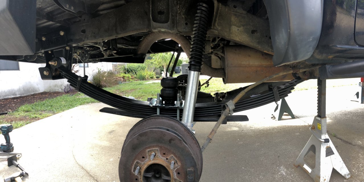

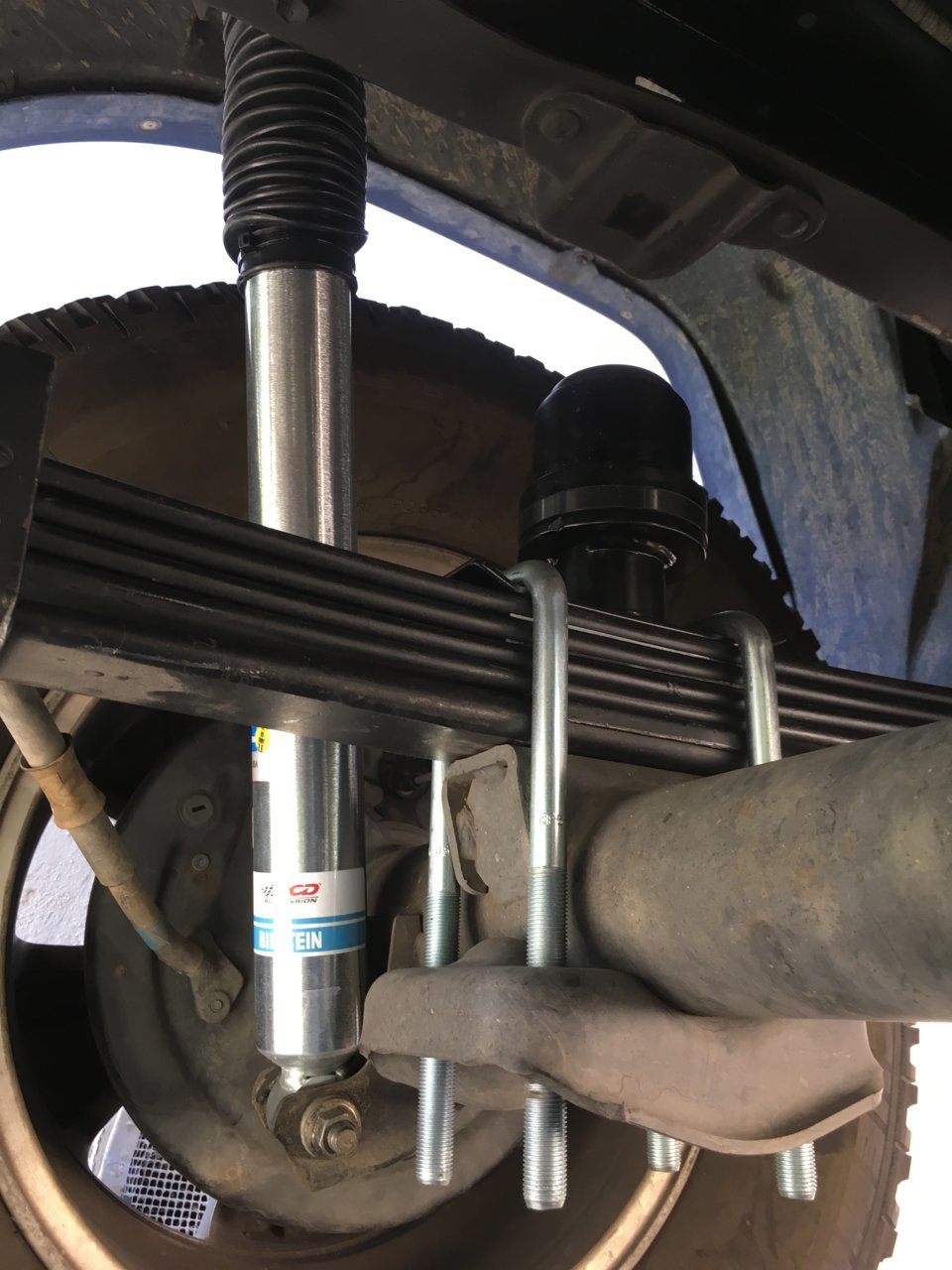

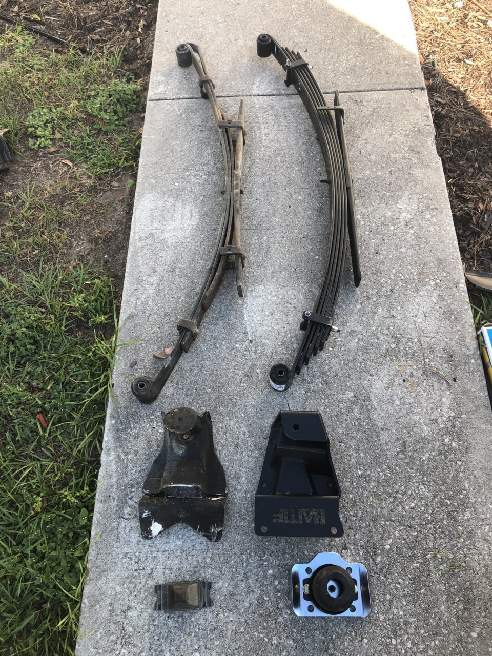

    Replaced the entire rear suspension this weekend. Removed the factory leafs, shocks, bump stops and shackle hangers. Installed BAMF HD Shackle hangers, wheelers off-road ubolt flip kit with timbren bumpstops, bilstein B110 5100s, and the HD 5+1 leaf pack. Chopped the exhaust while I was at it. Crazy to see a comparison of the factory junk vs quality aftermarket parts. Night and day difference. Only issue ive noticed was I got a little bit of a vibration during acceleration from a dead stop.. Ordered shims and a carrier bearing drop kit. Other than that I am completely happy and cant wait to get off road with this set up. (Pretty sure there are loose bolts in the pic of the shackle hanger it was taken right after I got it up there and not torqued down yet)
