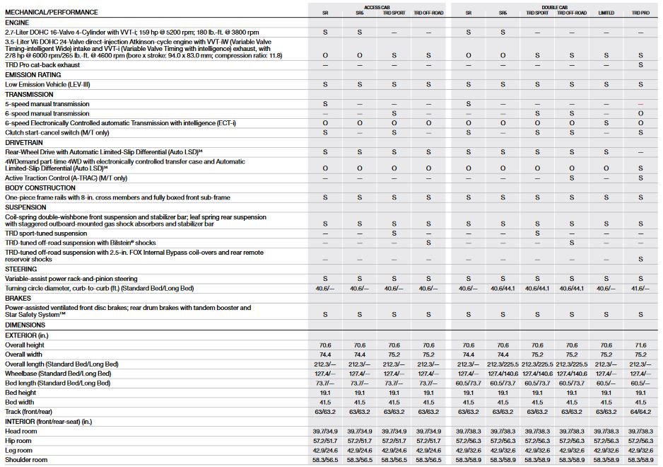

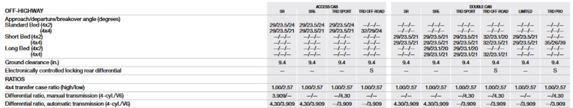

    Comb
    Comb Known Member
    Oct 27, 2016
    #200814
    1,834
    2017 TRD Sport 4x4 DCSB 6MT BBP ABCDEFG
    OVTune Verified Purchase
    This is correct:
    BlakeM and SRBRO5 like this.

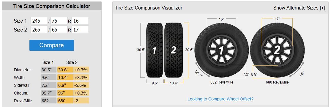

    T4RFTMFW
    T4RFTMFW Well-Known Member
    Jul 23, 2014
    #134525
    69,757
    What you gain in wheel height you lose in tire height.
    So a 265/75/16 and a 265/70/17 are nearly identical.

    Comb
    Comb Known Member
    Oct 27, 2016
    #200814
    1,834
