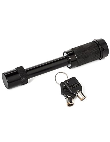

    [​IMG]$17 Connor Trailer Hitch Lock - 5/8" Stainless Steel Hitch Pin for Class III , IV , V Hitches , 1615280 Receiver Lockhttps://www.amazon.com/gp/product/B0141HZ62O/ref=oh_aui_detailpage_o04_s00?ie=UTF8&psc=1
    The Connor Hitch Lock has one flaw. The provided O ring doesn't make contact with the lock rendering it useless. I have this one and used a #203 O ring that I carefully "shaved" down with a razor so that it makes contact with the lock yet it allows the lock mechanism to fully engaged when pushed together. I'm hoping that this mod makes it more weatherproof....
