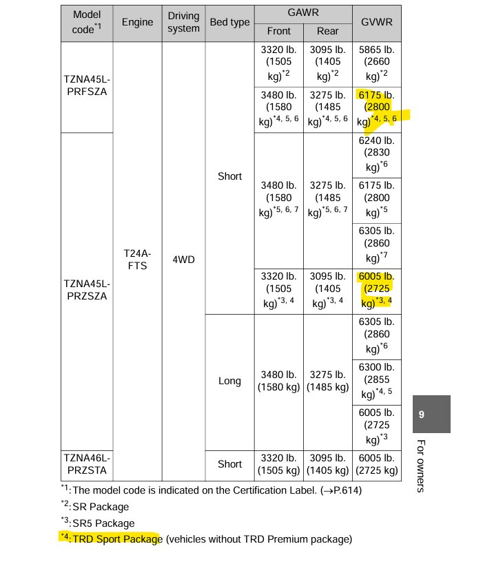

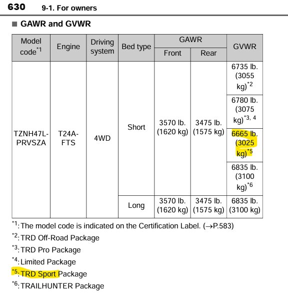

    You are carrying around that 500lbs of extra weight 100% of the time that you are driving, but only getting the benefit of the extra torque in conditions where you are exceeding the limits of the non-hybrid.

    The hybrid adds 500lbs? That’s insanity if true

    Yeh it can't even be determined by a weight comparison. It would have to be done by weighing the individual parts. Motor and batteries and cables and controller.

    Seems unlikely with such a small electric motor and battery but the GVWR are a lot higher for the hybrid models. Both the hybrid and non-hybrid owner's manuals list the same payloads so it's not a higher GVWR because they are rated to carry more in the bed.
