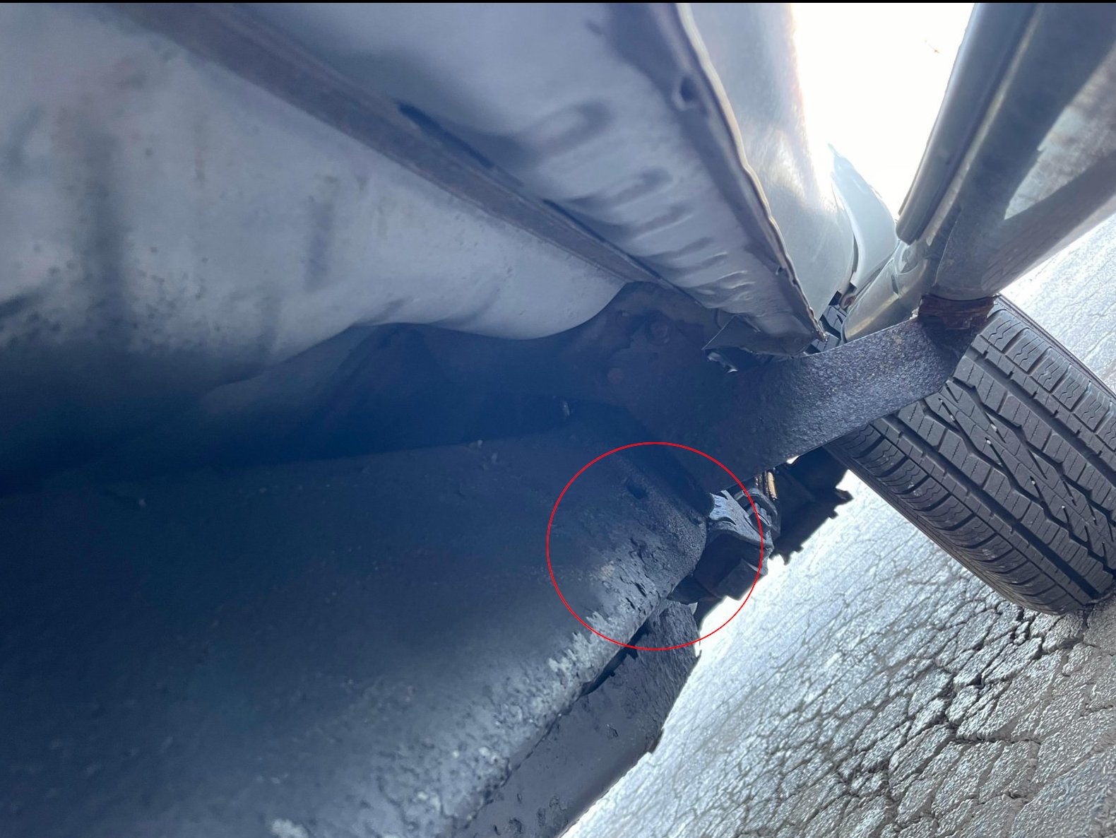

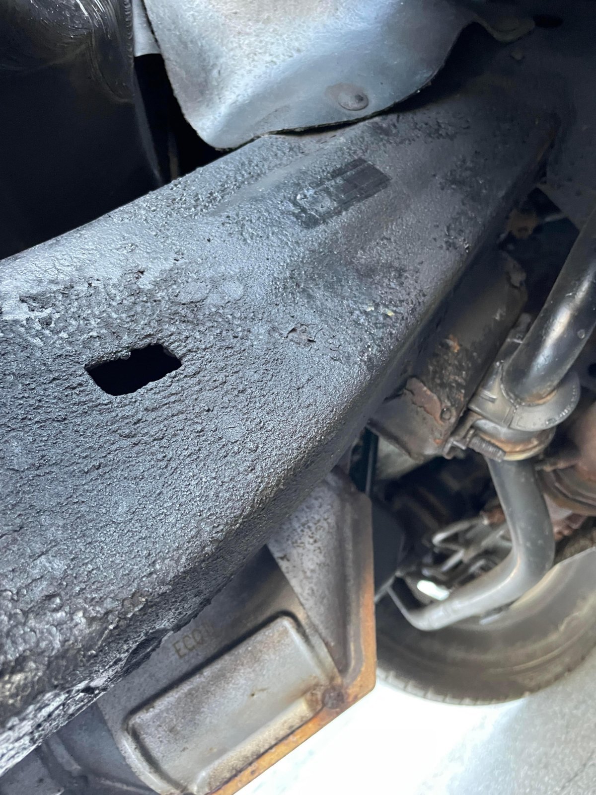

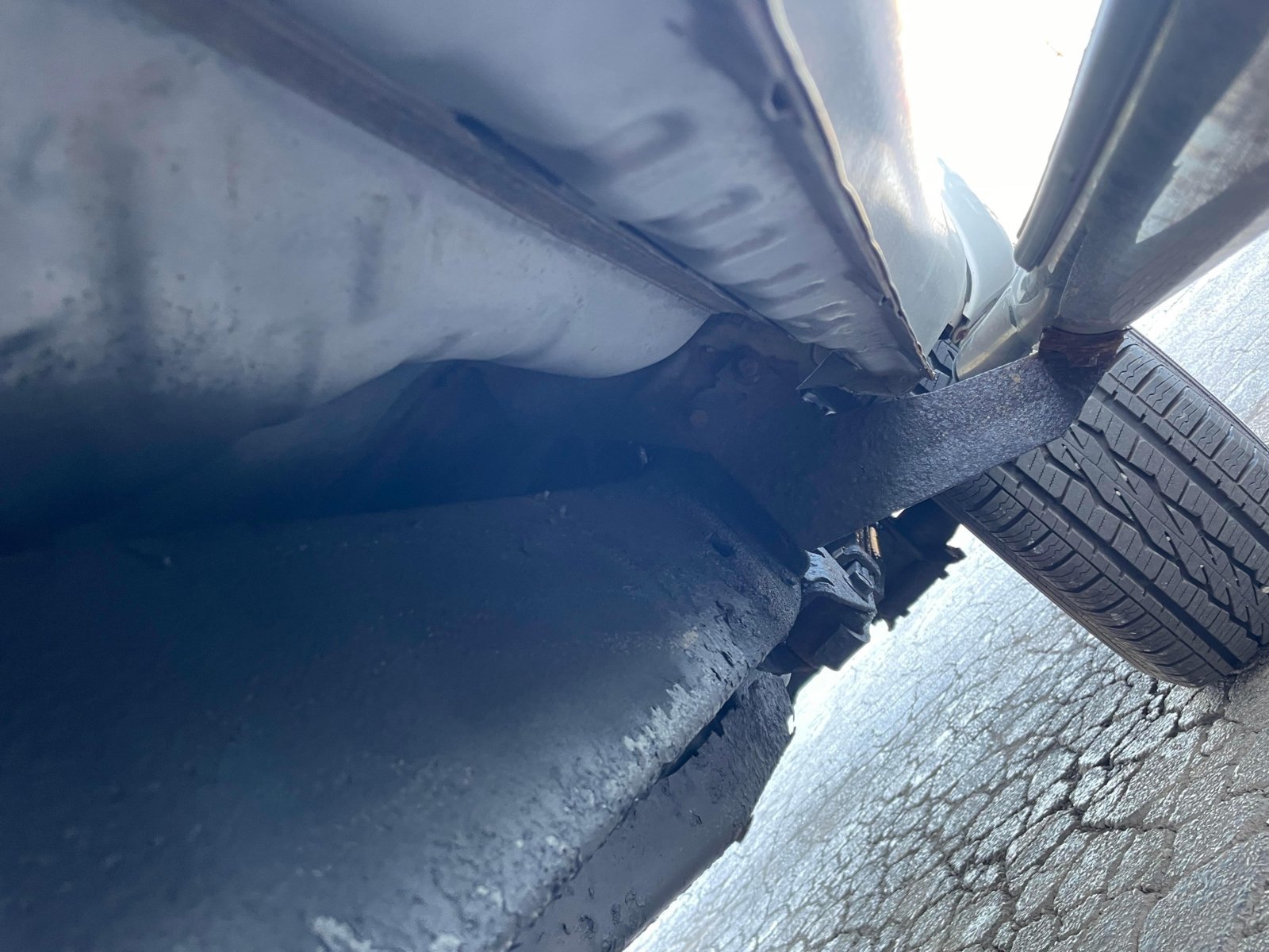

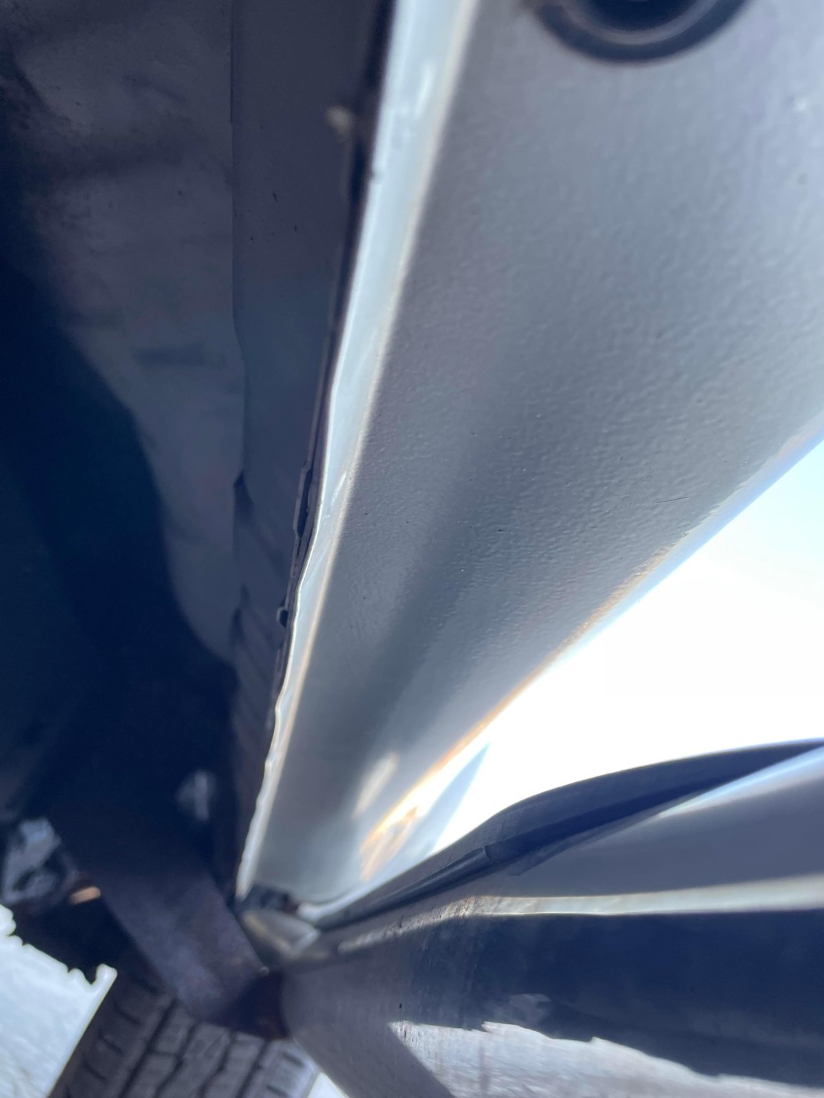

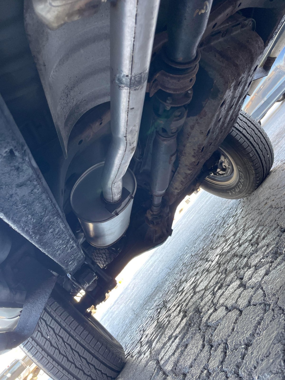

    New to Tacomas and was wondering how this 2004 frame looked as far as rust and overall structure goes. Seller said he power washed it and spray painted it. Thanks in advance. IMG_3166.jpgIMG_3165.jpg IMG_3164.jpgIMG_3163.jpg IMG_3162.jpgIMG_3161.jpg IMG_3160.jpgIMG_3159.jpg

    It looks painted. But it appears solid in the pics. If you tap questionable spots with the metal end of a screwdriver, you’ll know if its soft or not. It will have a dull sound instead of metal on metal “tink”

    I've seen worse but it's not great, hammer test it for sure, especially around the rear shock hangers and leaf spring mounts.
    I've always considered the gas tank skid as a good indicator of how bad the rust is.

    Some of you aspiring Tacoma owners can't be that desperate. The frame is toast....If you really want a used Tacoma look in adjacent States where you aren't apt to get frame damage
    from road salt. Hell, that thing looks like it spent some time in salt water. Maybe it did!

    As others have suggested, HAMMER on it. Thing is definitely paint over rust. Plain to see.
    Personally I'd pass on it but it's a regional thing so I'll just wish you the best of luck in your search.

    Looks mostly like an attempt at Woolwax/Fluid film mixed with spray painting - OR - that could be flaking rust, as mentioned hammer test. If it's surface rust it can be scraped and woolwaxed.
    The gas tank guard is pretty telling, I'd replace that if possible but you can see the edges are starting to go.
    Hard to tell by the angle but would be most concerned here, it's probably got the dull rust rot clunk around the circled area.
