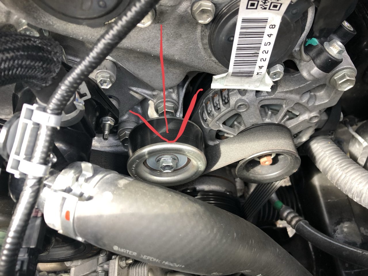

    Yesterday I was cleaning my truck and I notice the idle pulley wobbles a little , in my experience it should be firm . Do any of you guys have the same problem ?

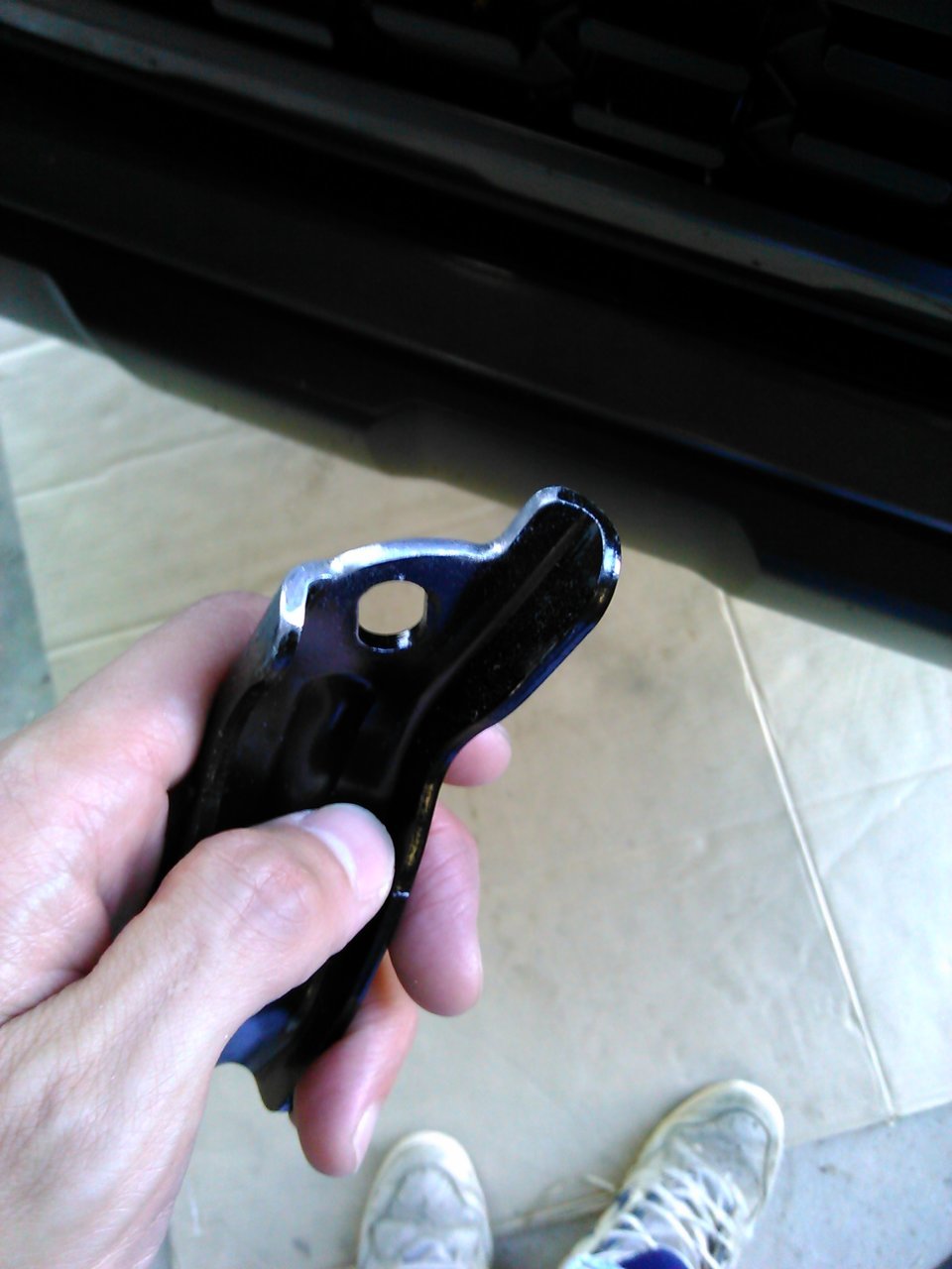

    I believe there is a TSB out there for this. Mine is a bit discolored on half of it that I forgot to mention to the dealer during the 15,000mi visit. I will have them take a look at the 20k.
    Also, keep an eye on that coolant hose with the braided cover that is on the left side of your pic. As it ages a bit, it will start to rub the flange on the metal bracket behind it. Mine had clearence when new but started to rub over time. It is very easy to trim the flange back a bit.

    That's a great point about that bracket, it was touching on my truck so I ended up grinding some metal off and repainting it.

    :hattip: Thanks!
    I did the same a couple months back after noticing them touching for the first time.

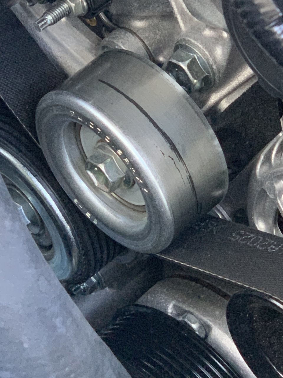

    Yea mine has the same issue! 2019 and only 470 miles on it.

    Here is the bugger with the same issue!
