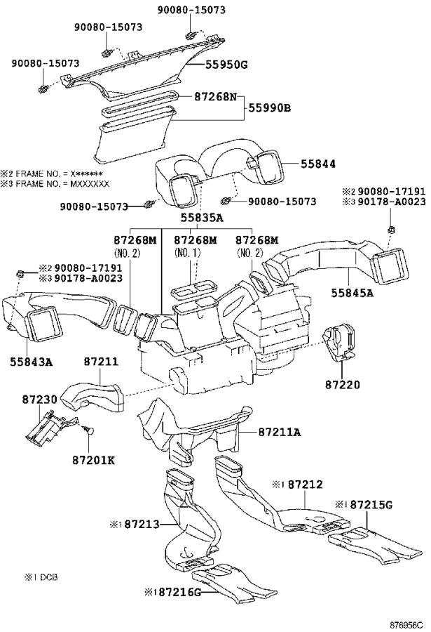

    Check the hvac box to firewall bolts and check the blower motor.

    THIS. Thank you friend, I will add this to my list of things to try and will report back to you all. I very much appreciate this. Let me clarify please:
    i) so the bolts/fasteners from hvac box to firewall - by hvac box do you mean the black blower motor behind the glovebox ? or is there something other than the black blower motor I should be looking at
    ii) Do you know if these bolts are accessible without me taking apart the dash down to the sheet metal? In other words if you see in the video, I took everything off that doesn't require me to remove the deepest gut, but if I have to I will
    iii)) blower motor - so far Ive tried all settings, hot and cold, recirculation, defrost, etc. etc. etc. and the motor is dead silent. What should I be looking for here?
    Thanks again

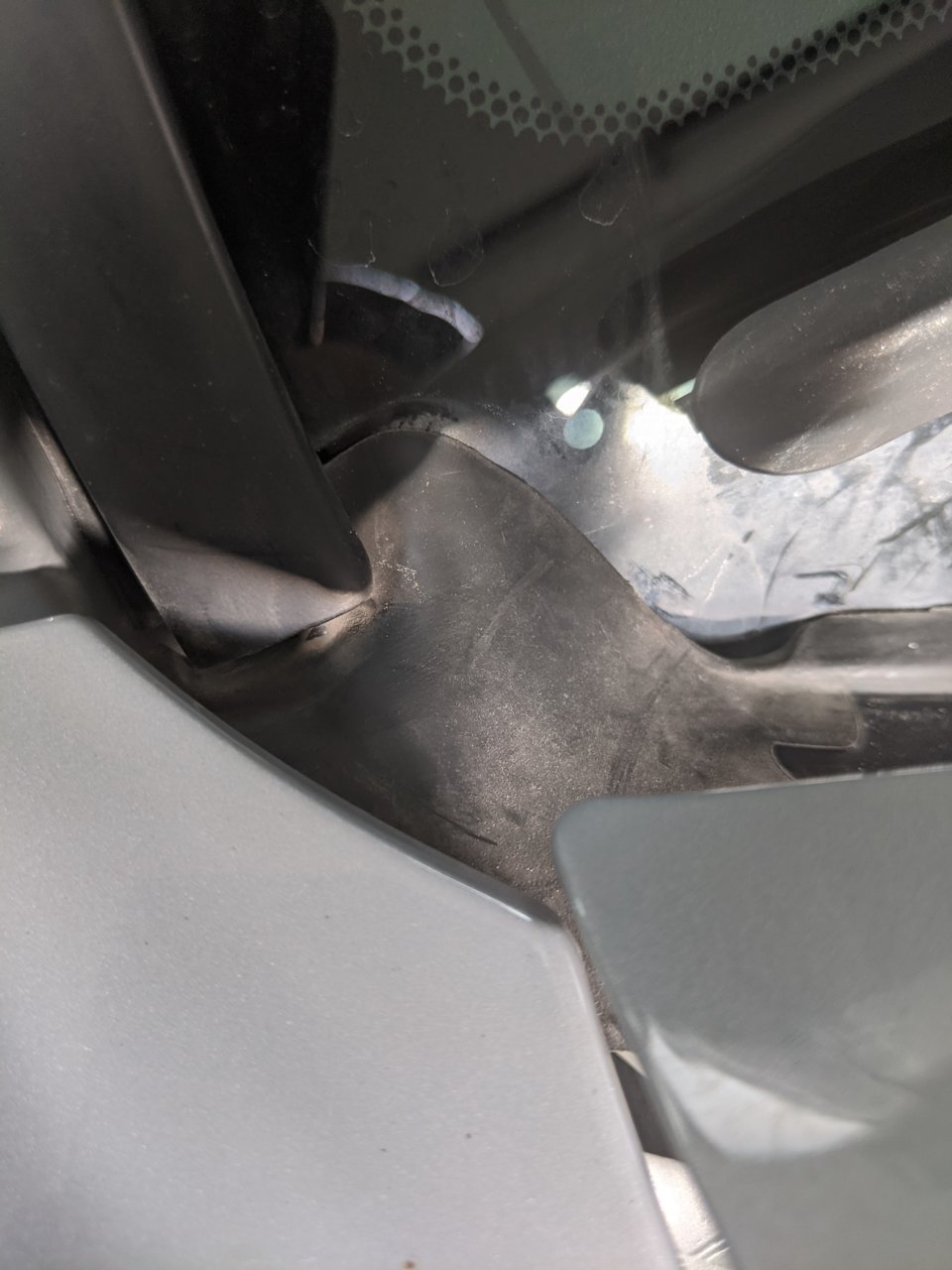

    This is great thank you. Can you please help me to understand more. The picture you've shown - is that correct way everything should be, or is it the incorrect way?
    Another person also told me to look at the windshield/cowl/firewall interface, so I want try what you've pointed out, just want to make sure I know what I'm looking for and how to fix it.

    The blower motor bolts in bottom of ac box. Remove blower and test drive.
    Hvac assembly bolts directly to fire wall some times bolts are on engine side. Don't know bolt location on tacoma yet.
    Try to move Hvac assembly blower side by hand.

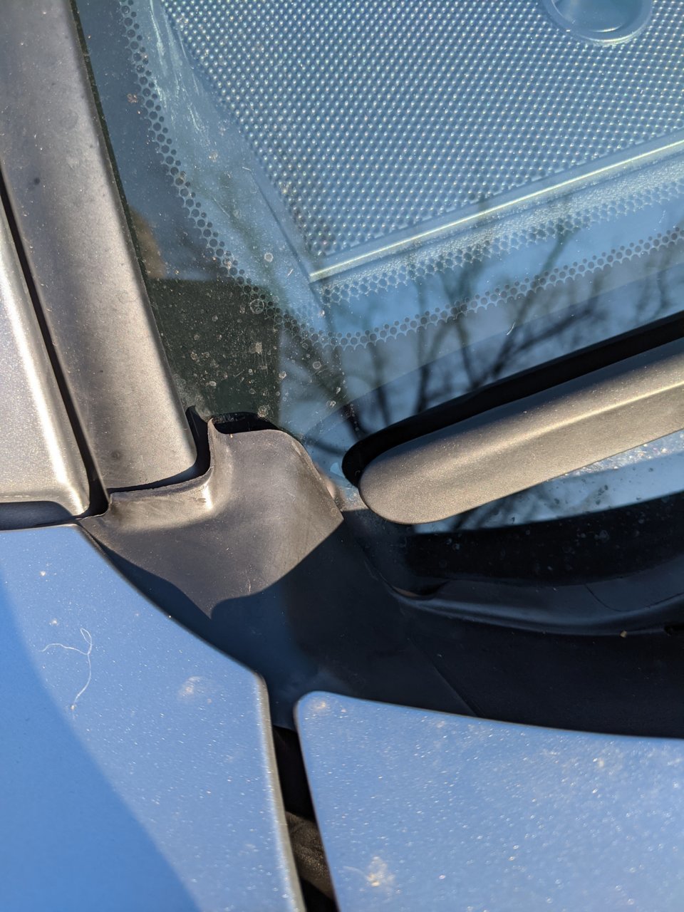

    Mine looks like this on both driver and passenger side. Which one is the correct way?

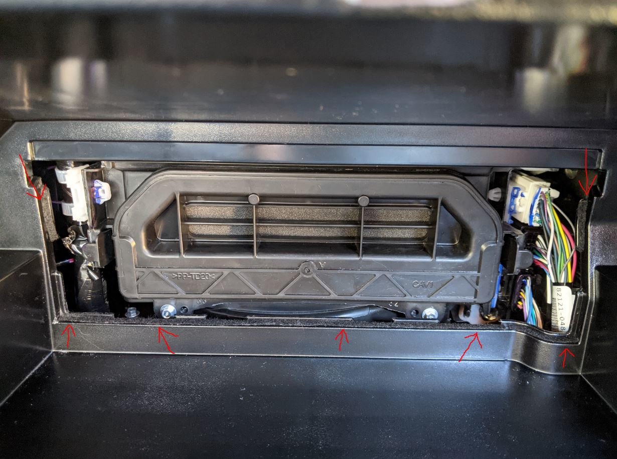

    Also, I just found that my cabin air filter door and even the filter itself could rattle. I felt lined the edges of the cabin air filter door and stopped the free play. Hopefully that works for me!

    Just did a test drive and I think felt taping the edges of the filter door in the glove box finally solved it!
    It's about 55 degrees where I am at. I'll have to wait for a cold morning drive to verify if the rattle goes away for good.

    Thanks kindly. Yes my windshield and cowl interface looks the exact same as yours, so I'm hoping that's the right away.
    Also the cabin air filter and filter itself I will check. THanks again

    Wow thanks kindly. Diagrams like this make me feel warm and fuzzy inside. I will try what you've suggested and report back. I really appreciate this post.

    On my truck one of the rubbers was sitting freely like the quoted picture and one was under the metal trim of the vertical trim of the windshield... I was getting noise from the one sitting above so i put both under vertical metal trim and noise went away. May not be the solution but it did stop a noise i was hearing while driving.
