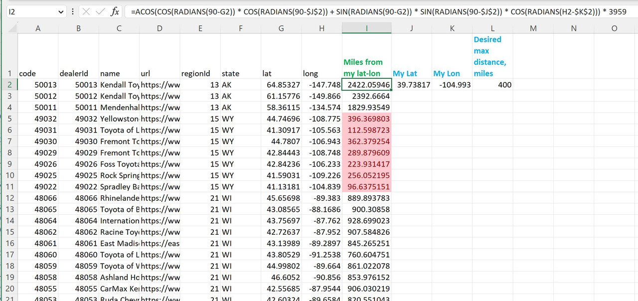

    Here's how you can get a distance calculation between dealers and some fixed point you enter:
    Get the nationwide dealers spreadsheet here:
    https://flatgithub.com/kissmygritts/flatdata-vehicle-inventory?filename=dealers.csv
    Download the csv file (lower right, click on csv with download arrow) and open it in Excel, save as xlsx file.
    As of 3-28-23 this file has 8 columns (A-H) and 1203 rows including the header row.
    In cell I1, type: Miles from my lat-lon
    In cell J1 type My Lat
    In cell K1 type My Lon
    In cell L1 type Desired max distance, miles
    (see screen grab at bottom of this post)
    Then go to google maps or any other tool where you can get lat-lon coordinate of your location, or some location that serves as the hub for the mileage measures (https://www.google.com/maps)
    Move to your desired location within google maps and right click to get the lat-lon coordinates (in the US the Lon will be the negative number)
    Enter those coordiates in the excel file:
    (Example of a post office in Denver)
    Enter 39.738165 in cell J2 (under My Lat)
    Enter -104.993341 in cell K2 (under My Lon)
    Next, copy and paste this formula into cell I2:
    =ACOS(COS(RADIANS(90-G2)) * COS(RADIANS(90-$J$2)) + SIN(RADIANS(90-G2)) * SIN(RADIANS(90-$J$2)) * COS(RADIANS(H2-$K$2))) * 3959
    Then hover over the lower right corner of cell I2 and double click it to fill this formula down into all remaining rows.
    Once you have this you can sort the list by column I (miles from your entered location) or you could apply conditional formatting based on the desired max distance in miles that you enter in cell L2. To do that, click on Column I to highlight that entire column, then click on "conditional formatting" in the Home tab, then "Highlight cell rules" then "less than" then click your mouse in cell L2, then click OK.
    You can now change cell L2 to whatever value and the cell highlighting will change accordingly.
    Screen grab after doing the above:
