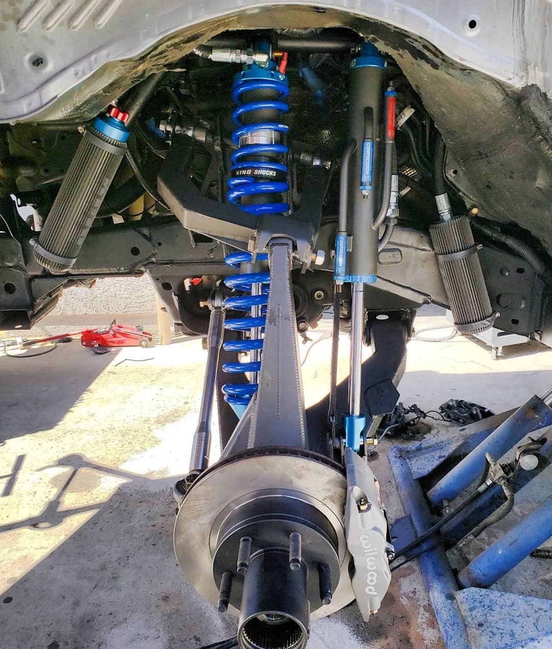

    10” shocks and a nice tower / engine hoop would be good for a multipurpose rig.
    Adding things like swing steer, big shocks, and big travel numbers would be a strange compromise to stick with 10” stroke since you would of course be having big travel numbers and the same or a bigger shock setup in the rear which wouldn’t be well suited with that setup in front.
    Lots of mid sized trucks will use a cantilevered booster, manual, or hydro assist brake setup when stepping it up to 12” shocks on an a-arm or 16” shocks on a beam platform.

    Not sure why you say the brake kit - we run factory brakes with Dana hubs just machined down to run the rotors.
    I would agree with the factory hubs. Custom axles kind of are sketchy except for the case of buying $4k+ for a spare set or at least one spare unless best case scenario you rebuild on on the trail and don’t get any random damage to the shaft. Planning on buying a $1200 spare since I’m in that boat myself. At least with one side factory you can keep things relatively easy to have backup parts or make a cheap limp-home spare with an extended shaft from like a BTF kit that won’t allow the full travel.
