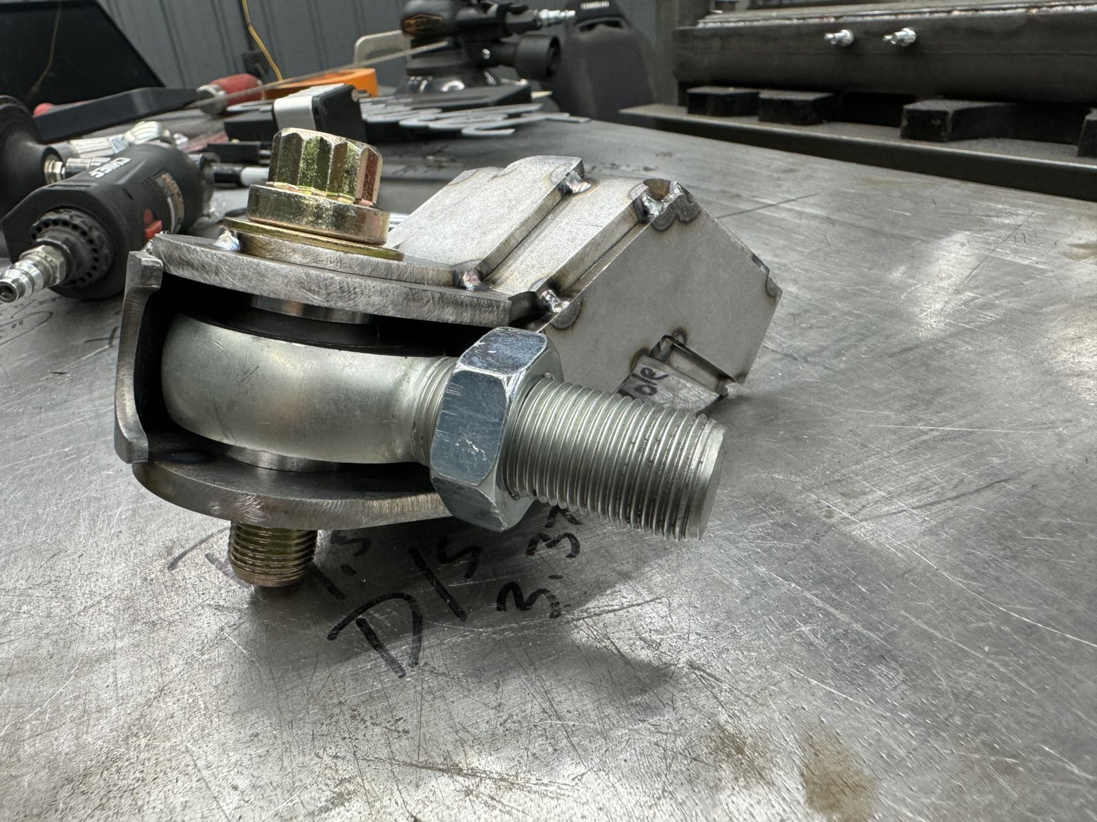

    I should really add & swingset steering to the title.

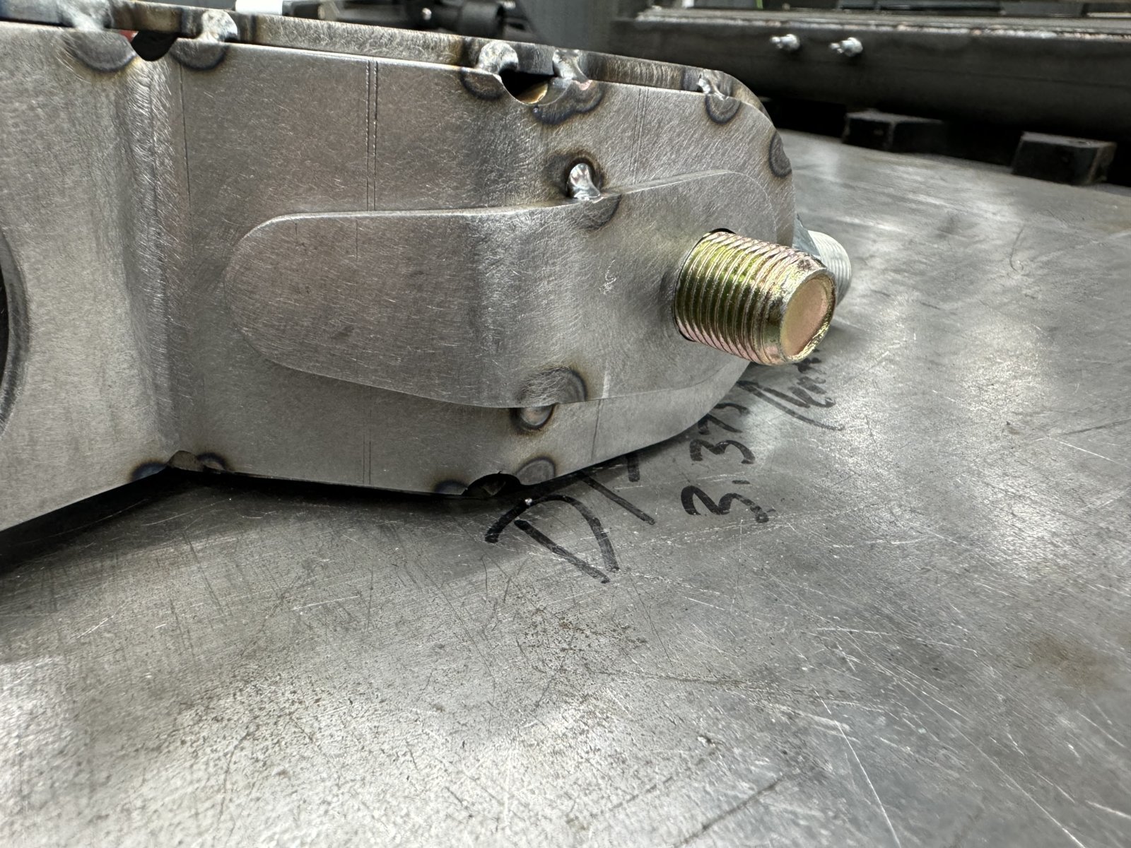

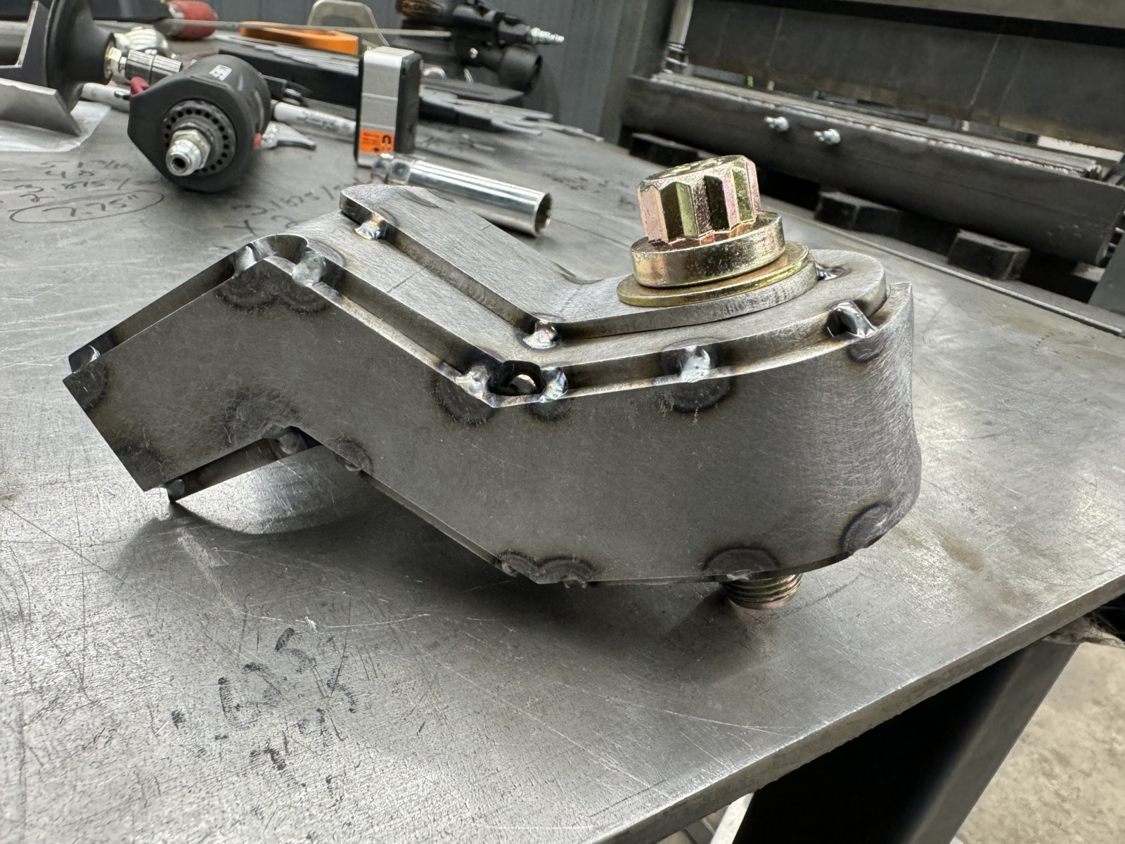

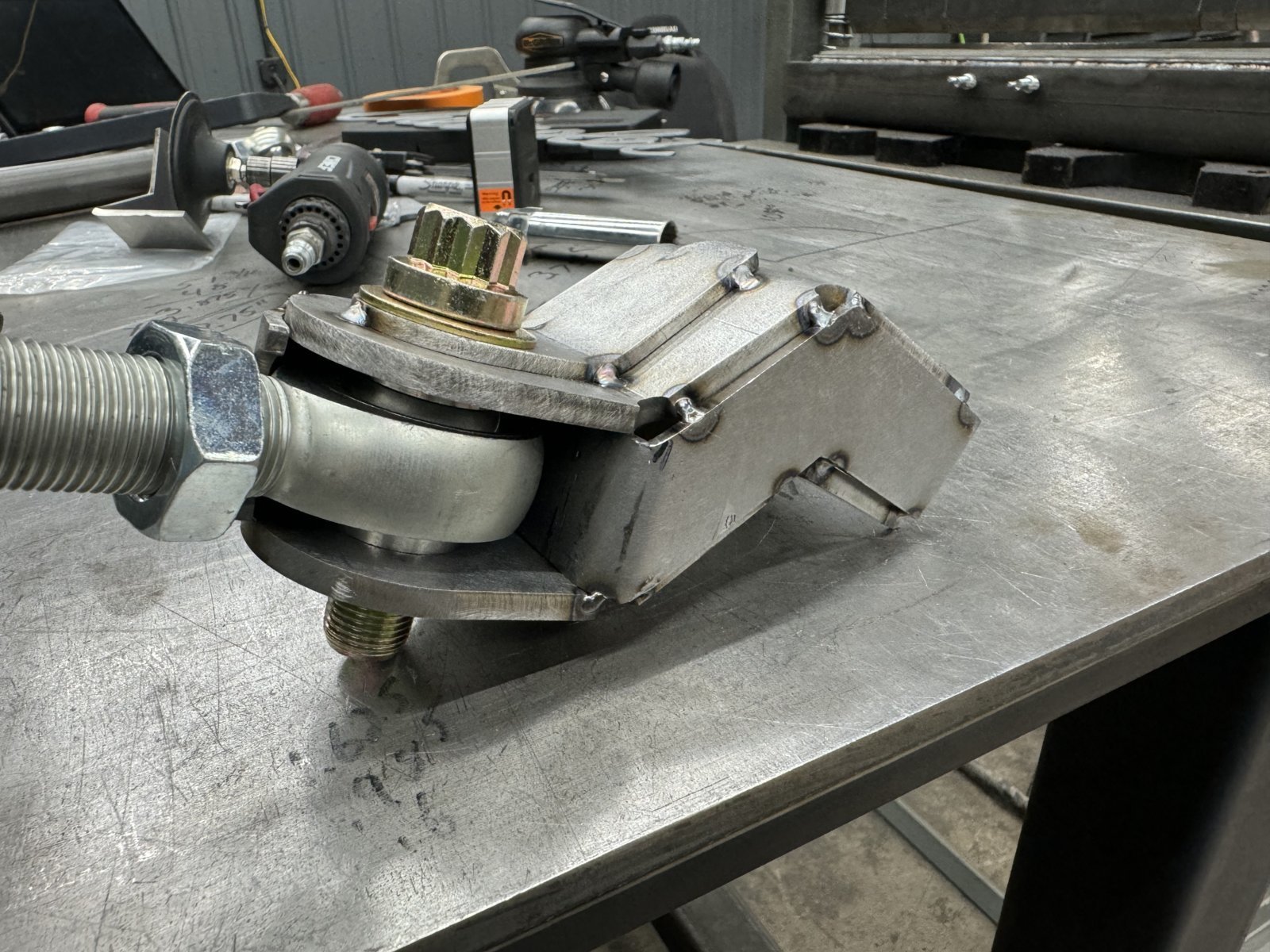

    Anyways here is the pitman arm ready to be finished.
    Getting super close to being done with this steering!

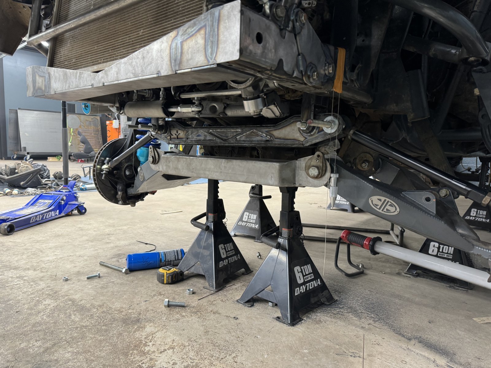

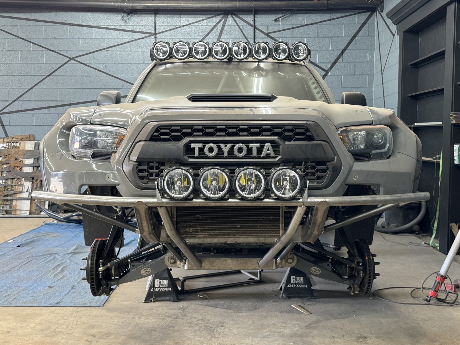

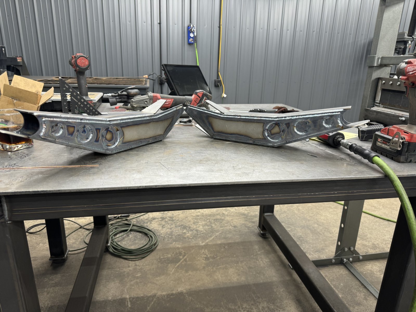

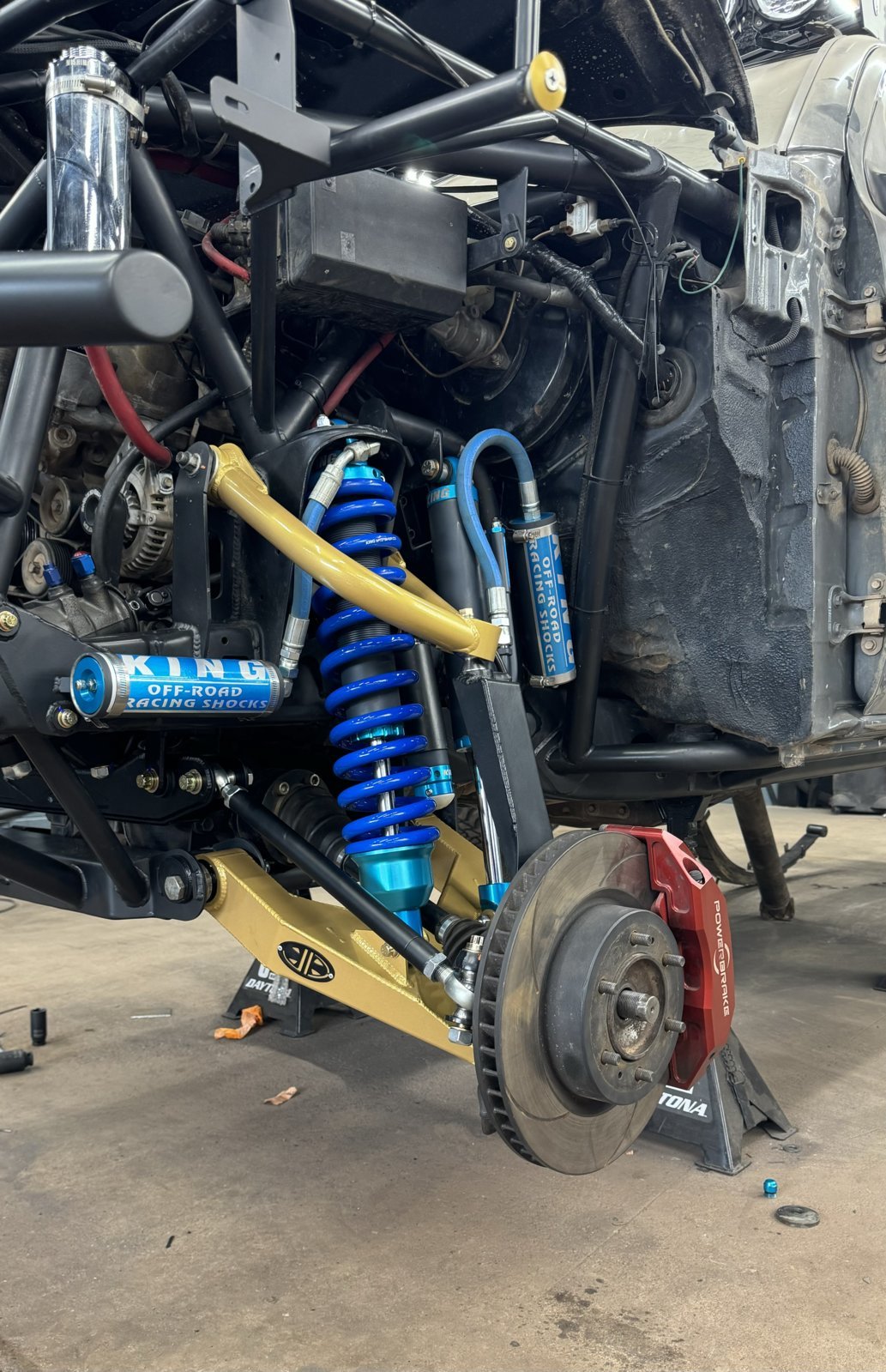

    Truck is really coming along. Beginning the early stages of final tear down now.
    Wrapped up the bumper today minus the push bar. This was done with my weld on frame horns. Pumped with how it came together!
    These will be available for sale shortly. Bolt on version included!
    Not much longer and swingset testing begins!

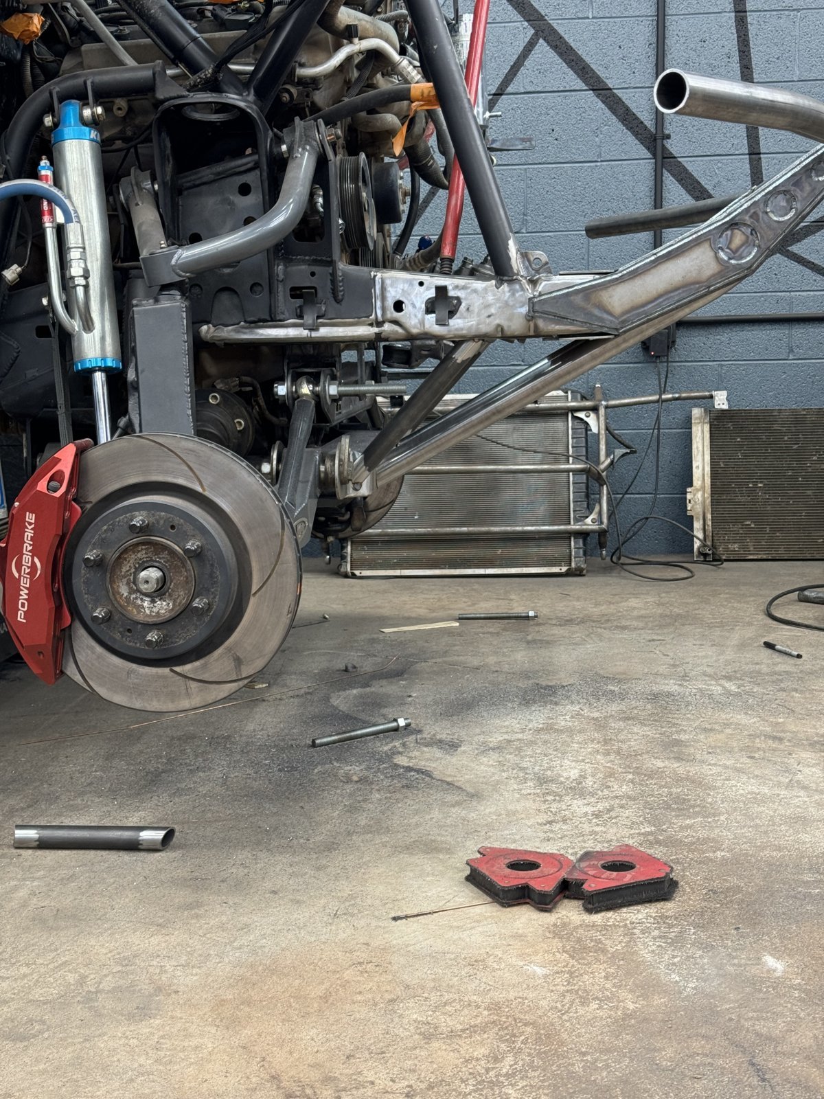

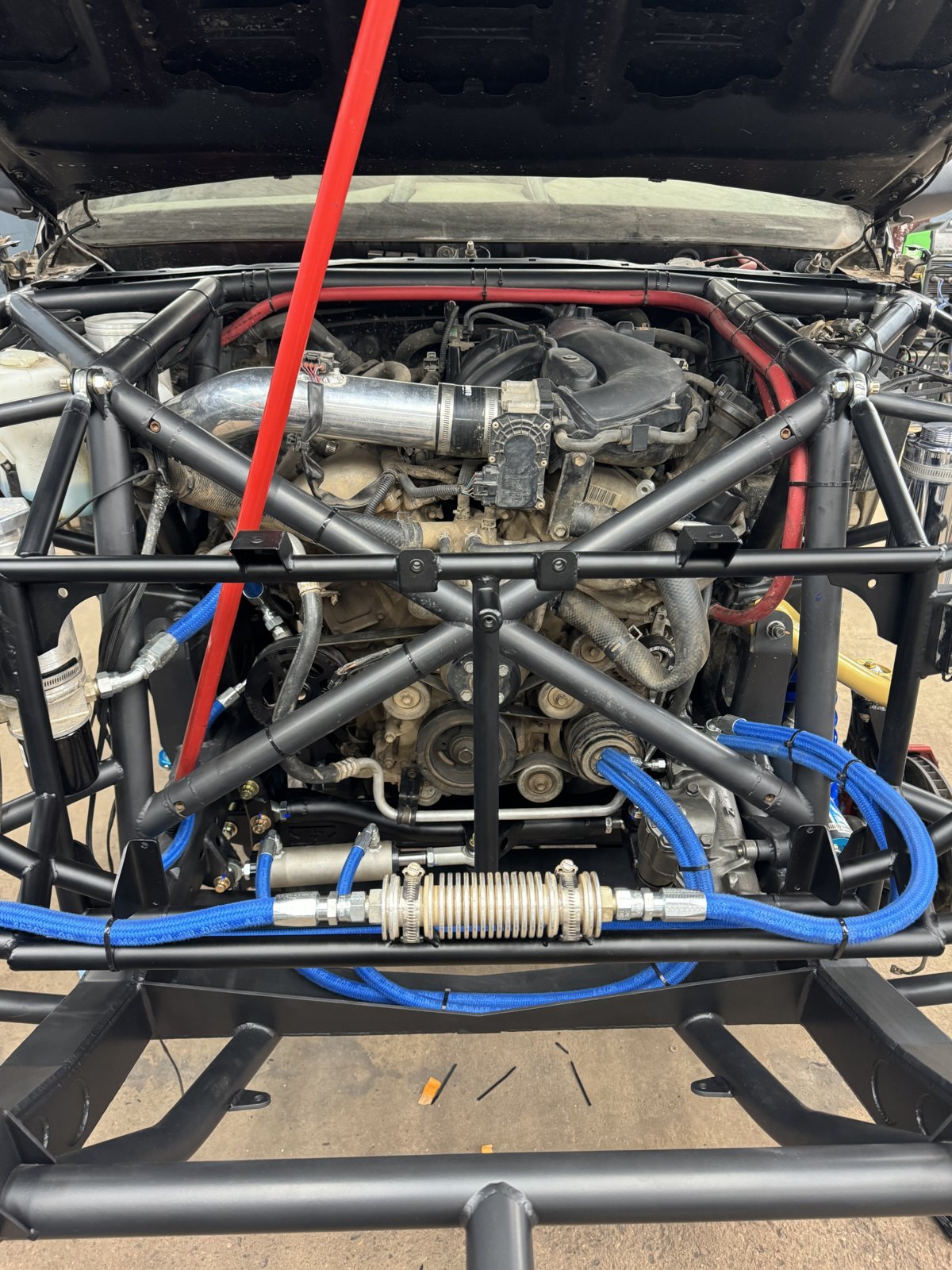

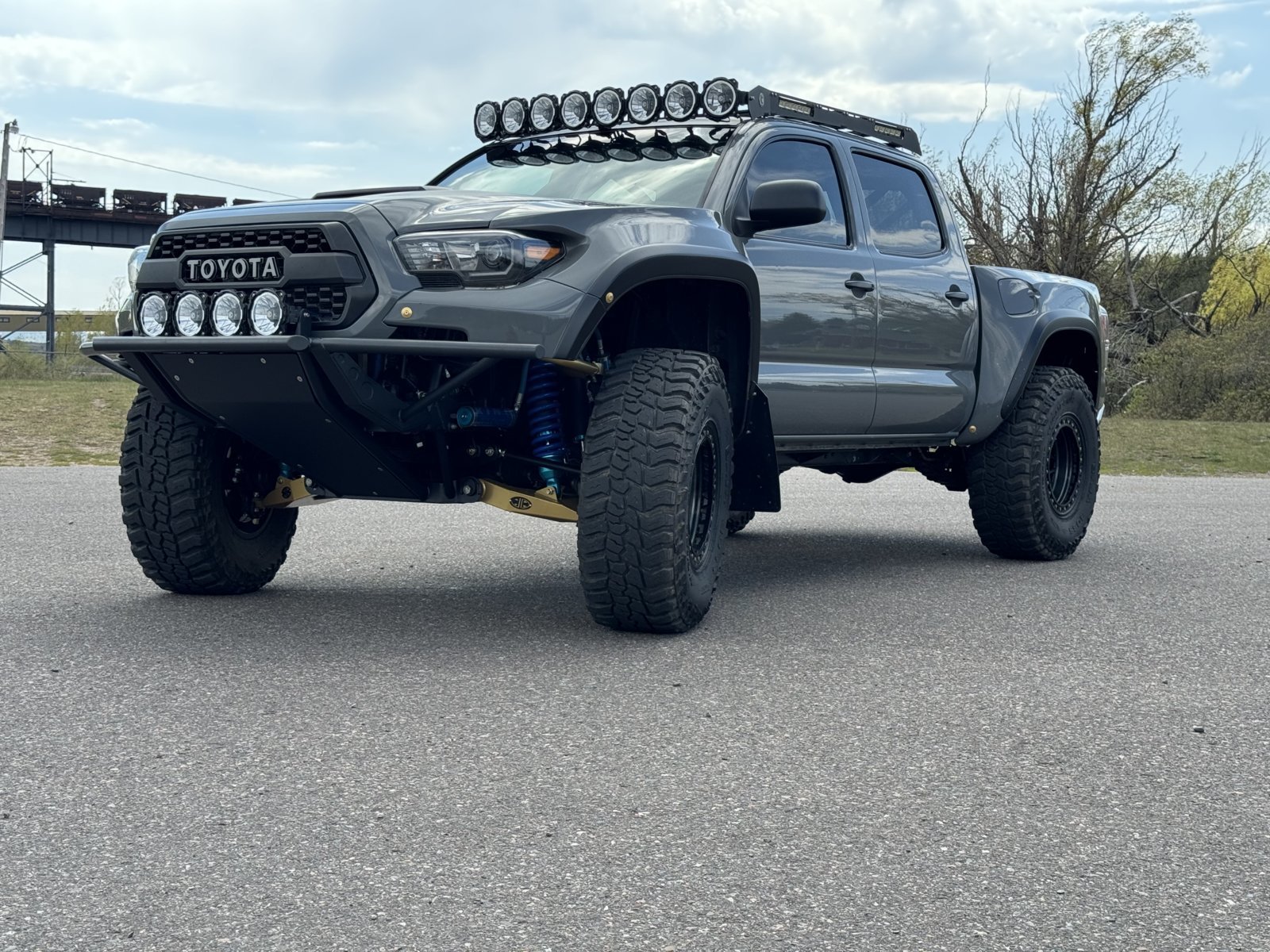

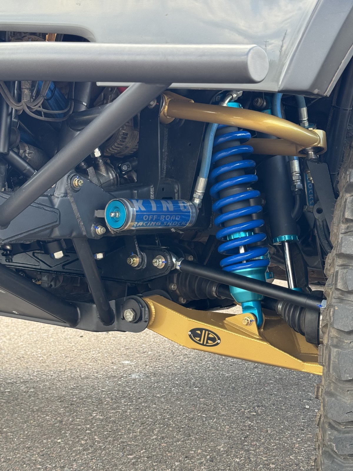

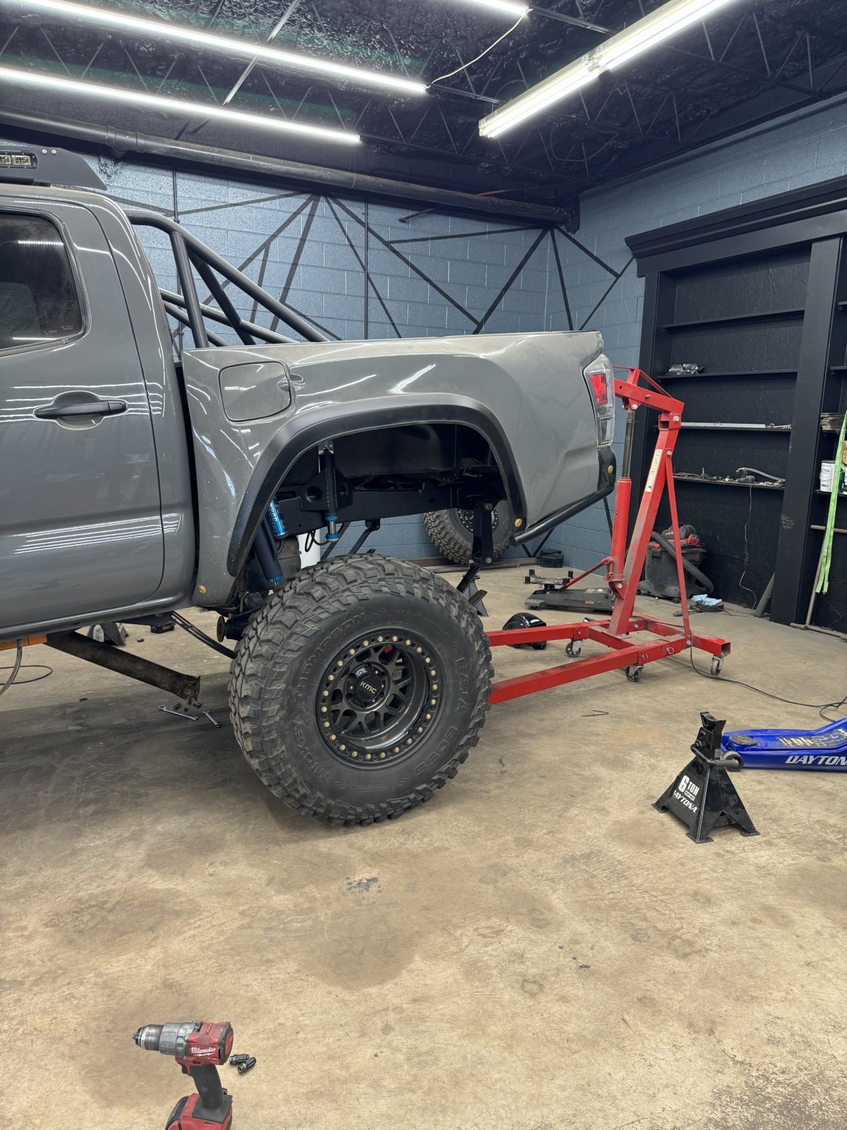

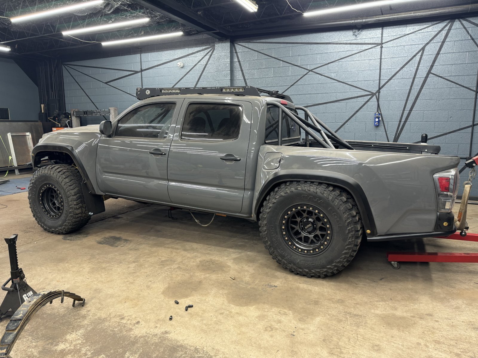

    Well guys. She’s back on the road.
    The steering is going absolutely amazing. I can’t even begin to say how proud I am to have pulled this all off!
    We also made some big changes in the rear. Moved the front hangers and built our own rear hangers. Pulls 19” metal to metal on a 14” shock. The shock is the only limiting factor for even more.
    Every year we push the progression of this truck harder and harder. It develops my skills more each time. Without challenge, there is no progression.

    Cool project. Curious about the details. How's the diff mounted? Are you still using the factory diff mounts (bolted under your new crossmember)? I can see the centerlink and its swingers. I can see the steering box and pitman arm go to a drag link with ram assist. I don't see the centerlink and drag link connect anywhere. Curious to see how you went about it. How's the steering angle?
