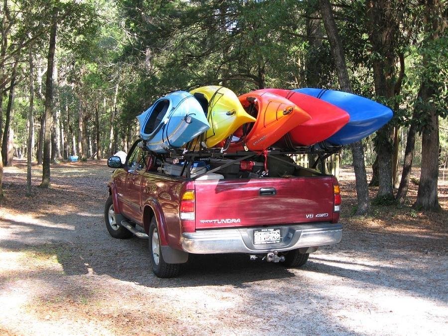

    J hooks on my old tundra. Have not put them on my taco yet. Do not get the 10 footer, go for at least a 12. It will track so much better.image.jpg

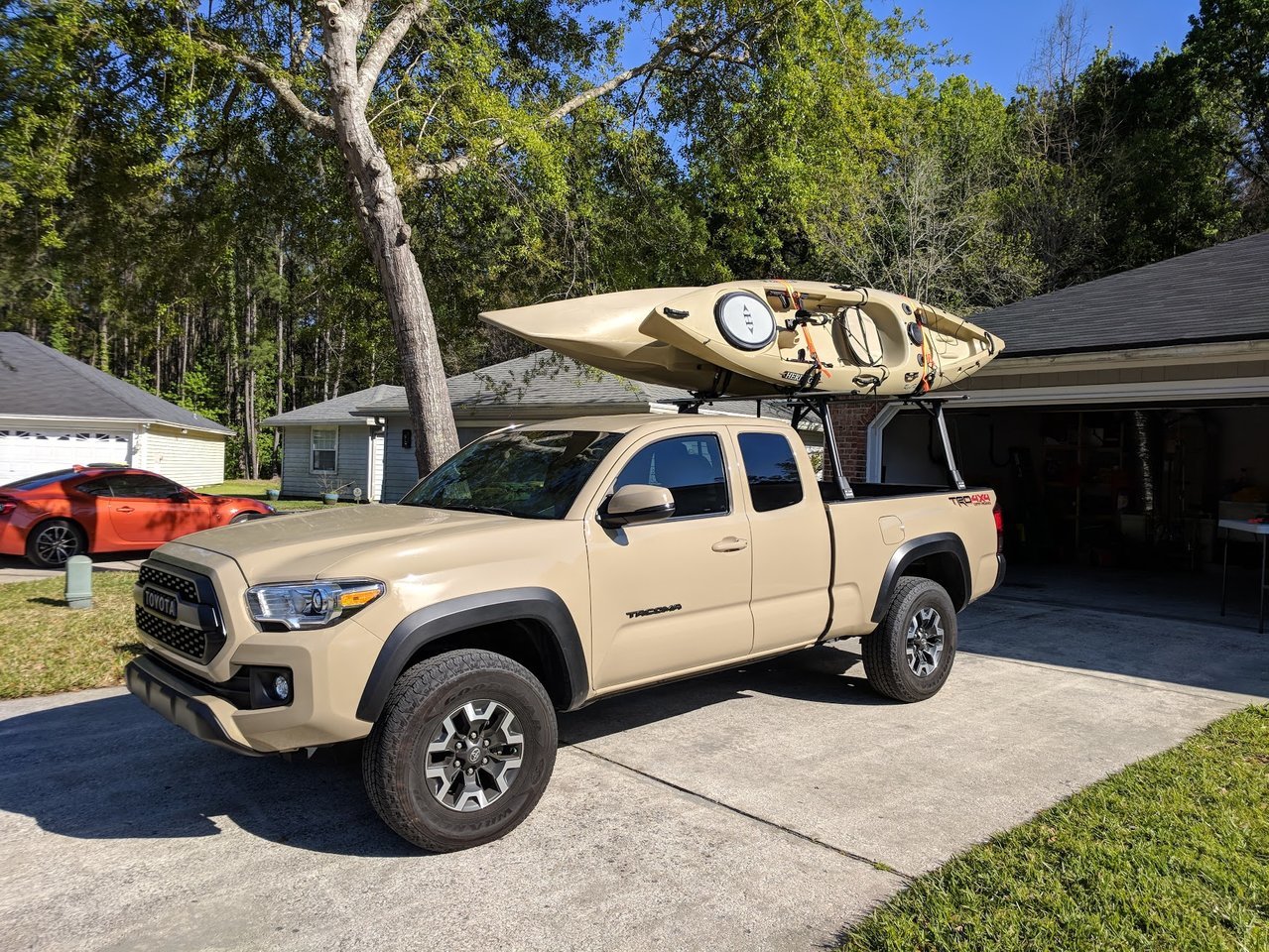

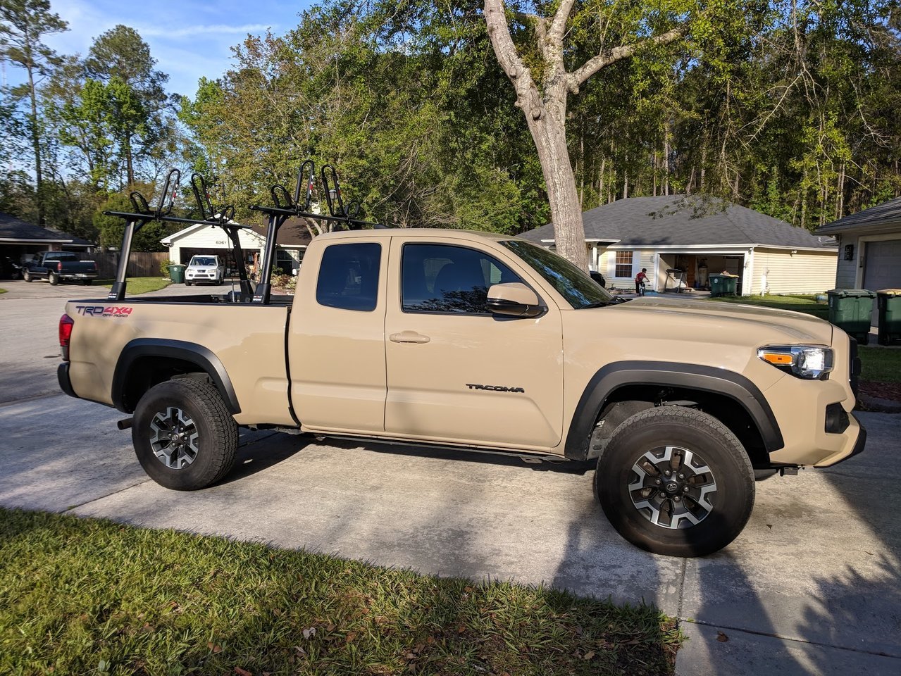

    Ordered the ROLA truck rack and 4 J kayak racks the other day after reading this thread. Spent most of today assembling and test loading/unloading them. Work good so far.

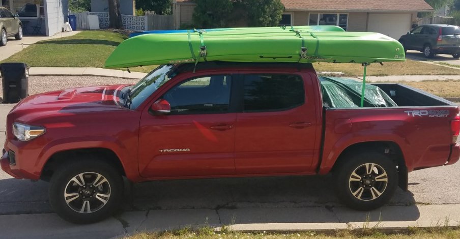

    I tried the J rack with the OEM roof rack and I was not comfortable seeing the kayaks shaking at highway speeds right in front me, because of how the cross bars of the roof rack are set into the "rails" they can pivot a little bit. This is my first Tacoma so that pivoting scared me a little bit. So I just mount the kayaks directly in the OEM roof rack, no more shaky shaky in the highway and it works just fine, made a 1000 mile trip with the kayaks on the rack to the Canadian Rockies at highway speed up to 90 miles/hr sometimes and no issues at all except for the noise maybe but you will have that anyway. One is a fishing 12 footer and the other one is a regular 10ft, both cheap ones so maybe that is why I don't really mind putting them directly on the rack... and upside down.

    What brand kayak J racks did you use with the rola rack? Also did you have to modify them to fit?

    I used the ROLA brand J racks. I bought the ROLA rack and 4 Rola J racks from Etrailers.com. Everything just bolted together.
    Also, I bought the hoodloops but just didn't like the idea of them against the paint. I decided to do just what @gator2764 said. I used a ratchet strap to also tie the kayaks down to the bed tie down. It worked well and I feel better about it.

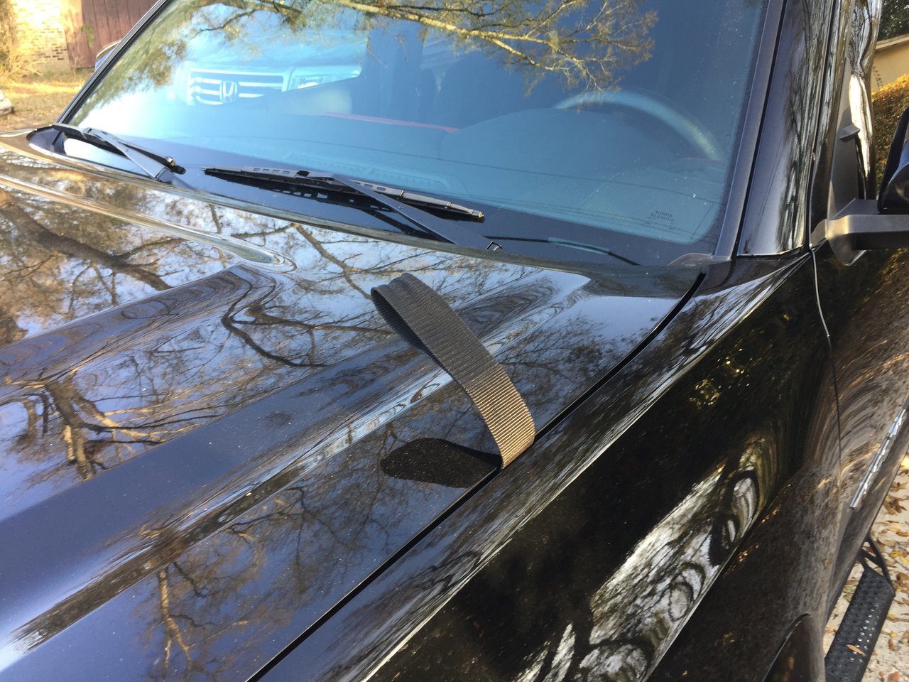

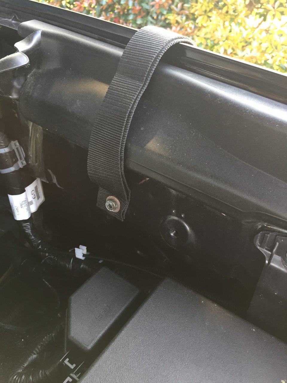

    Another way to tie down bow strap is to attach a web strap to inside of fender. I have one on each side of hood. Holds a 17ft canoe securely without ropes touching paint.
