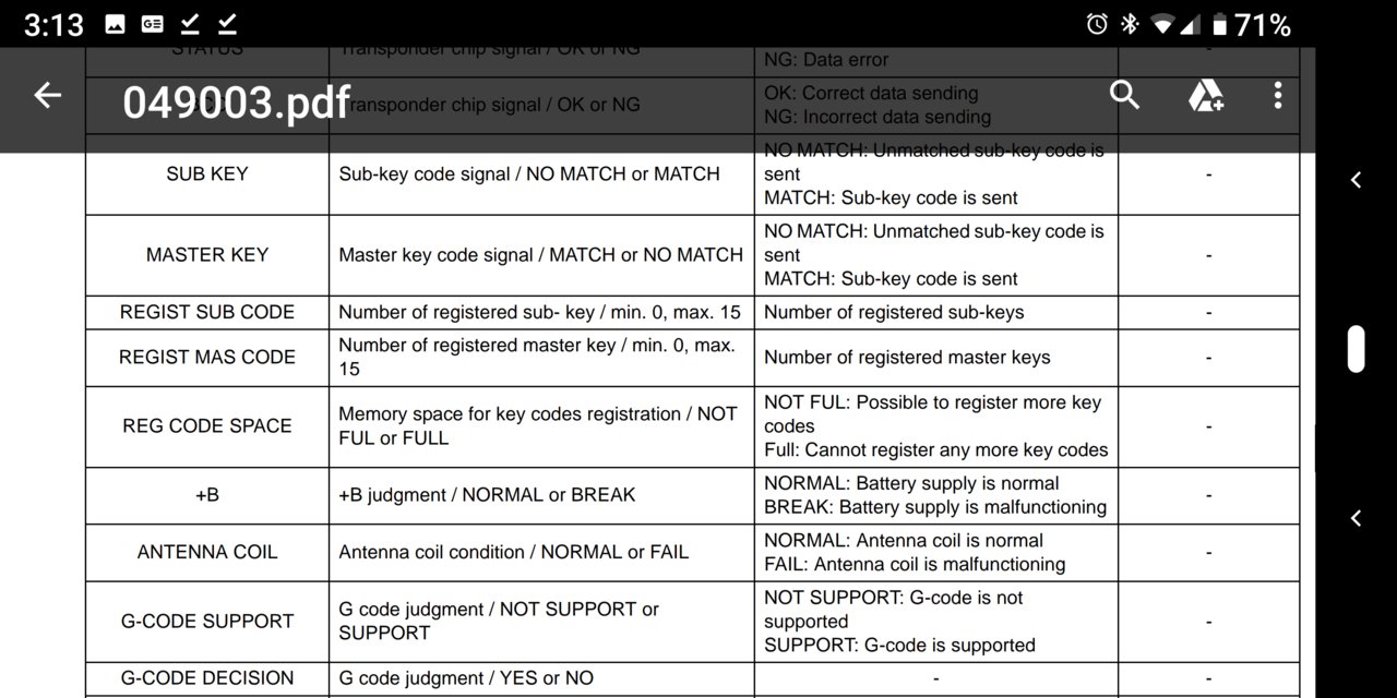

    Found this in the FSM. Interesting...
