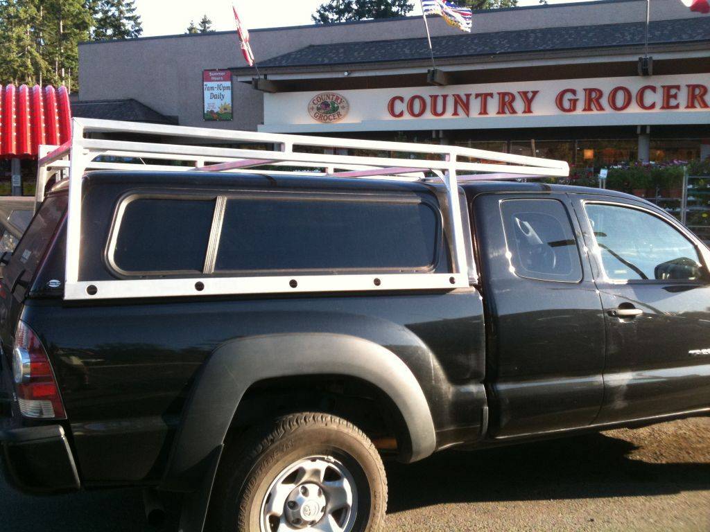

    Yeah man , tons of custom aluminum racks up here

    That's cool ^^
    But why not just do a fixed front and rear hoop , that will provide more strength for the cab over portion

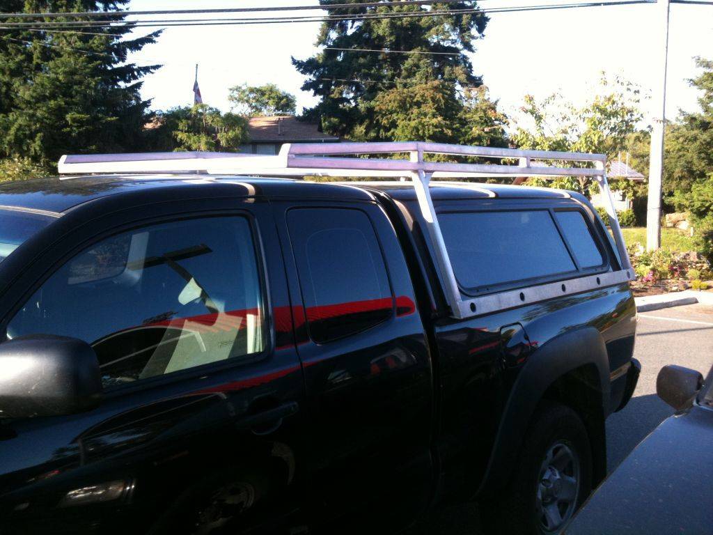

    Like this
    or this

    Easily removeable and strong , yes

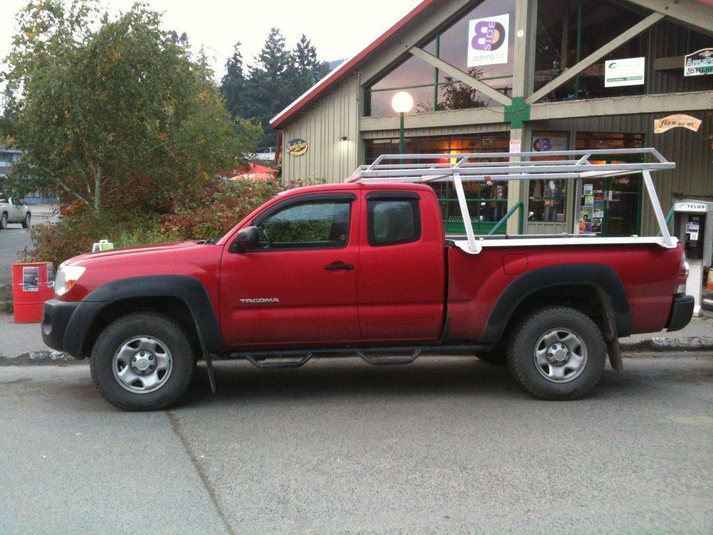

    Or you could go to a nested , removeable rear hoop like this

    I do like that idea! Simple, yet satisfying

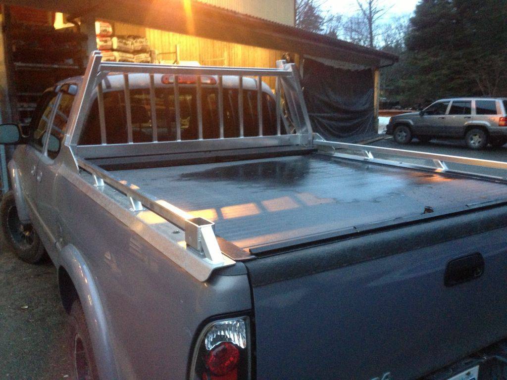

    You can just get a $400 headache rack and haul 20's up over the cab like my old headache rack

    You can haul 20's and serious weight with just a headache rack and you negate the risk of the load coming down on the roof
    Load it like this
    With this
