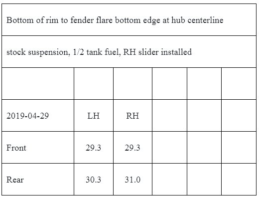

    Left side is 110 lb heavier before people, cargo, and fuel are added. Difference is mostly in the front. Note 21 gallons of fuel would add another 125 lb. The stock spring on the driver's side is stiffer to compensate. If you install aftermarket springs/coilovers of the same P/N, the difference can be drastic before you adjust preload.
    My truck on stock suspension, but with a rock slider (~60 lb) installed on the passenger side. Front was even. Rear was 0.7" lower on the driver's side:
