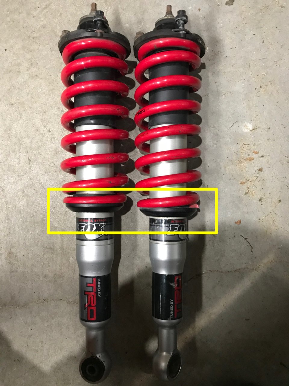

    Correct... it's obvious on the pro suspension, which is labeled left and right, because they're side specific.

    The pro shocks are a little different. I think the springs are the same, but the collars are placed a little higher on the driver's side. The collars also have a L and an R label on them too.

    Correct, one is using different coils, the other is utilizing preload. The point being, Toyota has asymmetrical coilivers to combat the weight difference/Tacoma lean.

    I have done all of these, including measuring spaces between coils. Absolutely identical.
    You can have them to study.
