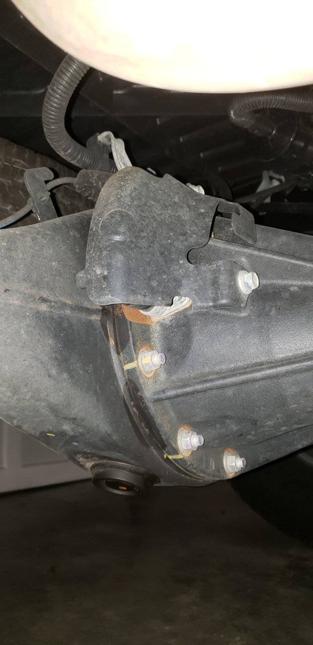

    I know there is an existing thread about rear differential recall from the early 3rd gens. There are also a few other threads on the same issue. Some of these photos are a bit similar to mine. I just came across some accounts of rust in new vehicles (not the Taco) and was just checking when I saw what I thought were oil stains in the differential. I immediately searched and the prior posts came up but no reports in 2021 models (or if I missed it, I apologize). There are no stains on the garage floor. Bought the vehicle in January 2021. The closest thing to off-roading was running down gravel roads on a couple of farms, otherwise 99% on pavement thus far.
    I am coming up on my 10K service - should I bring this up with the dealer or wait and see if there is any change in the "staining" or "weeping" and bring this up later? Should the dealer be able to flag this with their inspection? Or is this what Toyota considers "normal"? Appreciate any feedback - if there is a related thread in 21s I would appreciate the link but failed to find in my searches. Thanks.IMG_5486.jpgIMG_5487.jpg

    Just have them document it. Lately if it's not dripping on the floor, it's a seep which toyota won't fix. Had mine fixed but it came back after 20t miles. I Wiped it off and has been clean since then.

    Have toyota document and torque down the nuts to proper spec (and verify at home that they did).... unless its dripping on the floor dont worry about it after that.

    Def let Toyota document it. Alternative is to pull it off and reseal with RTV, not that hard, took me about 3 hours to install a new third member. Not sure if that voids warranty, just throwing out ideas

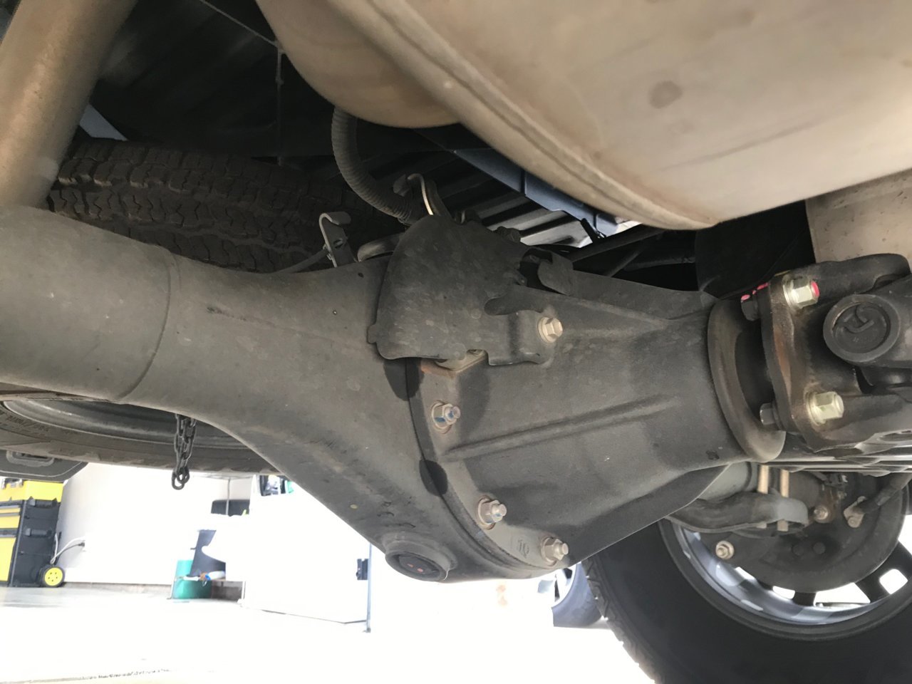

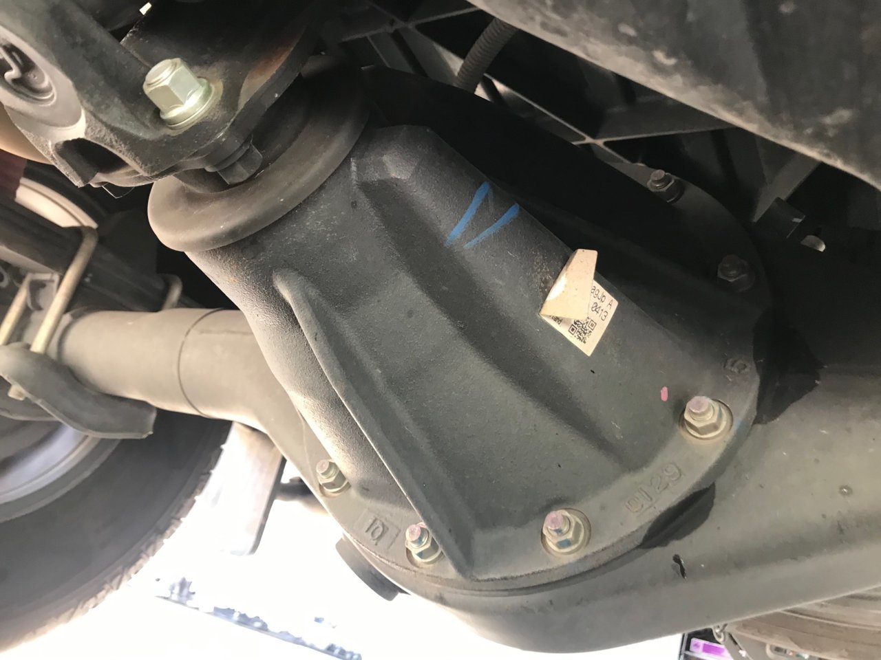

    Not a '21 but guess what I noticed the other day with mere 6,600mi on the clock on my '20? Going in to get it documented with local dealer next week who will probably just snug up the bolts, rinse and tell me to keep an eye on it.
    Not super worried since it's a weep but if it goes beyond that, it'll be noted. I've seen posts on who got it "fixed" multiple times and each time it came back (or was worse). Not sure why they don't use a rubber gasket or RTV.

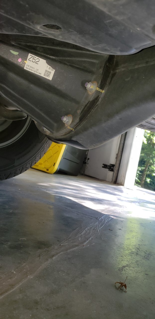

    Very similar to the pattern of "weep" on my rear diff. I already have an appt with a dealer for the 10K service and I indicated the staining in the RDiff in the "notes" section. I also sent an email to Toyota customer service, along with photos, just to have it documented in case others have contacted them. I also indicated the upcoming service visit. No response yet.

    All the pictures and prior posts have basically the same pattern of seeping in between studs. So they could very well be too loose, surfaces are warped, gasket not thick enough, heat differential between two surfaces causing temporary issue... etc.
    I have no clue why they use a gasket rather than rtv almost all other mfrs use. Not expecting anything extraordinary but I'll update after next Friday's appointment. If I had 60k it would be a different story but seeing this after 6k sounds like a bad design.

    You can bring it up with the dealer, but there’s always a chance they might over-tighten (just like they do oil filters) and strip one or more fasteners, so be vigilant if you choose this route.
    More than likely some of the fasteners got loose or were not torqued to specs. The diff breather and oil level should be checked (for overfill/under-filled) and adjusted if needed.
    I’m certain there are other ’21,'20,'19,'18,'17s like yours and maybe even worst just like on the previous recall.
    This is normal on all diffs on all make/models. This is supposed to be checked on all vehicles during regular maintenance but is often overlooked or dismissed as a minor annoyance.
