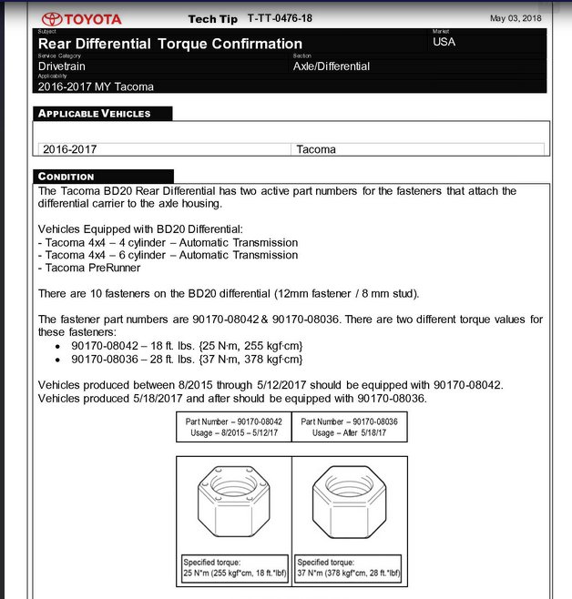

    What is the proper torque? Thx

    I believe it's still 18 ft-lbs which is not a lot but there are 10 bolts that provide that clamping force. Those that went good bit above that paid the ultimate price of snapping the stud off.

    It depends on you diff and fastener. See info below. But just as important use proper tightening sequence as outline in doc.
    Edit note:
     The correct torque value for the original nuts (18 ft.lbs) is
    different than the NEW nuts (28 ft.lbs) used when an oil
    leak is present."

    It's not exactly standard, but fasteners can get loose or torque tool can get out of calibration, or may need resetting after different model run on assembly line, but who knows why chit really happens, it just does to everyone at some point.
    And it's not a simple loosen and apply rtv sealant on this type diff. Axles, rear brake plates etc. and seals need to be replaced (after axle removal). Luckily, a simple re-torque in the proper sequence and clean up should solve the issue for most all that get affected if addressed in a timely matter.

    That's great, thx for that. I have the 2020 so the 28 ft-lb torque. Would never have known. Just got the vehicle yesterday so will check today! There are some light oil stains on the diff. Cheers D

    My 2020 DCTRDOR has a few light weeping stains in it. Checked all the bolts I could easily get to (most of them), all at 28 ft- lbs!

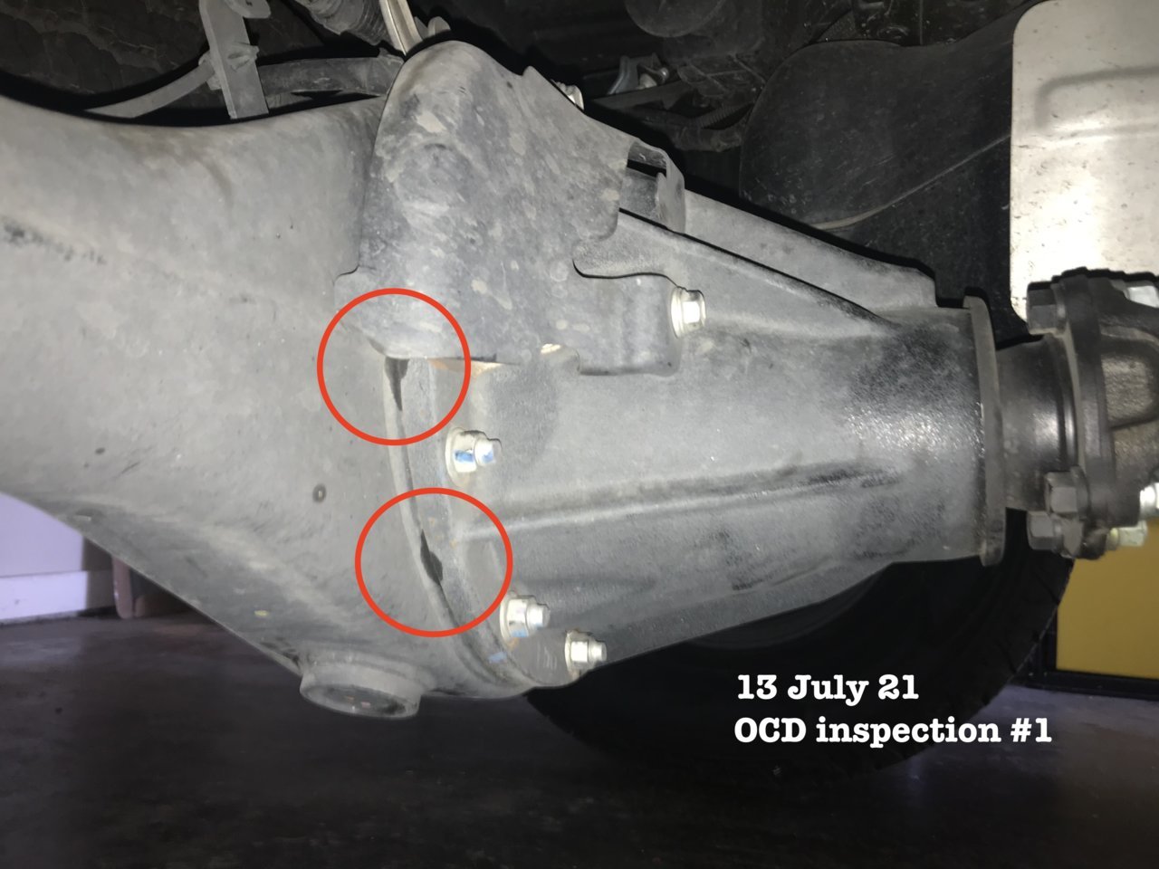

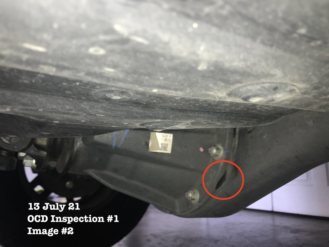

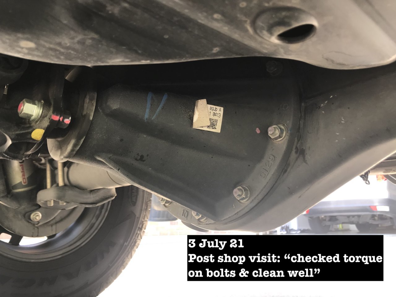

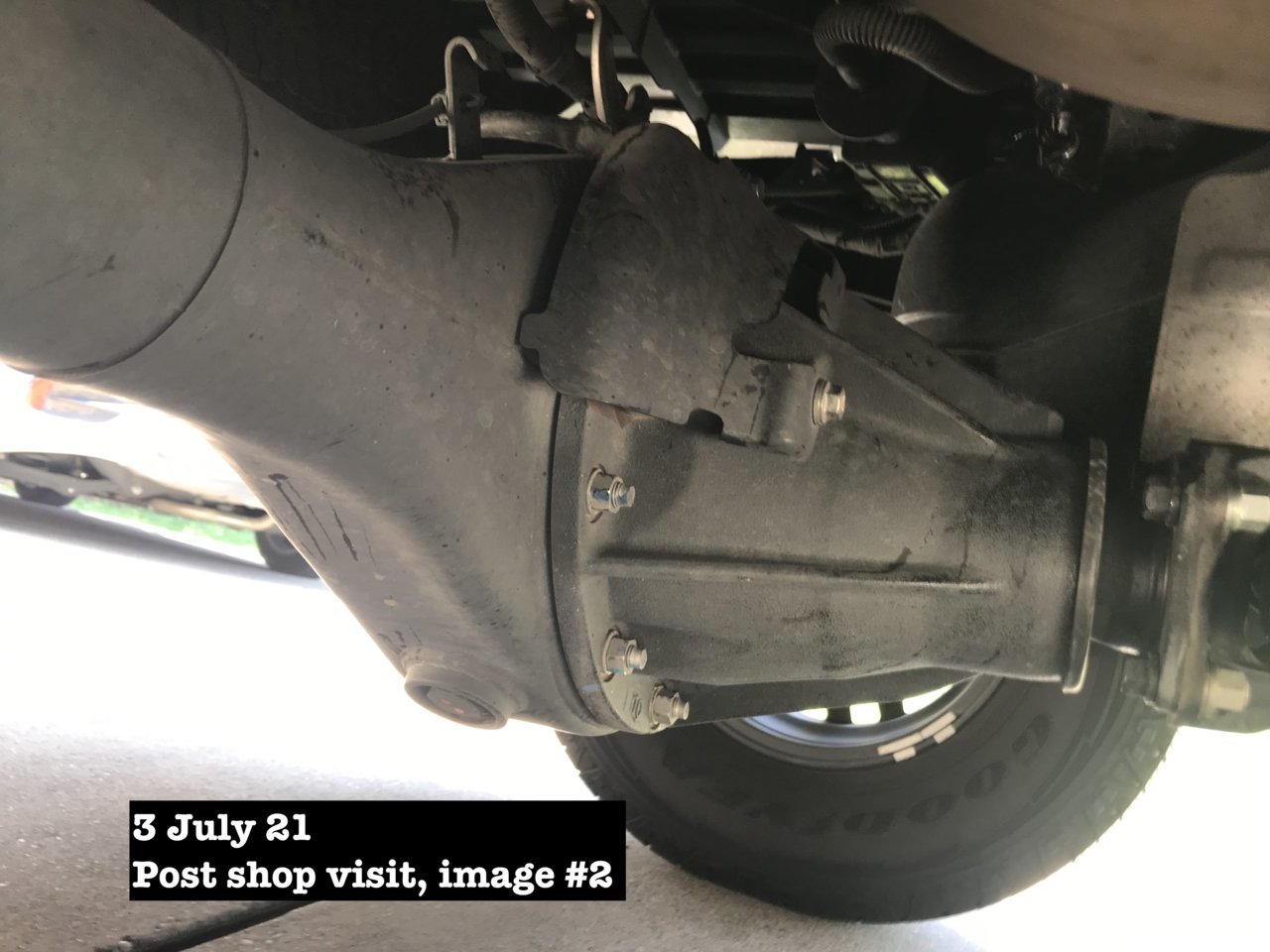

  19. Jul 15, 2021 at 3:08 AM
    #39
    AgR&DTaco
    AgR&DTaco [OP] Ag Research
    Nov 30, 2020
    #348260
    145
    Arthur
    Louisiana
    2021 M̶G̶M̶ ̶S̶R̶5̶ MBM TRD Preaux
    Update: 15 July 21
    After the 2nd dealer visit, following dealer "consultation" with Toyota, it was determined that it was "normal"
    They checked the torque and cleaned up.
    The "seep" is back. Miles=10,309 (2021 TRD Pro) IMG_5562.jpgIMG_5564.jpg IMG_5610.jpgIMG_5611.jpg
