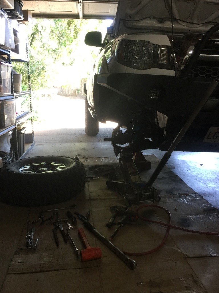

    like mine..........................
    96178F41-CD87-42FA-B5FA-8EC95ED0D909_zps_09247c758306c05b5b698084e10f8f45d8000e04.jpg
    totally kidding though, was working on the front end......I did have to adjust my drivers side King way more than passenger side to keep her level.
    54DCAEE2-CC21-453B-B008-26481D836B81_zps_271da5bf78b5de4f26465e3649d3b56b7990084e.jpg

    Lol. That's some serious lean. My truck was level on stock suspension and now has a lean after installing dakars, even with the included spacer on the ome shock on the driver side. I've since added an additional 1/4" spacer and it still leans a little, so I'm just gonna learn to live with it.

    Silly me I always thought bro lean was in reference to having squat in the back, not the same as the common taco lean that exists on the drivers side. I need to update my tacoma dictionary.
    My taco lean was so bad after I lifted it that my driver side coilover preload is basically twice the passenger side just to get it to sit level

    Did it myself, kind of a pain for what it is but after removing wheel pop the bolt out of the bottom of the shock and remove the three nuts on top of the shock, pop the two bottom bolts on the spindle, and leverage something like a pry bar on the lower control arm so your shock drops out enough to slide the spacer on top, then bolt it back up.
