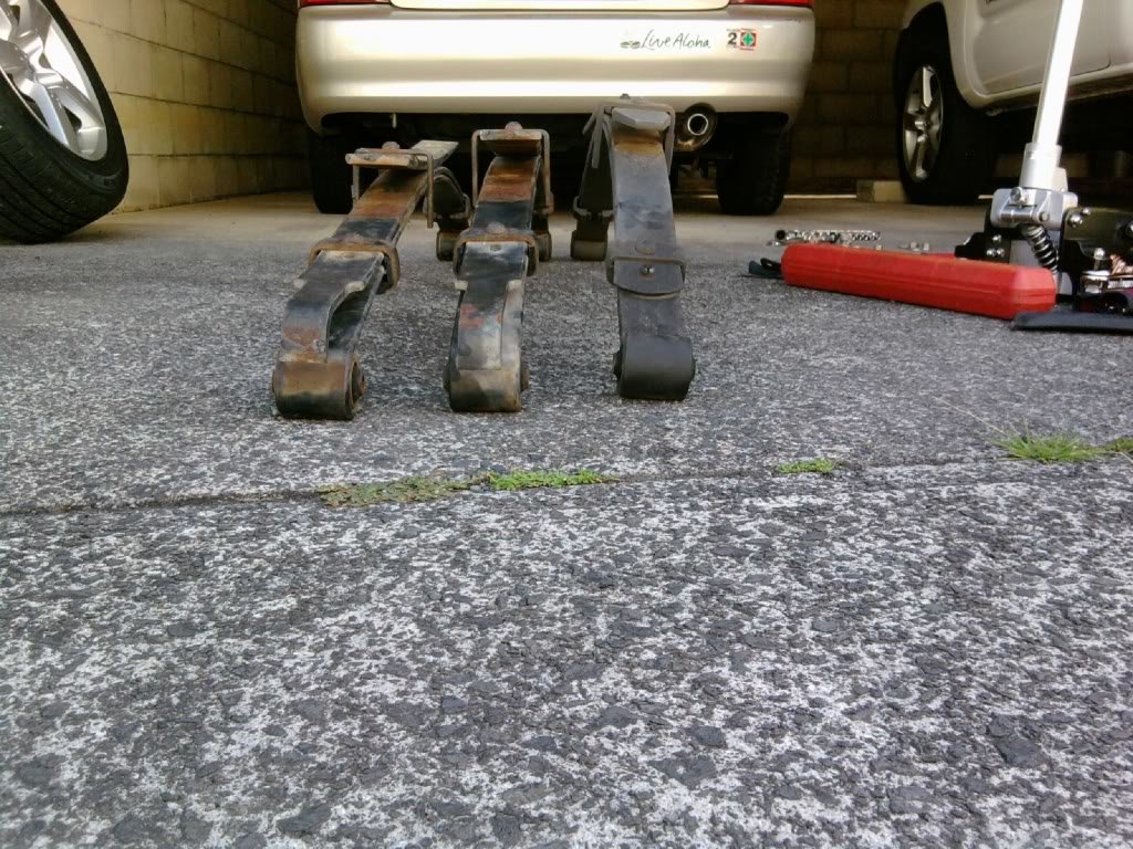

    the tacoma's are designed with this problem in mind, as the leaf springs on the left side have a slightly higher arch than the ones on the right.
    6 Lug leaf packs:
    the left spring is in the middle, right spring is on the left. the third spring to your right is a stock 5-lug leaf with a greater arch than the 6 lug leafs.
    the front coils springs are also side specific, with the left side slightly taller then the right.
    taco lean is completley normal, and it does vary truck by truck. Toyota's aren't the only ones affected by this problem, chevy coloroado's and the canyons have this problem as well, it's just a simple fact that when you, the battery and the gas tank sit on one side, that side is not going to be level with the other.
