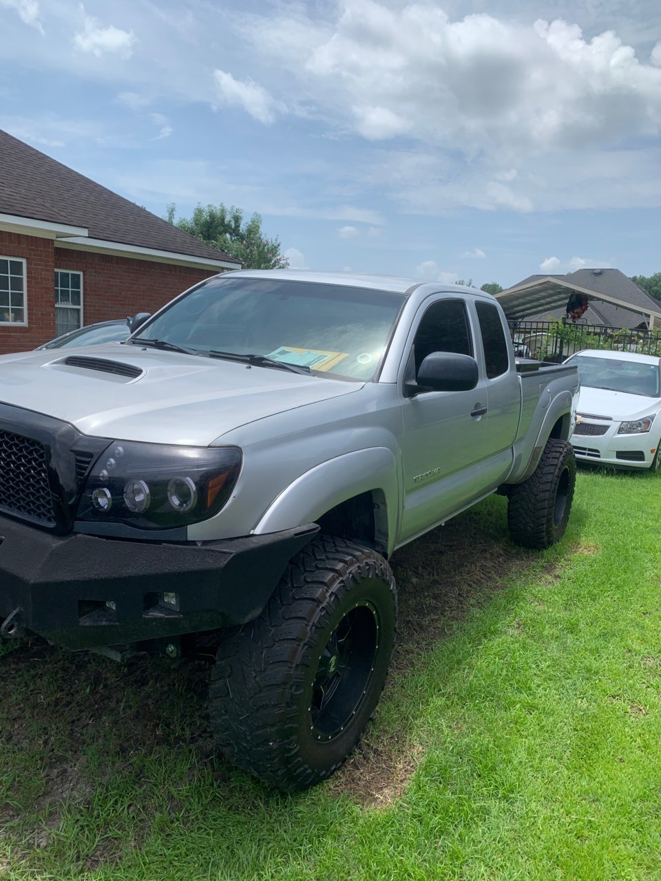

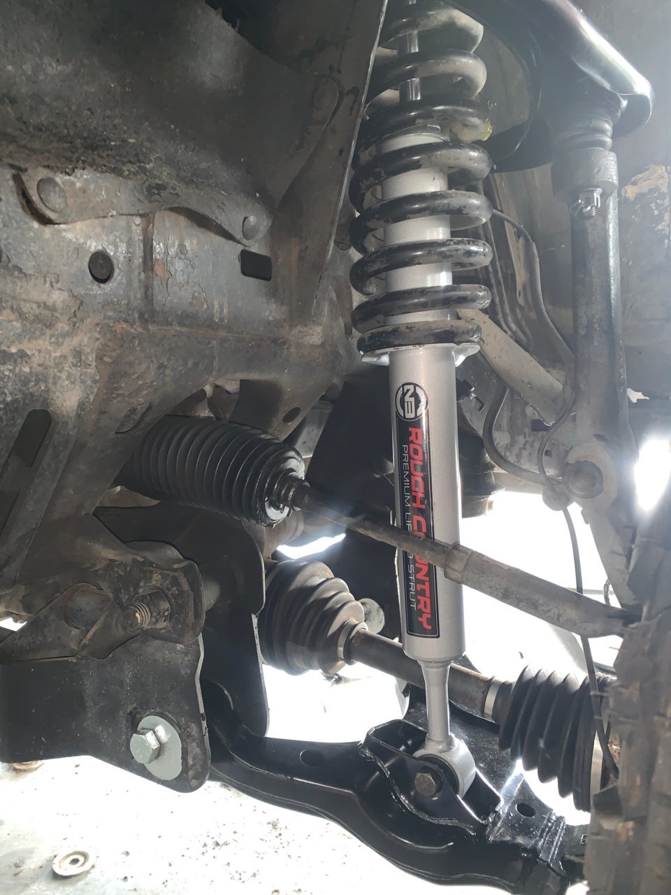

    While I’ve been on deployment my Dad and Brother were gracious enough to do some work on the truck. They replaced UCA’s, LCA’s, and struts/ shocks as far as suspension goes.

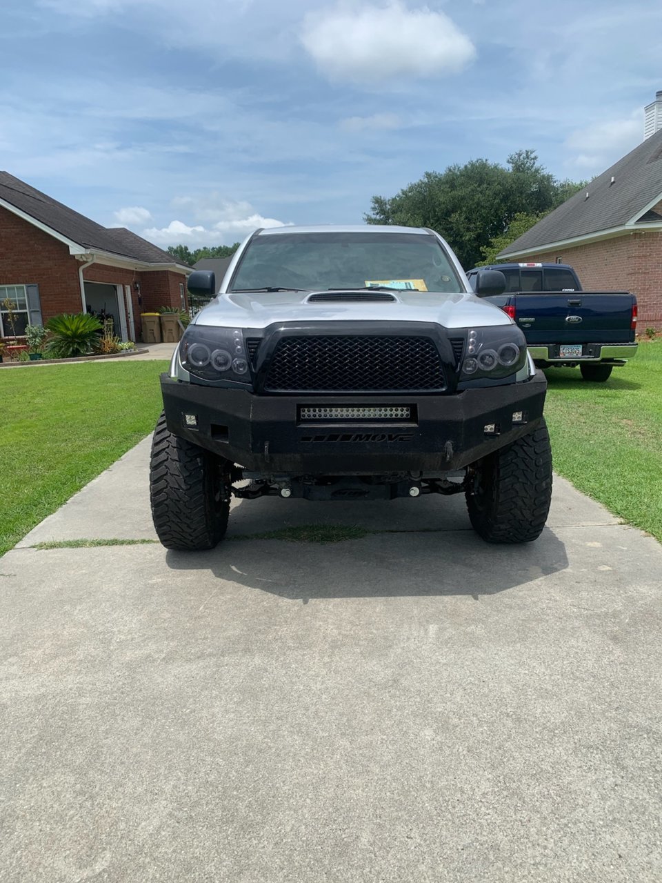

    I previously had a 3 inch lift with an additional spacer (I know trust me) in the front. After the install the truck has a significantly higher amount of lean on the driver side than it did before, as well as being lower in the front that it was originally. I can’t get exact number as I’m still not home, just trying to get some information as to what I should do about it upon return. From what I know the only options are to completely replace with adjusts coil overs and adjustable as needed, or put a spacer on the right side to compensate. Thanks
    Struts: rough country 6 inch lifted strut
    Coils: stock from previous struts
    LCA/UCA: oem

    Update on measurements:
    Front driver: 40
    Front passenger: 42
    Rear driver: 40
    Rear passenger: 42
    2 inches seems like a bit much for typical Tacoma lean. Any ideas on what could be the cause?

    Also, because of the bumper up front would it be a good idea to upgrade to a 700# spring to help lift the front end back up? Someone out there has to have done this. The stock springs could have too much weight on them causing the front end sag.
