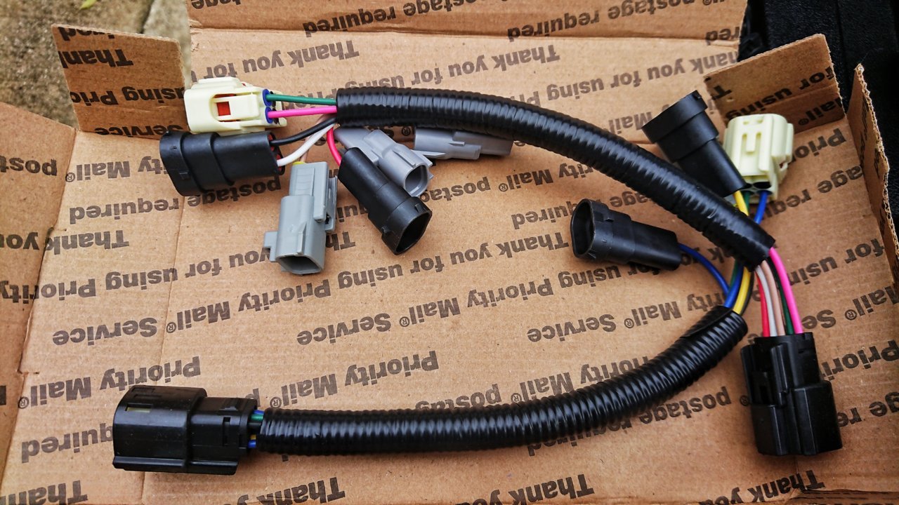

    Hey guys so I’m kinda stuck right now as to what the problem is with my new 2020 trd pro headlights. So I just got them from Toyota and I bought a wiring harness from the retro fit source(TRS) and today when I went to install them I got the left side all plugged in and went to test and it worked fine. Then I went and put the right headlight on and went to test it only my day time running lights work on both sides. I tried unplugging everything and replugging but that didn’t work. I was thinking I burnt out a fuse when I tested the left side but I went and replaced the fuses and still no luck. I haven’t found any similar problems on here but I thought it was worth a shot. Thanks

    I heard that the TRS harnesses have had issues and if you call them they are asking to have them returned and will refund you.

    Oh really they didn’t let me know that. I contacted them and they said it was odd but they just said they’ll send me a new one to see if it was just a faulty product. But I found it weird because it was working at first

    I had a buddy who bought them and had them returned. He contacted their customer service and they paid to have them returned and refunded his money. He said that Tech support mentioned some were faulty and so they've been taking them back...they told him they weren't going to have good working ones for about three months (he bought and returned them late Aug/early Sept).

    My buddy had his fuses blown with the TRS harness also....afterwards he bought the ones from Mike and he's back in action! Mike's stuff is good quality

    Update. Mikes conversion kit worked flawlessly :muscleflexing:

    You will need a harness, @xrunnerdude67 makes them. His version is the best one, color coded and easy PnP.
    Becareful of TRS's harness, a lot of people have reported that their harness are blowing fuses. According to a couple members, it is due to wires being switched around, so if you go that route, you may want to trace the wires as a precaution.

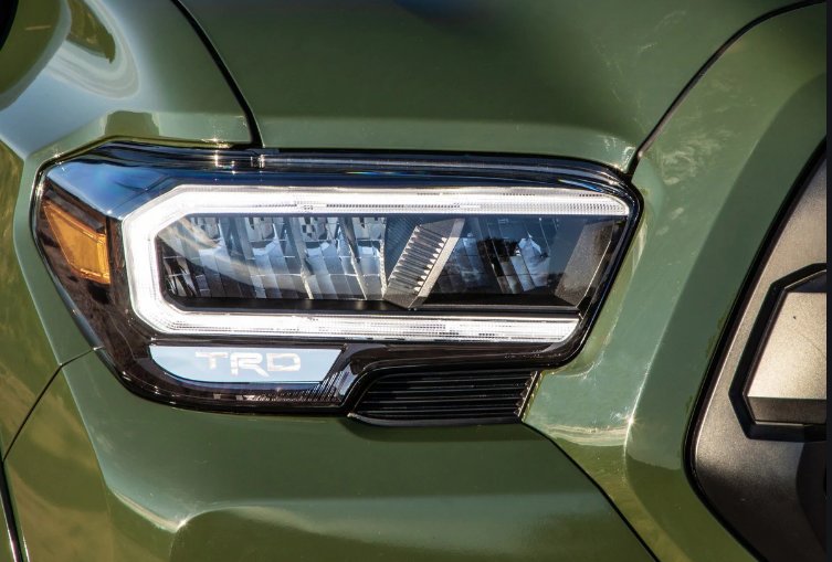

    #20
    ktbell444
    ktbell444 One who throws exceptions
    Aug 8, 2017
    #226306
    2,969
    ᚺᛖᛚᚺᛖᛁᛗ
    Says "TRD" on the passenger side bottom, and "PRO" on the driver side bottom.
    Here's an example:
