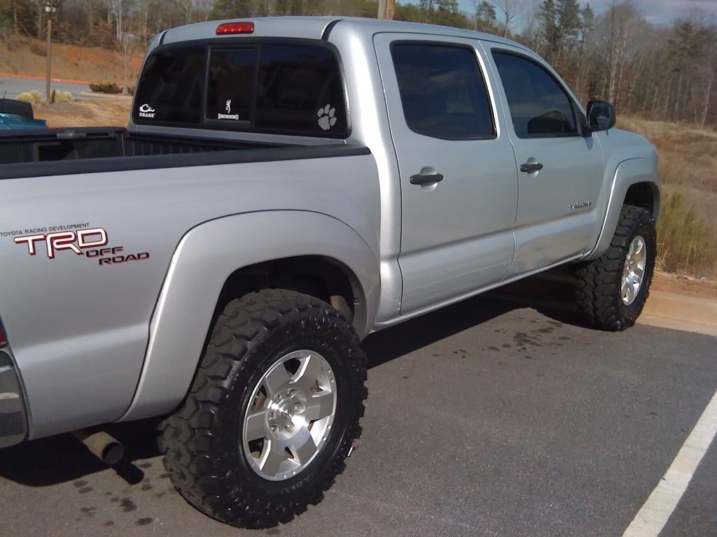

    i have a pre runner with a leveling kit any way i can get more lift in the front without spending 1k on coilovers its 2wd i have 33x12.50x17 super swampers now they dont rub bad but i would like the truck to sit higher any suggestions

    Did you trim the fender well and chop your cab mounts? How big is the leveling kit?

    its a 3 inch leveling kit and i havent done anything but installed the spacers

    Yeah you are definitely going to need to trim and chop...no doubt.
    People need to do that even to fit 11.5's

    And with such an aggressive tire I bet that won't even fix the problem entirely.

    thats a pic of my silver tacoma with the swampers i have had no prob with the tires rubbing yet i live on a farm and drive alot off road i know i cant get full wheel travel and flex but mainly for cosmetic reasons just wanting to lift it a lil more in the front without spending 1k on coilovers

    There no way to lift the front over 3" without spindles, a drop bracket, or SAS. All of which are $1000+
