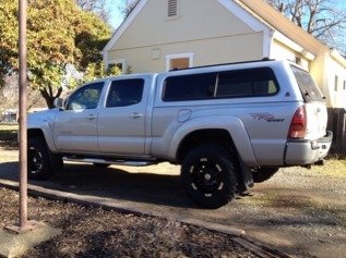

    Ok this thread is awesome but I have a question. I recently lifted my 05 dbl cab lb 4x4 with a lift I got on cl. It had a 1.5 or 2" rear block with new u bolts and the front came with the factory Trd sport coil overs with a spring spacer/top plate combo. I love the look, and the back ride is just like stock but the front ride is stiff. I'm not a big fan of the stiff ride up front. Is there something I can do about that? Will the bilstein 5100's offer softer ride or about the same as what I got? I would love to have the soft ride of stock with 2,5" of lift. Thanks for your answers.

    Put the spacer top plate on your original coil overs, that should get your original ride feel back. That's the cheapest way at this point. Another option is to replace your original shock with a 5100 set for max. height. Others on here would have to say whether a 5100 is a stiffer ride. Mine felt stiffer but I changed the spring along with the 5100.

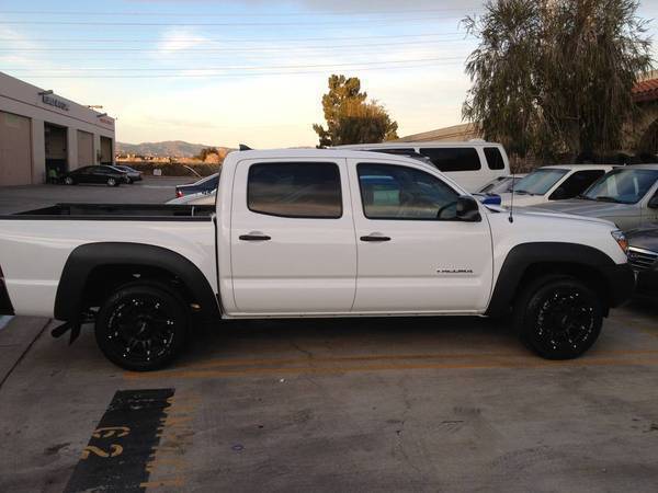

    Well, I believe I have found the right combo for a stock smooth ride with close to a 3" level lift :) I have a 2" block in the rear which doesn't change the ride at all and what I did with the front is go with the 5100's set at the 1.85" setting with an 1" top plate spacer. I got this all set-up today and man, it rides nice and smooth with no issues. Be sure to extend the abs line though as we got it all done and the abs light was on so we ended up putting about a 5" section of wire on each side. Other than that it is all good and I couldn't be happier. Thought I would share.

    5100s on all four, front set to 1.75", rear 1" block (no aal...don't want stiffer ride), 275/70/17 tire. what kind of stance does this give me over the stock? looking for my ride to be level but with about a 2" lift overall. have 06 prerunner trd sport, non tsb.
