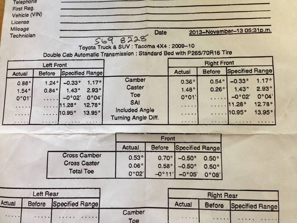

    So...with my 5100s set at 0 with 887 coils I netted a full 3" front lift measured from hub to fender, AND my alignment was in spec (I will provide numbers later- currently don't have them with me)! No need for UCA at this time. Amazing. The ride is way nicer than stock, my truck soaks up the ruts/bumps/woops out on the dirt. Anyone considering 885s that had sliders and want more of a 3" lift may consider this route. It was what Yota Dan recommended and I love the look and the ride of my new lift! It did rub the front mini flap thingy at full turn so I removed it but otherwise no rubbing at all. Haven't measured the rears yet, but the 1.5" Wheelers HD AAL set makes it look level. You should have seen my face when I initially measured after installing the lift- I had netted about 4" and I freaked. But once I drove it around and took it off road on a mild fire road, it settled nicely. So....maybe 887s will be a new trend?

    Here are the alignment specs done at a local tire shop with a "brand new machine". Seems almost too good to be true…Am I crazy?:confused: Or did I give up the toe to get the camber in spec?
