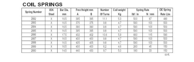

    Jalisco, Mexico
    05 AC 4x4 2.7 5spd
    OME 883/Nitros
    Regarding the front.
    If your running an OME setup, you should consider switching to 887 springs (for a 3" lift).
    Taller springs would be a better setup, over a spacer.
    Also, you might have noticed that you're alignment adjustments are pretty much maxed out.
    Replacement UCAs will provide additional caster, which even a shorter 2" lift would appreciate :)
