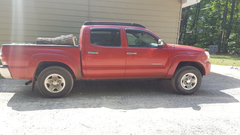

    So I've been reading and looking for a few months now and I'm the type that reads till my eyes bleed, So I'm just going to ask what I need for what I do with my truck. I have a '13 SR5 4x4 DCSB, I'm looking to fit 285/55R16 or 17's(still need help deciding, Steel or Alloy). I use my truck for a truck(Yes no mall cruising!) I haul and load my bed all the time so what would be my best option for a good lift that wont break me completely but is still a reliable kit. This was the other day with 800lb in the bed, yes I have sumosprings already installed.
