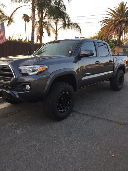

    Alright guys, I hate to be "that guy" but I have a few questions.
    YES I have read a shit ton of lift/suspension/shock threads but I've read so much that information is starting to get muddy in my head.
    I currently have a 2016 DCSB SR5 4x2 with 5100's up front at 3rd notch and love the ride and stance. Stock coils and obviously stock UCA's. Rear is also stock.
    I'm kinda over the "bro lean" my taco has and I want to lift my rear a bit... maybe 1"-1.5" so it's lifted but level.
    I'm thinking of doing 5100's in the rear along with either an AAL or the whole leaf pack... which do you recommend and what brand? I've heard a few people on here say that a single AAL gives the truck a "intolerable ride".
    I know people usually don't recommend 1" blocks?
    As far as the front, now I'm thinking of changing that up and adding OME coils and setting my 5100's @ 0... thoughts?
    what's the benefit of doing 5100's @ 0 with Coils doing the lifting rather than the 5100's @ 3rd notch and stock coils?
    Again I know this has been gone over 1000+ times but everything is so spread out and everyone has their own opinion and information gets muddy after a while.
    Thanks in advance and I hope someone isn't tired of repeating themselves and can share some info with me!

    well if you're thinking of setting your front 5100's to 0 and getting coils that would probably make your front 5100's last longer. Depending on what your needs are and your future plans for the truck will determine your set up. @HeadStrong Off-Road have a good reference for which coils will suit your needs for your 3rd gen.
    http://www.headstrongoffroad.com/st..._-_Various_Lift_Heights_Available_(PAIR).html
    What seems to be the norm if you're not going for a crazy set up but a reliable set up would be...
    http://www.headstrongoffroad.com/store/p401/Coil/Bilstein_5100_Kit_(HS16BK-1).html
    UCA's are suggested for 2.5 and above.
    you can go with a full leaf pack replacement which will give you 2.5 - up lift for the rear or single AAL or progressive AAL. Just like my suggestion to TexasTaco31, hit up Marie from HS Offroad or check out other participating vendors in the forum. They'll help you out.
